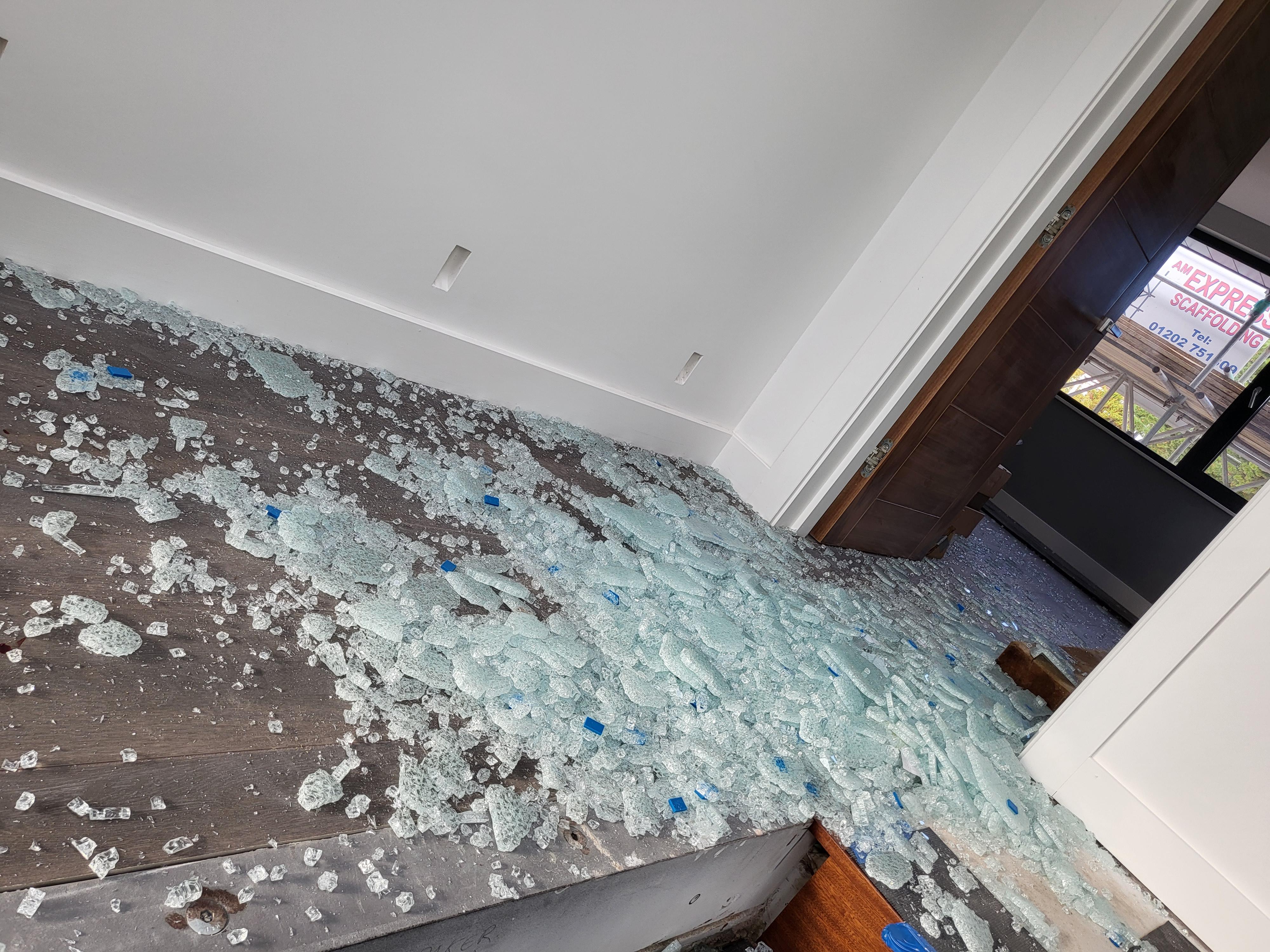

Adam2 Posted October 13, 2022 Posted October 13, 2022 Anyone else had a huge piece of glass explode on them? Today had a 2mx2m x10mm toughened piece shatter while 4 of us were carrying it. Only minor cuts but could have been a lot worse. I think all in a state of shock after. Made a right mess of the floor. How could this happen? 1
HughF Posted October 13, 2022 Posted October 13, 2022 Ouch! That's a scary moment. My experience with toughened is that a small point impact will set it off (think automatic centre punch vs car side window) but I can't think of what else would set it off. I tend to always specify laminated and toughened for my sealed units now, (I know this isn't one) as it seems worth it for peace of mind. On the plus side, I'm sure a trip to Dorset Glass on the nuffield will have it sorted out.

jack Posted October 14, 2022 Posted October 14, 2022 When I was getting the glass for our balconies, one or two places offered an additional "heat soak" treated toughened glass. They put it through a process that essentially accelerates the impact that inclusions have. It's destructive, so the additional cost of heat-soaked glass reflects both the additional process cost and the average loss rate.
Bonner Posted October 14, 2022 Posted October 14, 2022 23 minutes ago, jack said: When I was getting the glass for our balconies, one or two places offered an additional "heat soak" treated toughened glass. They put it through a process that essentially accelerates the impact that inclusions have. It's destructive, so the additional cost of heat-soaked glass reflects both the additional process cost and the average loss rate. Was that laminated as well as toughened ? Otherwise toughened alone doesn’t offer any protection from falling when it goes
jack Posted October 14, 2022 Posted October 14, 2022 1 hour ago, Bonner said: Was that laminated as well as toughened ? Otherwise toughened alone doesn’t offer any protection from falling when it goes I got laminated and toughened for that very reason. That said, I don't believe building regs required laminated, at least for residential properties. Might be wrong about that, but either way, laminated makes a lot of sense.
Adam2 Posted October 14, 2022 Author Posted October 14, 2022 33 minutes ago, Radian said: I was expecting something much worse! OK well, I'm glad I couldn't meet your expectations on this occasion 🙂 We've had our fair share of dramas along the way. Will request that the replacement is heat soaked and will get the supplier to install as well as my tilers are understandably not excited by the prospect of doing this again! Next time we'll design out any ideas of a 2m x 2m shower screen
Carrerahill Posted October 14, 2022 Posted October 14, 2022 (edited) 13 hours ago, Adam2 said: Anyone else had a huge piece of glass explode on them? Today had a 2mx2m x10mm toughened piece shatter while 4 of us were carrying it. Only minor cuts but could have been a lot worse. I think all in a state of shock after. Made a right mess of the floor. How could this happen? I would parrot what has been said before and go with an inclusion in the glass, assuming you in fact did not hit anything. I had a glazed partition panel in my office break once, I was sitting in the office, only person in the office, when suddenly it just made a funny cracking noise and I looked up and the whole panel had shattered but still stood in place. It was the oddest thing. As you can imagine I was somewhat perplexed and with engineers hat on started to work out what happened. I noted the cracking appears to have a start point, which was the bottom of the panel about 150mm up from the bottom. The cracking fully radiated out from this point. I called the glazier the next morning who told me it would be an inclusion in the glass and it sometimes happened with toughened glass where a little defect is included in the glass which acts as a weak point. So if you were nowhere near anything when it broke, chances are an inclusion in the glass (debris/air) could have been flexed slightly and the molecular structure of the glass just lets go and twooshh! Hope your floor was not damaged. I found cleaning toughened up off a wooden floor is a very difficult process as you need to lift every piece up with a vacuum to stop scratching, but it fills a vacuum in no time! It is amazing the abuse toughened will take. I deconstructed a sun room when we were doing the extension and I took the 3.2m x 0.6m roof sections out, I was not too careful with them, and at some points they were bowed like a humpback bridge! In the end I broke them all up and made oversite concrete with them - I threw a concrete block down on top of them, it bounced off! I ended up going down and hitting the sides with a hammer which broke each one as a side impact will break it every time. Edited October 14, 2022 by Carrerahill

craig Posted October 15, 2022 Posted October 15, 2022 On 14/10/2022 at 09:11, jack said: "heat soak" treated toughened glass. They put it through a process that essentially accelerates the impact that inclusions have. With our Austrian supplier, at a certain glass size it is automatically recommended. If it fails due to nickel sulphide inclusions. It’s tough luck, buy a new one. I’m at the stage now that heat soak on toughened, is standard on all sizes. 1
