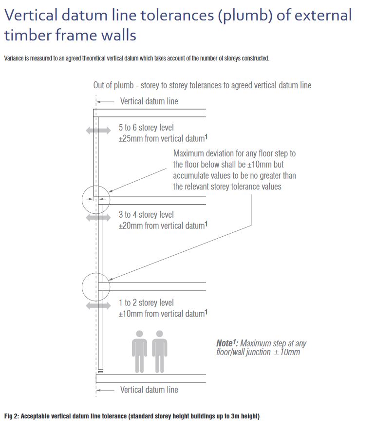

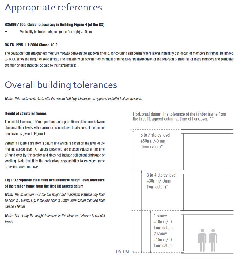

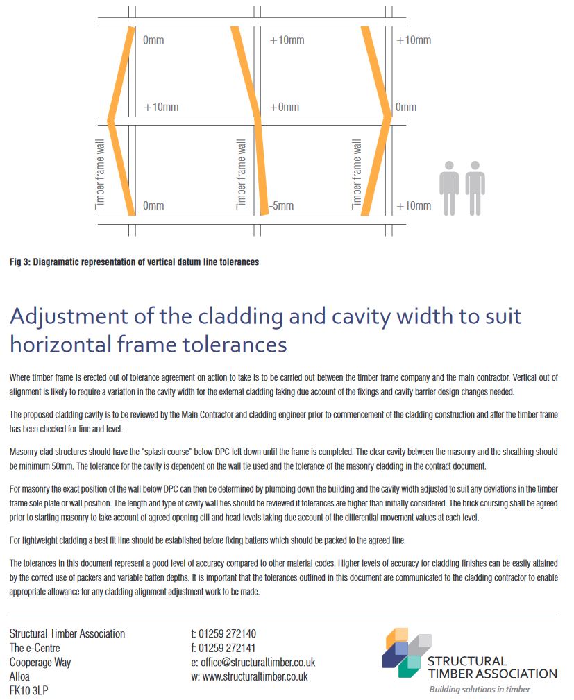

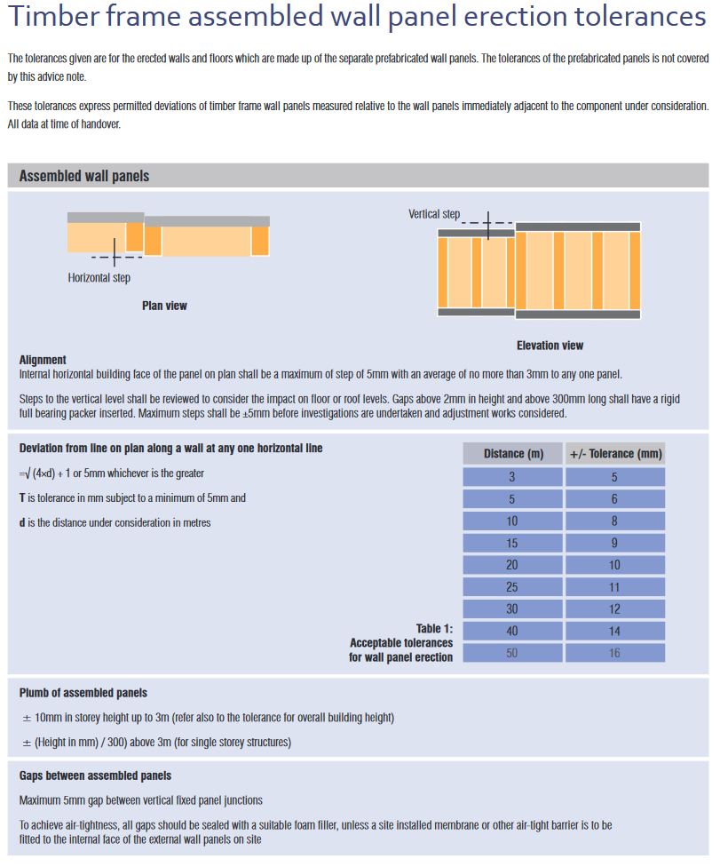

Ian Posted June 21, 2017 Posted June 21, 2017 10 minutes ago, Barney12 said: Well the MD and Brendan are getting in the car and driving down to site tonight. So I'd say that's pretty impressive so far! I do actually have some confidence it will get sorted, you don't gain a good reputation (especially in the online bear pit of forums) for nothing! That sounds hopeful. MBC have accreditation with the Structural Timber Association. Just in case it's of any use in your conversation with MBC here's the tolerances for timber frames published by the STA. Let me know if you need the document sent to you by DM. 2
MikeSharp01 Posted June 21, 2017 Posted June 21, 2017 @Ian that is a very insightful document. But even it admits that a verticle one end of the build can be 10mm out and if it is 10mm out the other end you can have 20mm out of square if you then add a similar error in the z plane it gets worse if the base line is similarly out, IE the verticle line starting point, the error is now 40mm or have I miss read it.
