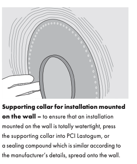

Thorfun Posted October 27, 2023 Author Posted October 27, 2023 as i finish up my iBox installs in preparation for the tiler next week i need to install the waterproof part that comes with them. according to the manual i need to fix with PCI Lastogum or sealing compound which is similar. can anyone tell me what is the best product to use for this part please?
Thorfun Posted October 27, 2023 Author Posted October 27, 2023 ok. I can see it is a thing https://wetroomsdesign.co.uk/liquid-coating-pci-lastogum-4-kg-grey but at £60 for a 4kg tub it seems excessive when I only have 3 iBox surrounds to do! is there another product that will do the same job but cheaper or in a smaller container?

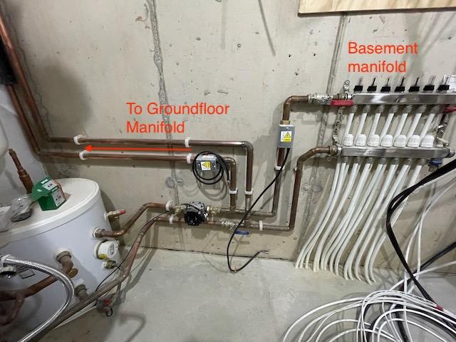

Thorfun Posted November 12, 2023 Author Posted November 12, 2023 need help with my ufh system control. it's going to be a while before I can get Loxone up and running and integrated. so, for now, I want to run the ufh from 2 x wifi thermostats. one in the basement and one on the ground floor. these thermostats will need to communicate with something to open up the valves and call the ASHP for heat. we have an Ecodan ASHP and UVC with the FTC6 controller. here's a photo of the motorised valves. what do I need to get this working please? what parts do I need to buy? and is putting it together DIY-able?
Pocster Posted November 12, 2023 Posted November 12, 2023 (edited) 1 hour ago, Thorfun said: need help with my ufh system control. it's going to be a while before I can get Loxone up and running and integrated. so, for now, I want to run the ufh from 2 x wifi thermostats. one in the basement and one on the ground floor. these thermostats will need to communicate with something to open up the valves and call the ASHP for heat. we have an Ecodan ASHP and UVC with the FTC6 controller. here's a photo of the motorised valves. what do I need to get this working please? what parts do I need to buy? and is putting it together DIY-able? Motorised actuators . ( salus ) Simple control box for them ( heat miser ) . WiFi type relays hooked into that . You can then easily add to whatever HA you need later Or ignore 😊 Edited November 12, 2023 by Pocster
Thorfun Posted November 12, 2023 Author Posted November 12, 2023 Just now, Pocster said: Motorised actuators . ( salus ) Simple control box for them ( heat miser ) . WiFi type relays hooked into that . You can then easily add to whatever HA you need later I don't want to control zones though within a manifold so my actuators will be on all the time. I want to control the motorised valves and turn the ASHP on when the thermostat says so.
Pocster Posted November 12, 2023 Posted November 12, 2023 1 minute ago, Thorfun said: I don't want to control zones though within a manifold so my actuators will be on all the time. I want to control the motorised valves and turn the ASHP on when the thermostat says so. Hmmmm Mines like the other way round . Actuator opens which turns on pump which inturn requests ASHP if needed .
Pocster Posted November 12, 2023 Posted November 12, 2023 (edited) Just the manifold pump request then ? Edited November 12, 2023 by Pocster
Thorfun Posted November 12, 2023 Author Posted November 12, 2023 Just now, Pocster said: Hmmmm Mines like the other way round . Actuator opens which turns on pump which inturn requests ASHP if needed . do you have multiple zones then? if running as a single zone isn't paying for motorised actuators on each loop on the manifold expensive and unnecessary?
Thorfun Posted November 12, 2023 Author Posted November 12, 2023 Just now, Pocster said: Jump the manifold pump request then ? so, afaik, it'll be like this. thermostat on one or both of the floors requests heat. something receives that and tells the ASHP to startup and produce hot water for the domestic heating. in turn the pump for the ufh needs to be turned on and the relevant motorised valve opened to allow water to go to that floors manifold. All the actuators on each floor's manifold is permanently open so the opening of the motorised valve allows the water to flow through the ufh pipes. make sense?
Pocster Posted November 12, 2023 Posted November 12, 2023 (edited) 3 minutes ago, Thorfun said: so, afaik, it'll be like this. thermostat on one or both of the floors requests heat. something receives that and tells the ASHP to startup and produce hot water for the domestic heating. in turn the pump for the ufh needs to be turned on and the relevant motorised valve opened to allow water to go to that floors manifold. All the actuators on each floor's manifold is permanently open so the opening of the motorised valve allows the water to flow through the ufh pipes. make sense? Yeah - got you . My ASHP operates ( when it needs ) rather than I control it . ufh ( via uvc and ASHP ) it is determined by flow I.e when relevant pump is on for which ever manifold . So I don’t control ASHP directly - all off the ufh pump to effectively operate uvc / ASHP . Edited November 12, 2023 by Pocster
ProDave Posted November 12, 2023 Posted November 12, 2023 So you have one motorised valve per manifold but only ONE pump that serves both manifolds. That complicates the issue. What is the call for heat input on the FTC6? Does it have to be a volt free contact or will it accept a switched 240v ac input? The logic is: Basement thermostat energises basement motorised valve when it wants heat. Ground floor thermostat energised ground floor motorised valve when it wants heat. The feedback contacts (orange and grey wires) from both motorised valves connect in parallel and will turn on the pump when either floor is calling for heat. Where it will get complicated if the FTC6 insists on a volt free contact you will have to use a relay.
Thorfun Posted November 12, 2023 Author Posted November 12, 2023 3 minutes ago, Pocster said: Yeah - got you . My ASHP operates ( when it needs ) rather than I control it . ufh ( via uvc and ASHP ) it is determined by flow I.e when relevant pump is on for which ever manifold . So I don’t control ASHP directly - all off the ufh pump to effectively operate uvc / ASHP . interesting. I have noticed that when I manually turn on the heating the pump is one of the first things to come on so maybe my system is similar and I actually need something to turn on the pump and open the valves?
Pocster Posted November 12, 2023 Posted November 12, 2023 1 minute ago, Thorfun said: interesting. I have noticed that when I manually turn on the heating the pump is one of the first things to come on so maybe my system is similar and I actually need something to turn on the pump and open the valves? That’s what I would think . But your system is undoubtedly different setup to mine .
