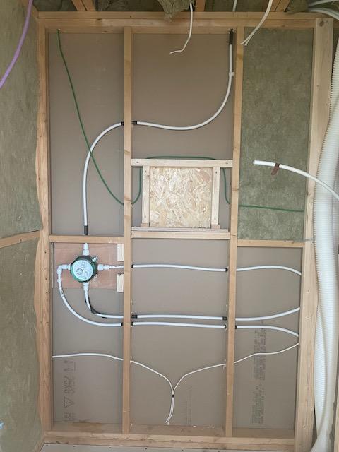

Thorfun Posted September 25, 2023 Author Share Posted September 25, 2023 greetings! I need to plumb in the showers next. we have Hansgrohe iBox with shower select 2 plates feeding a shower hose and a ceiling drencher head. the same setup in 3 showers. my question is around copper or hep2o. most of the pictures of peoples installations done by 'proper' plumbers based in the UK are copper from the iBox to the shower outlets. is there a reason this can't be done is hep2o? or, I guess the better question is, what is the benefit of using copper? or would it be a case of 'we've always done it that way'? if copper from the iBox to the shower outlets is best can I use push fit copper fittings? I'm not sure I want to start learning how to solder copper this far in to my plumbing journey! Link to comment Share on other sites More sharing options...
Pocster Posted September 25, 2023 Share Posted September 25, 2023 9 minutes ago, Thorfun said: most of the pictures of peoples installations done by 'proper' plumbers Nasty ! 1 Link to comment Share on other sites More sharing options...
markocosic Posted September 25, 2023 Share Posted September 25, 2023 6 hours ago, Thorfun said: most of the pictures of peoples installations done by 'proper' plumbers based in the UK are copper from the iBox to the shower outlets Compact compared with plastic fittings when burying it in walls/hiding behind tiles etc Rigid so holds the fittings in place when you're screwing stuff into them End feed copper is fun and makes it look difficult? Link to comment Share on other sites More sharing options...
Thorfun Posted September 26, 2023 Author Share Posted September 26, 2023 8 hours ago, markocosic said: End feed copper is fun and makes it look difficult? Is it not difficult then? Surely the risk of leaking is high for a novice and push fit copper is safer and quicker! Albeit more expensive. But when you take the time to do the soldering in to consideration the money saved on labour balances out the cost of the pushfit fittings? Link to comment Share on other sites More sharing options...
Pocster Posted September 26, 2023 Share Posted September 26, 2023 1 hour ago, Thorfun said: Is it not difficult then? Surely the risk of leaking is high for a novice and push fit copper is safer and quicker! Albeit more expensive. But when you take the time to do the soldering in to consideration the money saved on labour balances out the cost of the pushfit fittings? All complete nonsense ! . Hep2o is the designated choice for plumbers and non plumbers . Real plumbers don’t like it because it makes them obsolete !! . Stop stalling ! - do some work 😎 Link to comment Share on other sites More sharing options...
Thorfun Posted September 26, 2023 Author Share Posted September 26, 2023 2 hours ago, Pocster said: All complete nonsense ! . Hep2o is the designated choice for plumbers and non plumbers . Real plumbers don’t like it because it makes them obsolete !! . Stop stalling ! - do some work 😎 sadly Covid has got in the way of me doing any work. so I'm researching stuff at the moment. Link to comment Share on other sites More sharing options...
Thorfun Posted October 8, 2023 Author Share Posted October 8, 2023 I fitted one iBox with hep2o and was very joyous when I tested it and it looked dry! sadly that didn't last and I found a small weeping leak. this is due to the fact that my adjustable wrench is rather fat and so I couldn't tighten it any further. so I have ordered a slim adjustable wrench which will allow me to tighten all the connections up. still, thought I'd post a photo of how it looks anyway. 3 Link to comment Share on other sites More sharing options...

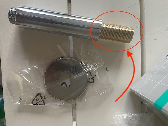

Thorfun Posted October 8, 2023 Author Share Posted October 8, 2023 I also have a question. our rainfall heads are ceiling mounted. I have a threaded bolt type thing that the mounting pipe attaches to. what do I need to put in the ceiling to attach that threaded bolt to? Link to comment Share on other sites More sharing options...
joe90 Posted October 8, 2023 Share Posted October 8, 2023 (edited) No nut? (Ply behind plasterboard) and is it a flat end or tapered you connect the pipe too 🤷♂️ Edited October 8, 2023 by joe90 Link to comment Share on other sites More sharing options...
Onoff Posted October 8, 2023 Share Posted October 8, 2023 (edited) How I did mine: Above I folded a stainless steel door plate and screwed to two joists. Then there's a nylon washer, a thick brass washer, then a BSP nut. Edited October 8, 2023 by Onoff Link to comment Share on other sites More sharing options...
Thorfun Posted October 8, 2023 Author Share Posted October 8, 2023 54 minutes ago, joe90 said: No nut? (Ply behind plasterboard) and is it a flat end or tapered you connect the pipe too 🤷♂️ that's all I've got! I've not put any plasterboard up yet so can put whatever noggins are required. I can take a photo of the end of it tomorrow to see what the end is but I think it's tapered like the one I posted in my other thread about the hep2o tap connector. Link to comment Share on other sites More sharing options...
Thorfun Posted October 8, 2023 Author Share Posted October 8, 2023 38 minutes ago, Onoff said: How I did mine: Above I folded a stainless steel door plate and screwed to two joists. Then there's a nylon washer, a thick brass washer, then a BSP nut. blimey that seems complicated! I was hoping to pop to the plumbing shop and just buy something off the shelf and screw it to a piece of wood! Link to comment Share on other sites More sharing options...
Thorfun Posted October 8, 2023 Author Share Posted October 8, 2023 I think this is what I’m after? but in a Hep2o version https://www.screwfix.com/p/jg-speedfit-plastic-push-fit-adapting-90-wall-plate-elbow-15mm-x-1-2-/17692?ref=SFAppShare Link to comment Share on other sites More sharing options...
Thorfun Posted October 8, 2023 Author Share Posted October 8, 2023 Seems like the Hep2o version is plastic. https://www.screwfix.com/p/hep2o-plastic-push-fit-adapting-90-wall-plate-elbow-15mm-x-1-2-/2279f?ref=SFAppShare seems pretty strange that. I can convert to copper and get a compression version though I guess. Link to comment Share on other sites More sharing options...
