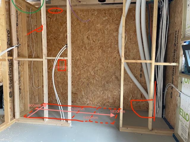

hello lovely people (and @pocster). I have another question about the layout of our master en-suite shower/toilet area mostly related to the size of Impey Aqua-dec former.
from the photo above you can see the area in question. in the alcoves behind the stud wall we have the toilet on the right and then on the left is the shower area. the left stud wall comes out to about 1100mm and the area is sized to take a 900mm wide former. we have a shower head on the wall and a drenching shower head above with the controls inside the alcove entrance to allow not getting wet when turning on the shower.
with the entrance to the area serving the toilet and shower what do people think will look best for size of shower tray here? an 1850mm former will almost reach the other side of the entrance. a 1400mm will go 1/3 of the way across and an 1100mm to the end of the shower stud wall. obviously, formers can be cut to any size in between.
worried that an 1850mm former would result in a lip down when stepping in to the shower or might make stepping in to the toilet area awkward? but then worried that an 1100mm tray to the end of the shower stud wall leaving the entrance flat would mean increased water sitting at the entrance as it has nowhere to flow.
opinions please. 🙂
Is there a basin? or is that to the side of the w/c
just wondering if that would have any impact on things
I haven't got as far as thinking about trays and formers yet, but will this be flush with the finished floor, wetroom style?

basins will be on the camera side of the stud walls on the left and a bath on the right. yes, flush with finished floor in a wetroom style. 🙂

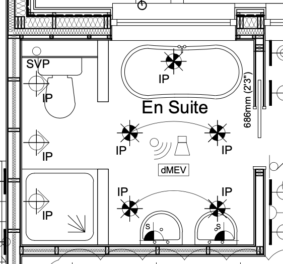

thought it might be best to put a plan view of the en-suite up to show the proposed layout.
dimensions are not accurate as we extended the bathroom 400mm to give more space between shower and toilet.
Have to ask … why the ‘wall’ for the toilet ? . Removing that would make the room feel bigger .
