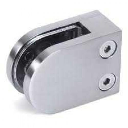

17 hours ago, Thorfun said:
thank you. don't suppose you have a photo of how it's held in do you please? we only need 800mm max screen. any wider and the kids won't be able to get in to it! 🤣
Not at home at the moment to show the whole thing but these are the clamps I use for screens.
38 minutes ago, Nickfromwales said:
These would need to be hinged "flappers" ;)
i believe @markc was responding to this post
which is to do with the screens in the kids bathrooms. 🙂
now thinking about flappers for the kids screens as well after the discussions about splashing on to flat tiles outside of the shower former as the kids will have 1500mm trays and only 800mm screens. but will be the standard walk-in shower with a wall at both ends and side with a glass panel and walk-in entrance. kind of like this
