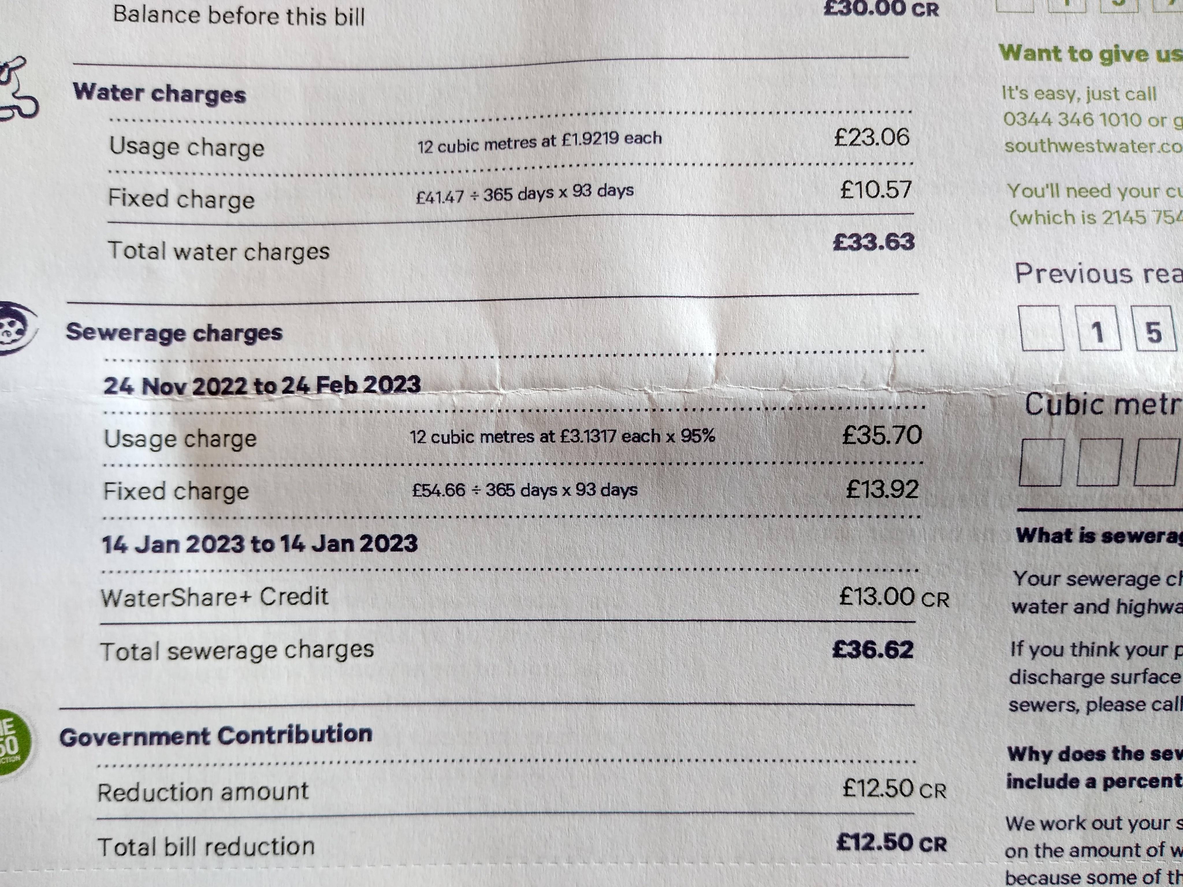

SteamyTea Posted May 20, 2023 Posted May 20, 2023 On 18/05/2023 at 17:58, saveasteading said: Water costs about 3p / litre I think, allowing for supply and disposal I think you are out, should be 0.3p Mine is the most expensive in the land and was 0.53p/litre last year I think. 1
Thorfun Posted May 20, 2023 Author Posted May 20, 2023 13 minutes ago, SteamyTea said: I think you are out, should be 0.3p Mine is the most expensive in the land and was 0.53p/litre last year I think. We checked our water bill and we pay 0.17p/l, so approximately 29p for a 10 minute shower at 17l/min or 15p at 9l/min.
SteamyTea Posted May 20, 2023 Posted May 20, 2023 (edited) 21 minutes ago, Thorfun said: We checked our water bill Just checked mine. Water was £1.9219 Waste was £3.1317 X 0.95 so £2.9751 So £4.9m³ Then add the daily charge of £0.1497. I used 12 m³ over 93 days. So 129lt/day. With my government rebate of £50 a year, and the Water Share credit of £13. Plus the £30 Stop the Drop of £30, my last bill was £33.63. So £0.0028/litre. Really not that bad when I look at it. Does seem perverse that to save water, SW Water makes it cheaper. But at least central government are coughing up a bit to help. Off to have a deep soak in the bath now. Edited May 20, 2023 by SteamyTea
