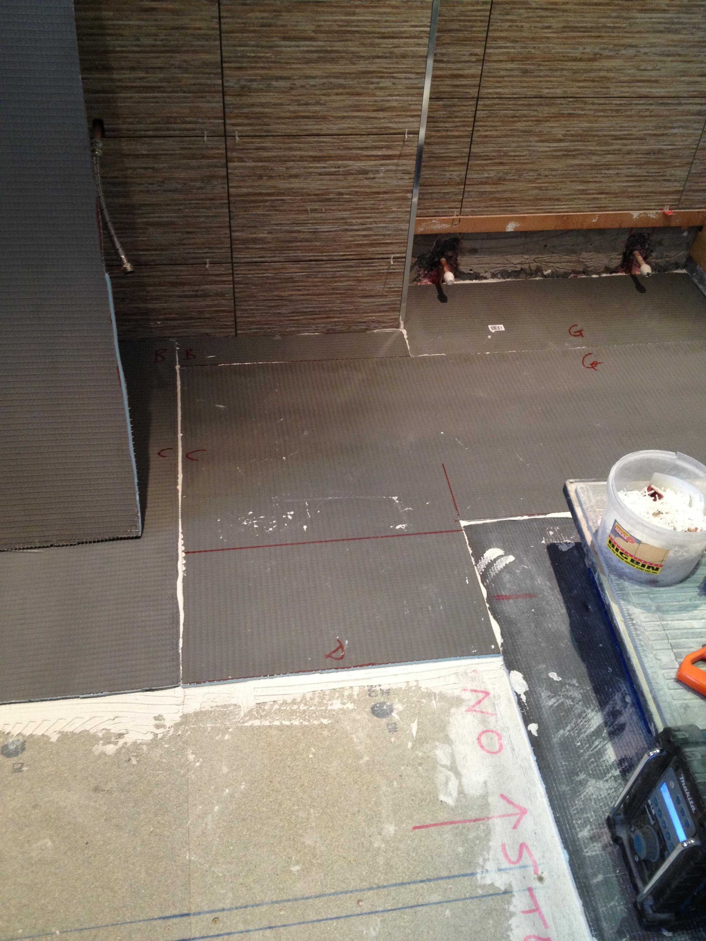

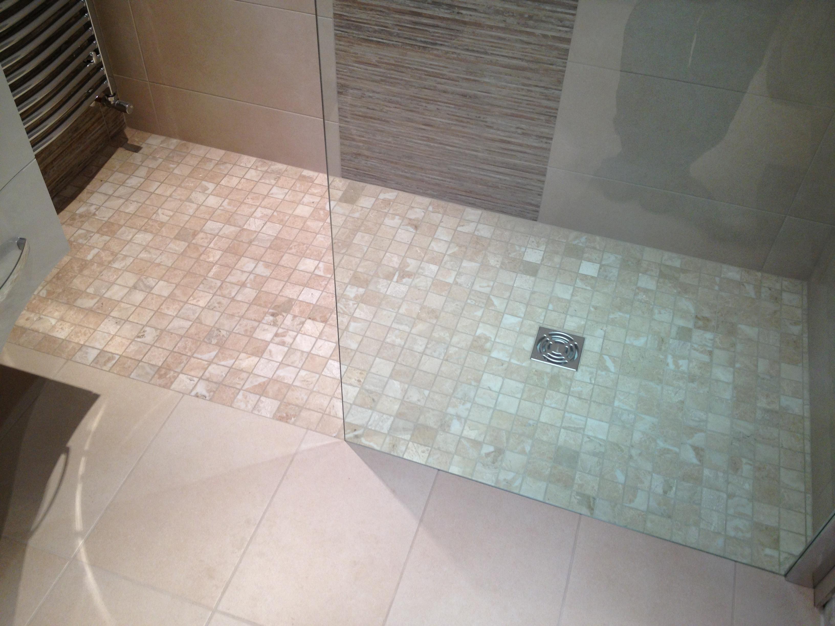

All the area around the actual shower former (Wedi) is slightly elevated compared to the perimeter of the former highest point, eg so I could bench the mosaics in and have a fall all the way from the towel rad to the drain.

You can do the same with regular tiles, just the cuts have to be a bit more inventive. Also, depends on whether you've gone for linear trays? Not too late to change and mosaic? Or is your preference for large-format tiles only?
