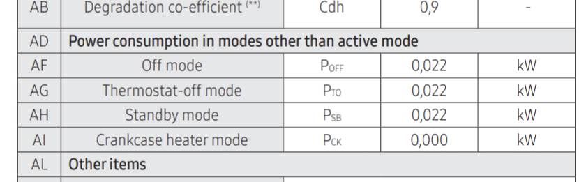

Here's the standby power consumption. 22W is OK. not the best, but very far from the worst.

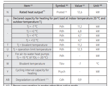

So what is the output modulation of these new units?
Been looking for some indication of this but not found anything yet....
There is some info about part load performance here, but I don't know how to interpret this and whether or not it tells you the modulation ratio (but it does suggest that the 12kW unit modulates at least down to 4.7kW).  Midsummer wholesale claim that 12-16kW Samsung heat pumps need min 50l system volume which is pretty good (see here page 3 https://midsummerwholesale.co.uk/pdfs/quick-start-guide-samsung-gen-6-kits.pdf) but I don't know the assumptions or authority for this claim.
Perhaps someone on this forum knows how the parameters listed below are measured.
It does, but think it depends just how big a part the part load is.
Liquid injection to run the compressor harder without melting it or trashing the oil/refrigerant is the party trick. Doesn't do much for performance in the normal range AFAIK.
