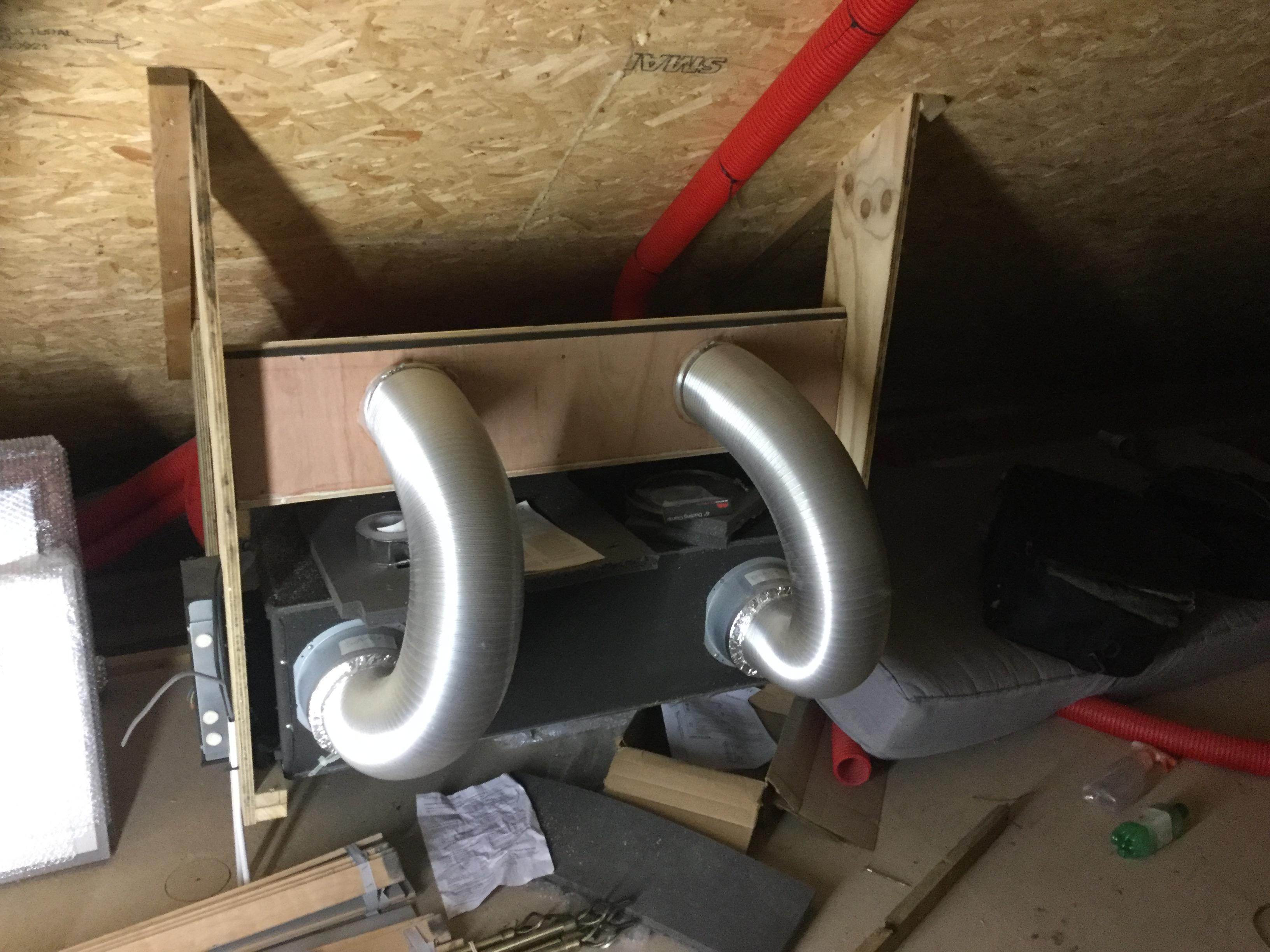

joe90 Posted September 16, 2022 Posted September 16, 2022 (edited) How long would it take to mount it properly in the first place? Is it really worth a temp job to have to do it again? I hung mine from the roof I beams in the loft, so that any noise generated did not transmit to the ceilings and that works very well. Edited September 16, 2022 by joe90

joe90 Posted September 28, 2022 Posted September 28, 2022 31 minutes ago, MarkyG82 said: what about a hanging platform? Exactly what I did, hung from roof I beams and on rubber feet. This was done to stop any noise and vibration through the bedroom ceilings and it works very well, no noise at all apart from a little air noise from terminals when on boost. 1

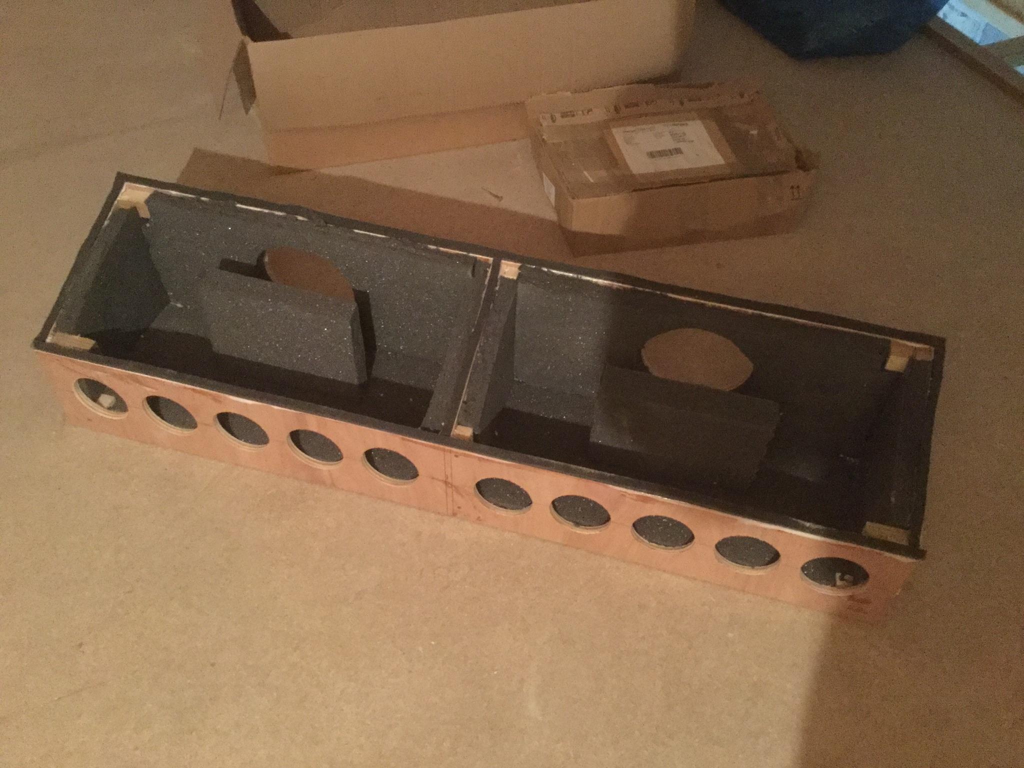

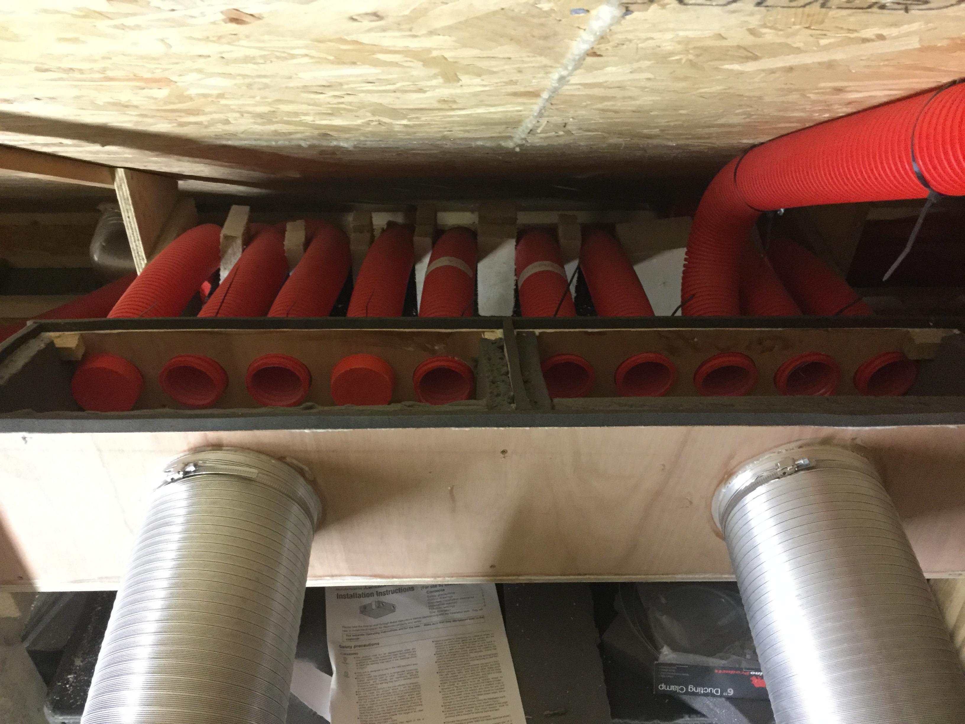

joe90 Posted September 30, 2022 Posted September 30, 2022 On 28/09/2022 at 21:16, Nickfromwales said: box attenuators Or make your own that doubles up as a manifold 😇 1
