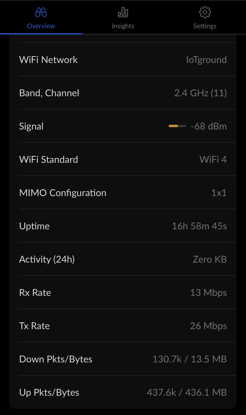

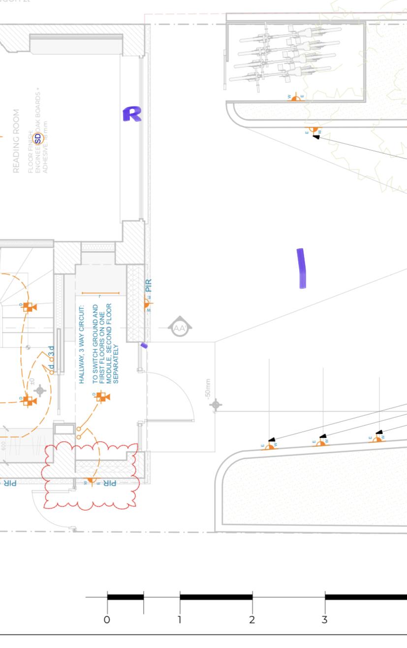

Adsibob Posted August 19, 2022 Posted August 19, 2022 The ubiquiti setup we have at home seems to be working very well for everything else, so I’m pretty sure the answer to my question is: the Ring wifi doorbell is absolute crap, but thought I’d share here in case anybody had similar experience. Below is a a floor plan showing the front of my ground floor. The “R” is the position of the Ubiquiti Dream Router. It is perched up on a windowsill which is about 1m or possibly 105cm up from the floor level. It isn’t touching the glass, but it’s fairly close. We have double glazed aluminium windows. Very thin aluminium profiles. The wall that window is in is a solid double thickness brick wall (no cavity) original from the 1930s. We’ve added about 40mm of EWI, with a Ceresit finish coat. Internally, we had to put in a breathable vapour membrane, which I recall looked a bit foil like, and there was also a metal frame built to create a gap before the plasterboard. So maybe it’s acting like a Faraday cage. In the bottom right hand corner of the drawing you can see part of our porch. The little purple mark, represents the location of our doorbell, which is about 1.2m from the ground. It is mounted on the corner/junction of where the wall meets our front door. Our front door is made of steel and double glazed panels. So maybe that too is acting as a faraday cage. Here, the wall is brand new; in addition to being a double brick cavity wall, it also has the EWI (though no internal foil membrane and no internal metalwork). The porch was a recent addition, hence why it’s built better. As you can see from the scale, the distance between the Router and the doorbell is no more than a mere 4m. Despite this, the doorbell consistently reports “very poor wifi signal”. Video stream is usually fine, but audio is pretty bad, particularly if using the app on 4G when away from the house. It is virtually impossible to speak to someone at the door on the app, when I’m away from the house. I’m running a separate 2.4ghz wifi network just for the doorbell, a firestick and a couple of other IoT devices. Here is the data my Unifi app is reporting for the wifi connection between the UDR and the Ring doorbell: Was hoping someone could give me some advice please.

Radian Posted August 20, 2022 Posted August 20, 2022 You say you have an internal foil like layer but what about the EWI? Has that also got a foil layer or two? And your glazing - low E? The coating is metallic. All this makes a superb Faraday cage. Get a WiFi signal checker app on your phone and wander outside with it. 1

Adsibob Posted September 3, 2022 Author Posted September 3, 2022 So after messing around with a wifi scanner app and trying various things, only to discover that the best my doorbell can manage is a connection that varies between -68 dBm and -72dBm and latency that was 102ms, I have admitted defeat and accepted that to have a better doorbell connection I will have to spend some money on a PoE one. The decision was made a lot easier by the fact that my BRILLIANT electrician had chosen (without my knowledge) to use CAT5E cable to take power from the ring transformer in our fuse box to the doorbell, so happily there is already Ethernet cable imbedded in the wall, meaning no plasterwork and paintwork needed to be ruined. The challenge was getting some cable from the closest existing Ethernet point to the fuse box. But my sparky is a an actual magician. I simply do not know how he did it. He created a small hole in the wall 3m high up and managed to drop down some cable, connect that to the Ethernet port 2.2m below, then take the cable through the wall, under the stairs, over a under stair WC, and then pop it through another wall to come out in this tiny 9mm gap between the wall and some floor tiles, that we were fortunate not to have finished yet. So the ONLY visible bit of cable is from that point, 1.25m up to the fuse box, but that is all going to be covered up when the coats wardrobe gets built. Now to decide whether I ditch the ring system completely and go with a different PoE doorbell, or spend the fortune that Ring is asking for.
