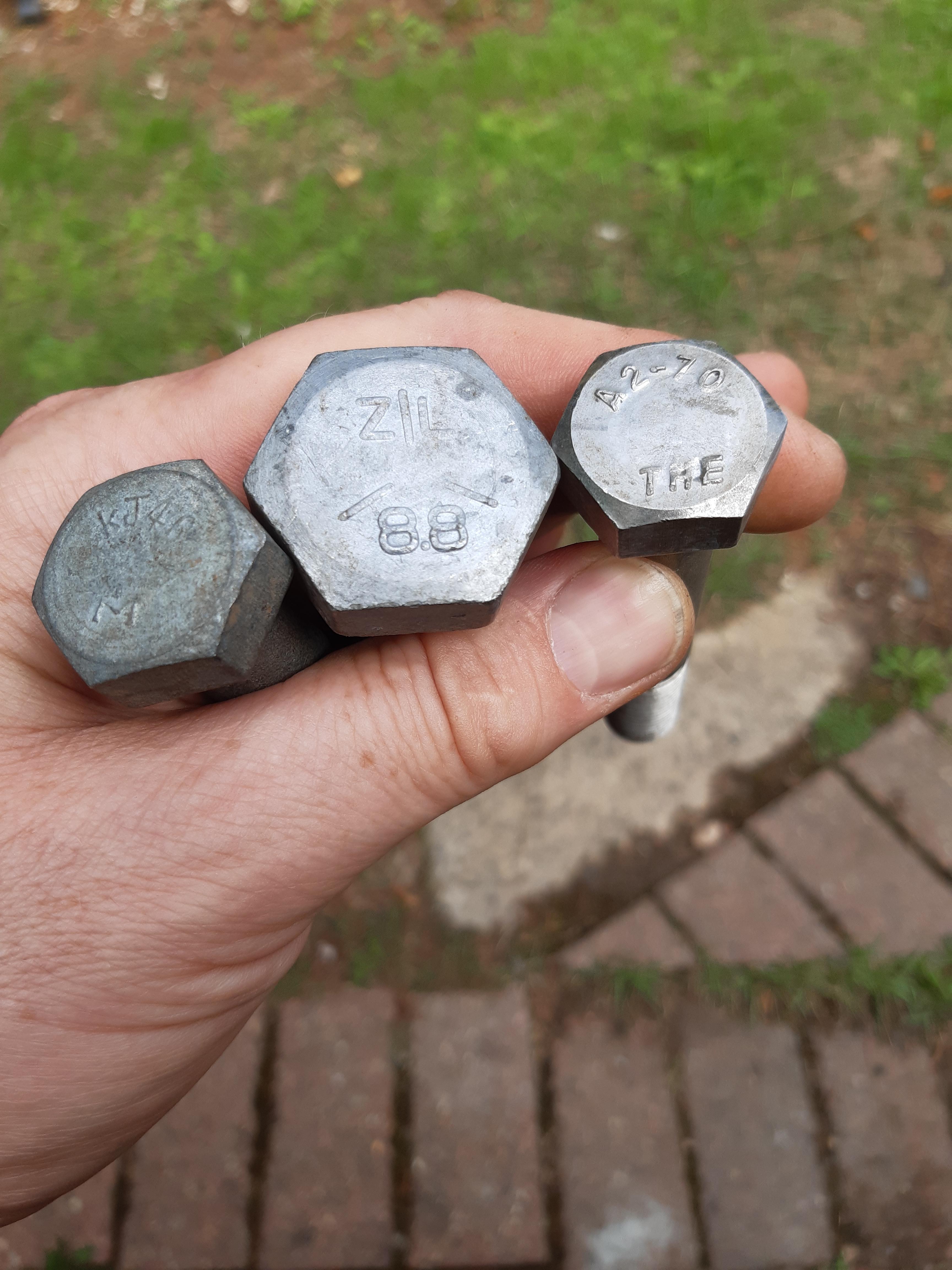

The ones I was looking at are described as "A2 304 Stainless Steel"  I am sure I have been told Stainless is more brittle?
It is more brittle, less ductile maybe a better term but fine for what you're doing. (I have seen A2/304 used by the seaside and peppered with holes like a Swiss cheese).
A2 = 304 as A4 = 316 just denotes the corrosion resistance. Amount of chromium or something.
Even if strength grade 70 as opposed to 80 you're good to go with it.
Fyi. 3 bolts, 2 on the left are galvanised. First one is grade 4.6, low tensile strength. Second is grade 8.8  generally considered the start of high tensile fixings (you then get 10.9, 12.9 etc). Can be tricky to galvanise or zinc plate 10.9 and above as you risk hydrogen embrittlement. Other finishes are available like cad plating, sheradising etc. Its why car bolts are generally "black".
If a fixing has no strength grade treat as the lowest. We discard them tbh.
On the right then is an A2 70 bolt, so the lowest corrosion grade and lowest strength. You could just as easily get an A4 80.

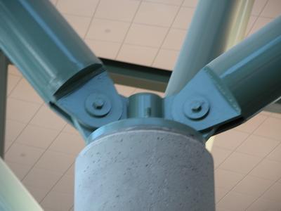

We used to use a similar design to this for steel and timber connection. Look really good and not difficult to fabricate.
