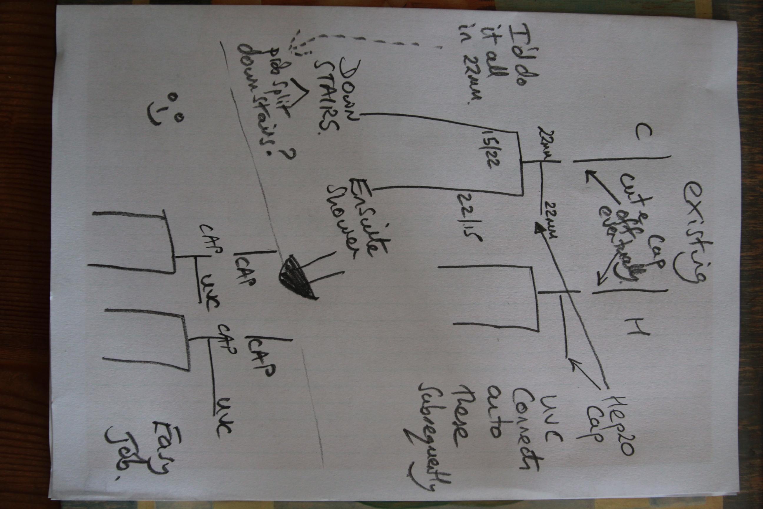

'Turning' the T piece is going to be a pain later - cant you tweak the design so the incoming h2o for both hot an cold comes in on the vertical and then both existing and proposed feeds come in on a horizontal run.  When you upgrade - cut through the old supply and connect to the new one.  Will sketch a pic if necessary tomorrow.
The incoming hot and cold comes in vertically at the Ts, either from above where the feeds are now or from below maybe later on.
I mean to turn both assemblies with the T in through 180 degrees...
Sketch pls of what you mean! :)
Edited by Onoff

I know what @CC45 means but it's pointless worrying now as the tees will need to be 22mm later, unless your not going to bother with upgrading the feeds from 15mm ?
I don't, waiting for the sketch! xD
If you mean I need to redo this lot in 22mm that's going to be tiled over then it's a non starter!

If you've said that already and I missed it then I'll not shout loudly at my iPhone with "thanks for telling us !" as that means you already know you'll be altering it to single radial runs which makes the 15's tees subject obsolete. :S.
Are you drinking in the day or what ? :D.
No, I don't mean pull all that out after you've tiled.....I'd have a bloody contract taken out on me if I suggested that.
I thought I'd previously said here that runs that terminate at one outlet can be in 15mm, or 15mm to two outlets where they will never normally be open at the same time, eg the bath taps / shower feed and the basin in that room. One occupant at a time = 15mm feeds no problem. Feeds should be 22mm to the attic / other, and then the ensuite tees off the 22mm in 15mm, or you do a manifold arrangement.

not an artist but I guess this is understandable?
Thanks. I see want you mean now. Tbh though, like toilet paper I'm on a roll! :)
2018-05-22_06-50-30
SWMBO happy enough to have one shower going at a time for now. There's not the cws or hot cylinder capacity anyway for two simultaneous showers.
