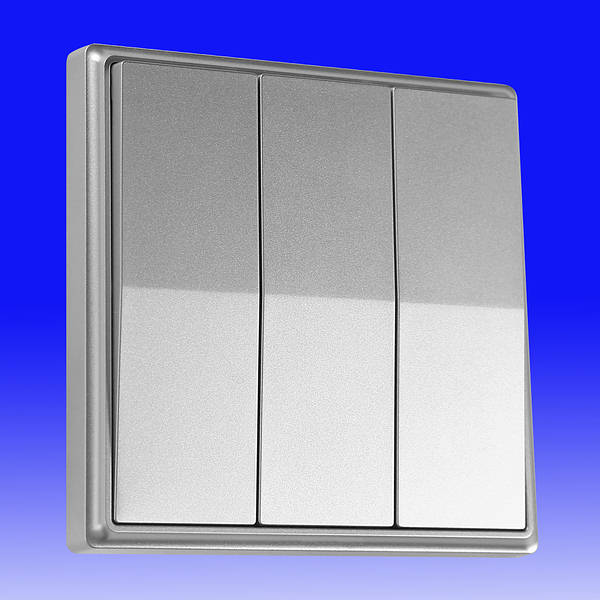

Onoff Posted January 8, 2018 Author Posted January 8, 2018 19 minutes ago, Nickfromwales said: Nice lights. . Pretty sure I'll go with Quinetic Kinetic switching so I can have one as I enter the bathroom and one within easy reach whilst in the bath. Just hope the signal gets through the foil on the pir! £66 for 1 switch and 3 receivers if I go: Sw1 - downlights, Sw2 - pocket / bath side panel Sw3 - the rc LED strip alongside the bath. Have to mull that over.
Nickfromwales Posted January 8, 2018 Posted January 8, 2018 Just now, Onoff said: Pretty sure I'll go with Quinetic Kinetic switching so I can have one as I enter the bathroom and one within easy reach whilst in the bath. Just hope the signal gets through the foil on the pir! £66 for 1 switch and 3 receivers if I go: Sw1 - downlights, Sw2 - pocket / bath side panel Sw3 - the rc LED strip alongside the bath. Have to mull that over. I've just literally quoted a job ( well JUST before my poxy arm injury ) in a brand new static caravan. I saw these in my local TLC and thought they'd save a lot of trunking. Deffo will be featuring in bathroom jobs of the future. The ones I DO love are the sensor / proximity ones that @PeterW linked, where you put the sensor behind a tile / other, and simply swipe your hand past it to bring a light / other On or off. That's the dogs bollocks, but for a lesser budget these Kinetic ones are superb. ?
Nickfromwales Posted January 8, 2018 Posted January 8, 2018 12 minutes ago, Onoff said: Just hope the signal gets through the foil on the pir Put the receiver under the bath
