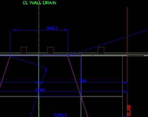

Onoff Posted August 28, 2017 Author Posted August 28, 2017 (edited) What drunken fuckwit mark out the drain centreline from slab edge 714mm instead of 704mm? Hmm, I wonder??? I'll just adjust it...Oh wait, I cant! Also cants back a bit but I'll get away with it. That poxy blue foam! I'm sticking to low expansion in future! EDIT: In the cold, (sober) light of day I realise my 704/714mm issue isn't a problem and that I'd accounted for it already. The dimn to the left of this is critical for the tiles and that's fine. I'll get working on the shower tray former tonight hopefully (after making my mower part). Edited August 29, 2017 by Onoff
Onoff Posted September 6, 2017 Author Posted September 6, 2017 (edited) Starting the thin angle iron former: I'll use two strips down the edges of the slab to make up the level (edges) before the falls. The angles will get a load of holes Starrett drilled in them to better fix into the "concrete" when laid. Can't decide whether to pop rivet, self tap or MIG. Not so sure about welding with the bath in there though! Edited September 7, 2017 by Onoff

Dudda Posted September 8, 2017 Posted September 8, 2017 Not sure what the steel angles are for. Are they to help you create the falls? Anyway they will most likely form the role of crack inducers as they'll have so little cover. The no.4 mix looks good as you'll need it strong. Whats the thinnest part of pour?
Onoff Posted September 8, 2017 Author Posted September 8, 2017 (edited) 41 minutes ago, Dudda said: Not sure what the steel angles are for. Are they to help you create the falls? Anyway they will most likely form the role of crack inducers as they'll have so little cover. The no.4 mix looks good as you'll need it strong. Whats the thinnest part of pour? Yep, for the fall lines. Tbh I'll drill the hell out of them so they'll look almost castellated. The angle is nom 40x40x1 so was thinking 20/25mm holes. The mix should "bond" through these holes so hopefully no cracks. Thickness goes from nom 100mm on the two existing edges down to the drain. Not sure on the thickness there without some more measuring but 60-70mm maybe? Floor build up curves up a little there. Out of that thickness comes the hollow "pots" formed by the Polypipe trays. You've got me half worried about the steel acting as crack inducers! Edited September 8, 2017 by Onoff

Nickfromwales Posted September 8, 2017 Posted September 8, 2017 Black. Are those angle irons mild steel? Id not be burying mild in a wetroom slab . Tbh I'd not be burying metal in there at all.
PeterW Posted September 8, 2017 Posted September 8, 2017 +1 to what @Nickfromwales said - I'd use the angle to create the first "wedge" of concrete then remove and use the two edges as the former
Onoff Posted September 8, 2017 Author Posted September 8, 2017 (edited) 19 minutes ago, Nickfromwales said: Black. Are those angle irons mild steel? Id not be burying mild in a wetroom slab . Tbh I'd not be burying metal in there at all. Yep, mild steel. I'd though about this and can''t see how it's really any different from the A142 mesh in there. OK that's completely under the concrete and thus encapsulated. Thinking the saving grace is that'll it all be tanked over. I've got to make up the edges level by 36mm one edge and 46mm the other before the falls start. Was going to drill into the slab edge and resin in some M6 studs to support those lengths. I could cast it in sections but how do I ensure the concrete doesn't stick to the steel? Surely any release agent would impeded the next lot of concrete sticking to the first? And surely a one hit. homogeneous pour is better? Pretty sure concrete over steel has an initial protective effect as the medium is alkaline. It's only years later once CO2 seeps in that the medium becomes acidic. This is what befell the art deco places and blocks of flats. Still a no-no you think? EDIT: I'm getting a price out of interest for 4 bits of st/st angle folded from sheet to 40x40x1 Edited September 8, 2017 by Onoff
Dudda Posted September 8, 2017 Posted September 8, 2017 Get rid of all the steel angles in the concrete (both mild and stainless). Even if you make Swiss cheese out of it it's still a weak point and will crack or it will expand at different rates to the concrete due to the underfloor heating or loads of instant hot water and crack that way. Steel mesh, beams, etc need 50mm min cover. You won't get that in 70mm depth. You want one piece of concrete poured in one go and the fibres are enough to reinforce it. Its not a huge area. Make an inverted form guide you can rest on top as your creating the falls if you want them mm perfect. You can make that out of the steel angles you have if you want. I think this is extreme but you like things mm perfect and creating additional work.
Nickfromwales Posted September 8, 2017 Posted September 8, 2017 Yup. No-no. Mild buried in concrete has to be 50mm or more under the surface to stop any moisture rusting the steel. If you have a slight failure the slab will absorb and dissipate it but not if it can get to the steel. Lay a stainless chicken wire at the bottom so when you lay the sections they're still bridged and the sections will act as one.
Nickfromwales Posted September 8, 2017 Posted September 8, 2017 Agree with @Dudda Id form the two sides meeting in the middle like a V, and then fill the valley to create the centre section. Much stronger and less chance of cracking than 3 sections. I'd still deffo go with the stainless 'chicken wire' / similar and fibres to deal with heat / cool cycles.
