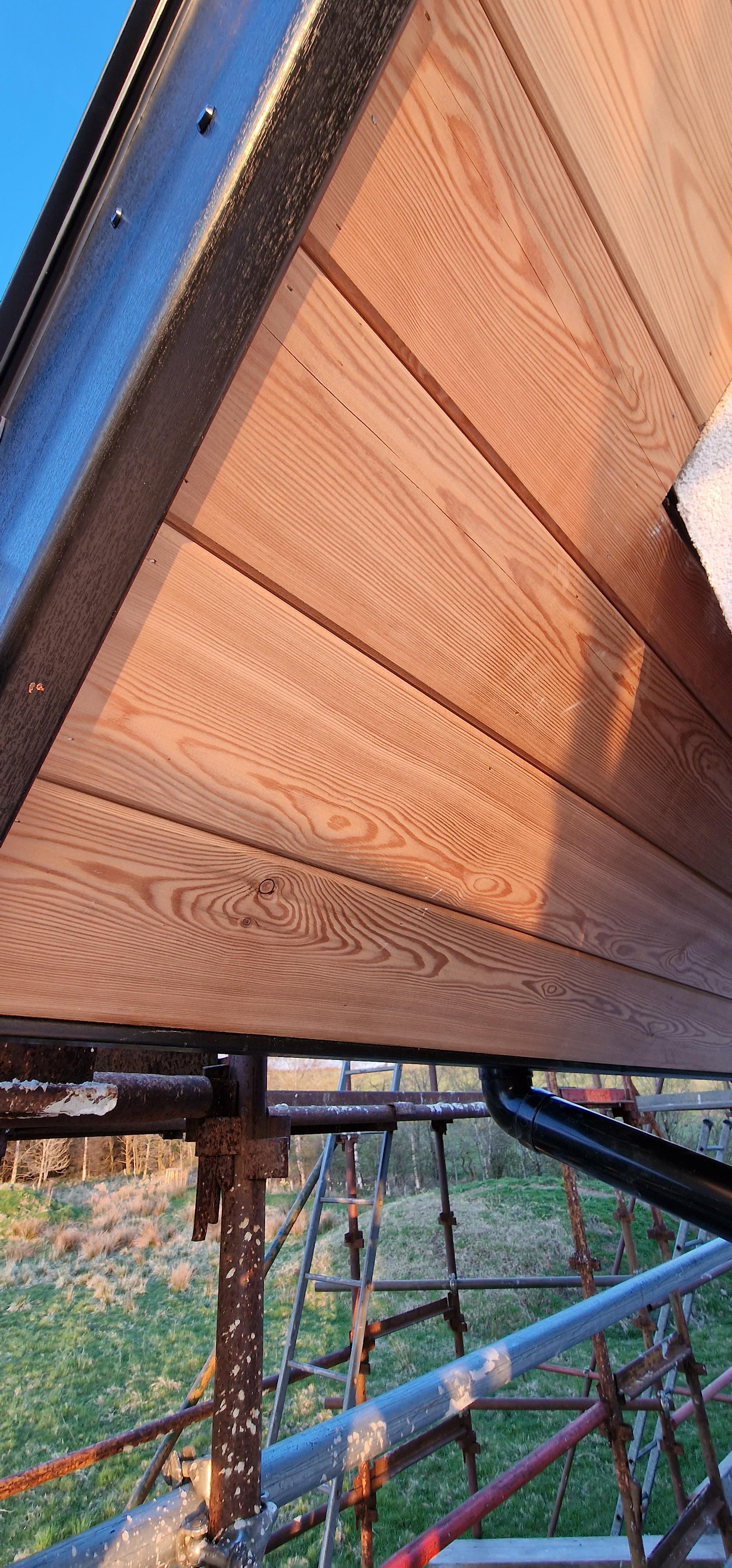

Kelvin Posted July 21, 2022 Share Posted July 21, 2022 (edited) We visited Russwood today to look at cladding. Immediately ruled out Accoya. The expense aside, once painted it might as well be plastic. Fine if you want a very sharp perfect look. The biggest issue for me was the examples they had on display were chipped here and there and that would annoy me as it would definitely end up chipped on the building. That left two main options really. Thermopine (from Finland) and home grown Scottish Larch. They had a large wall of board on board Scottish Larch that was untreated and had been up for 3 or 4 years. (See pic). It was stunning and exactly the look we want. They can do Thermopine as board on board too although the planks are slightly narrower than the Scottish Larch. The challenge is it means we end up with exactly what I didn’t want when it initially goes up - orange, weathering at different rates around the elevations, staining while it weathers, and potential for the black staining it can suffer from. My preference is the Thermopine because it’s more stable than the Scottish Larch and being a processed wood has better longevity. However, Scottish Larch appeals because it’s grown and milled here in Scotland. The other alternative is Abodo from Glenalmond in the Patina coating. It is really stunning, will look weathered from the start and will weather consistently. However, it’s more than twice the price of the Thermopine and more than three times the price of the Scottish Larch. I’ve had a quote from Glenalmond for it and it came in at £17,500 ex VAT for 208sqm untreated supply only so quite dear. Has anyone fitted homegrown Scottish Larch cladding or something similar in terms of quality? Edited July 21, 2022 by Kelvin Link to comment Share on other sites More sharing options...

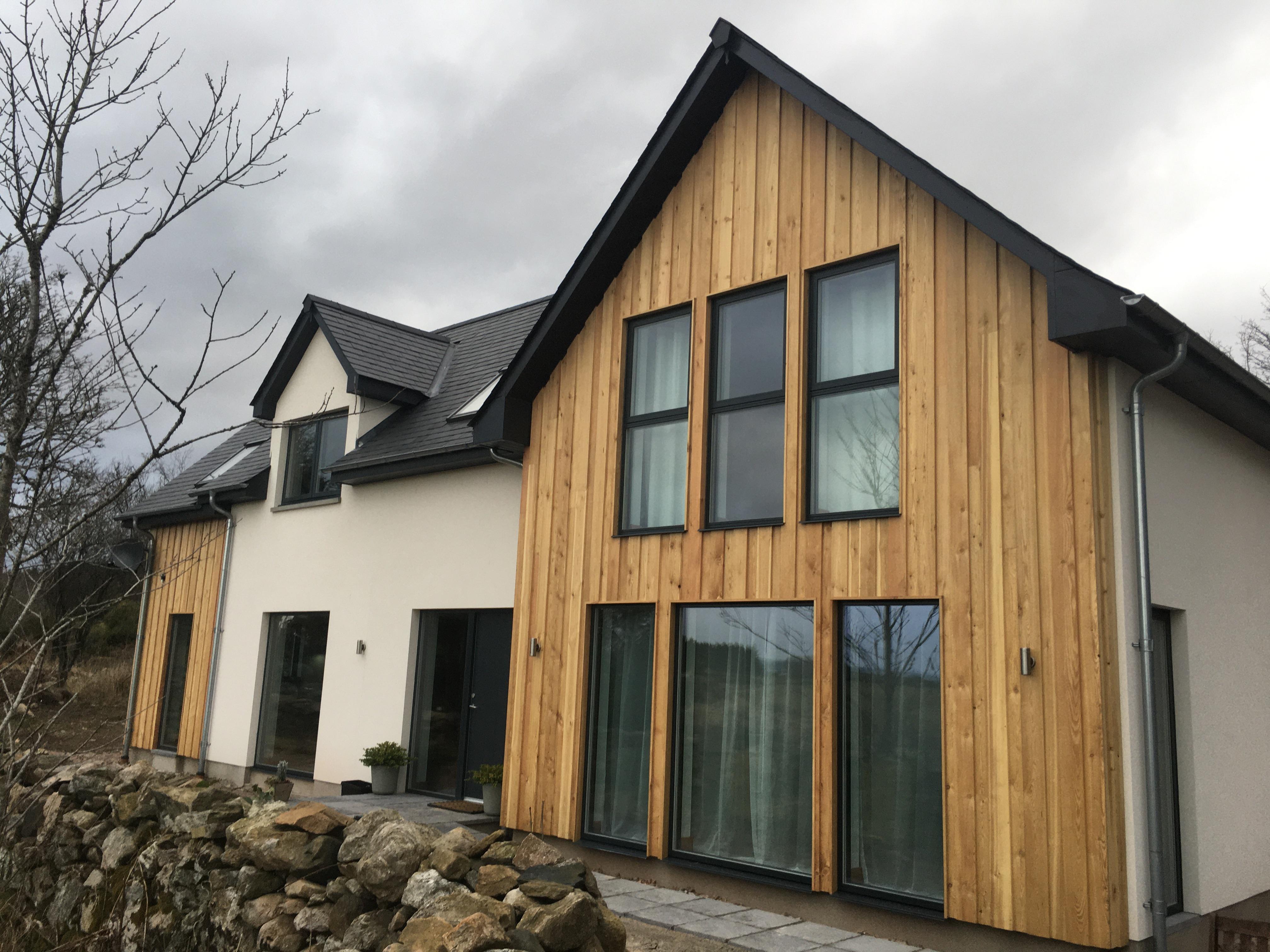

JohnMo Posted July 21, 2022 Share Posted July 21, 2022 I have Scottish larch, dismissed Russwood on a price. Got mine from Ali Patterson of Nairn, all trees from local wood, will mill to any shape or size and about a 1/3 the cost. Good delivery. Link to comment Share on other sites More sharing options...
Kelvin Posted July 21, 2022 Author Share Posted July 21, 2022 Looks lovely as does the house! How is it weathering? I’m also looking at The Scottish sawmill in Dunfermline who are also cheaper than Russwood. Link to comment Share on other sites More sharing options...
Russell griffiths Posted July 21, 2022 Share Posted July 21, 2022 Have a look at Douglas fir. a neighbour has just used it and looks very nice. Link to comment Share on other sites More sharing options...
JohnMo Posted July 21, 2022 Share Posted July 21, 2022 37 minutes ago, Kelvin said: Looks lovely as does the house! How is it weathering? It had nearly a year exposed and untreated, was just starting to to have a tinge of grey. Now treated with ceder oil, as in the photo. Link to comment Share on other sites More sharing options...

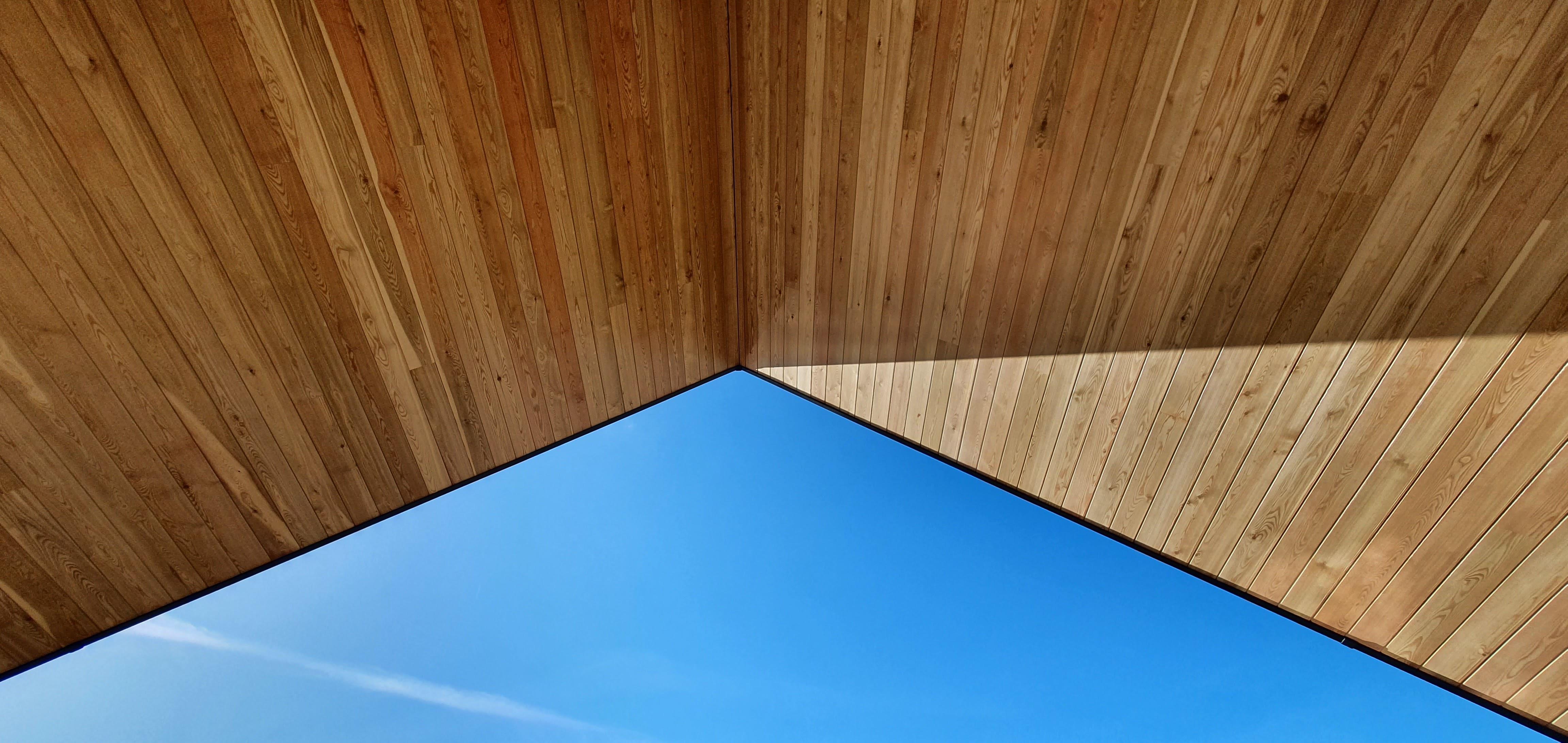

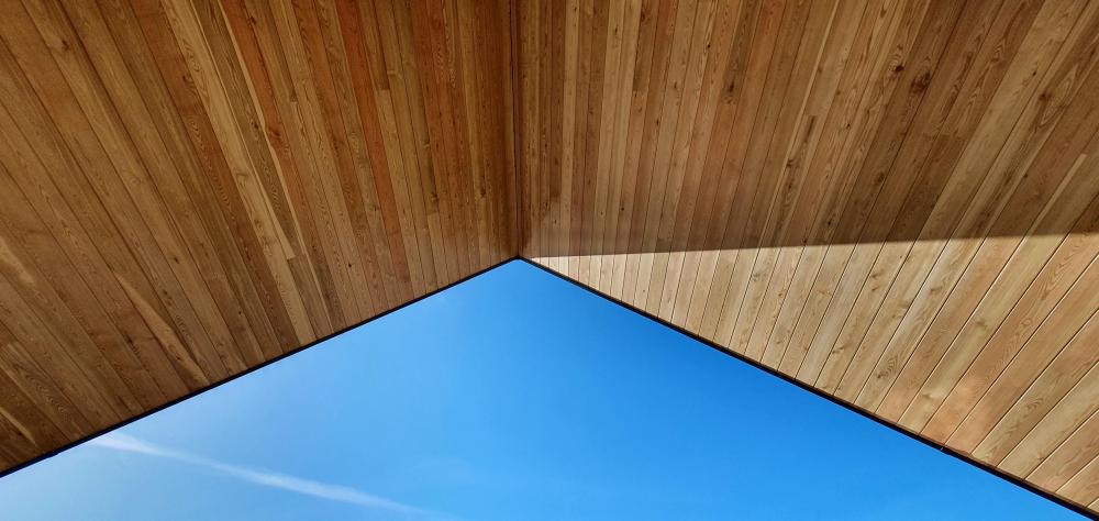

SuperJohnG Posted July 22, 2022 Share Posted July 22, 2022 (edited) I scratched using my siberian larch on walls aesthetically because we went a different route and fitted black cedral which is very nice. But still used siberian larch on soffits and canopy which is lovely, but no help to you. If you like scottish larch go for it....you won't regret it and if you have the right details for ventilation and water it'll all blend eventually and look good. They can all get a wee bit of mould and wee spots due to natural sugars. My siberian larch has only a couple which I was surprised at butnthey go away. Few pics for reference.... Edited July 22, 2022 by SuperJohnG 1 Link to comment Share on other sites More sharing options...

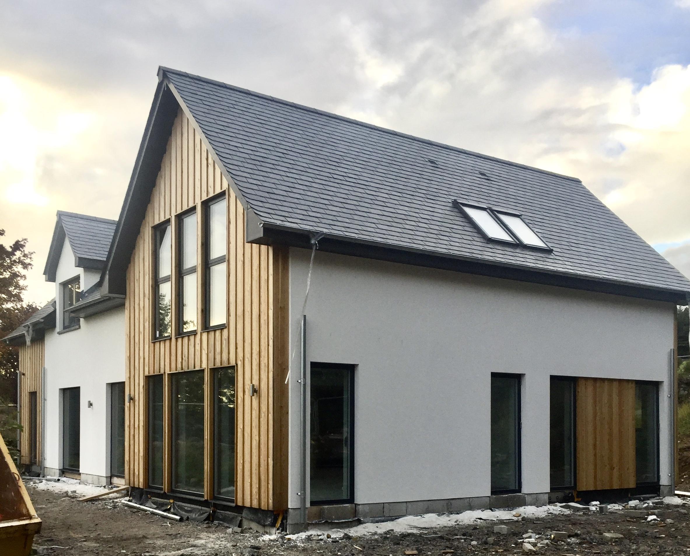

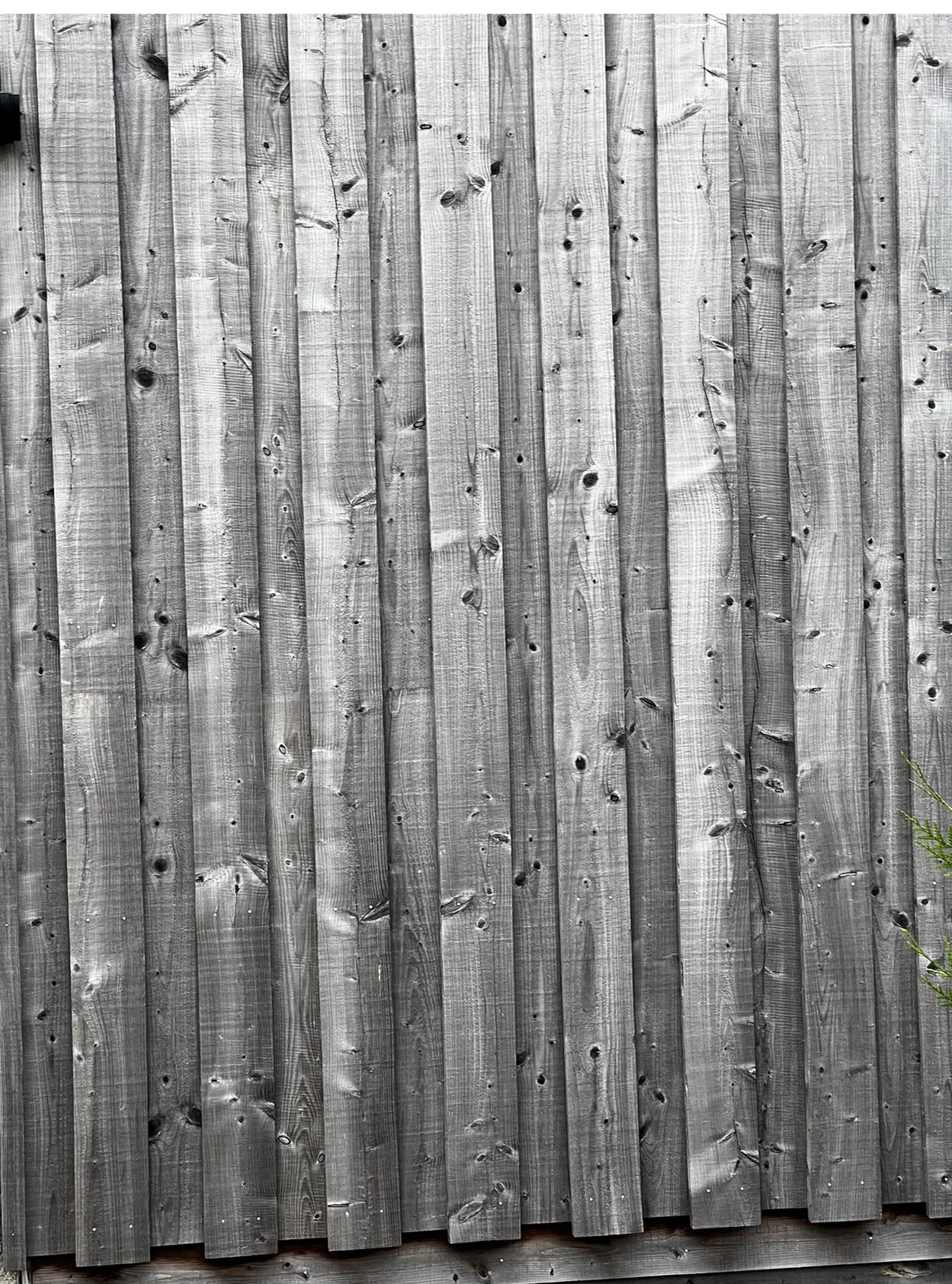

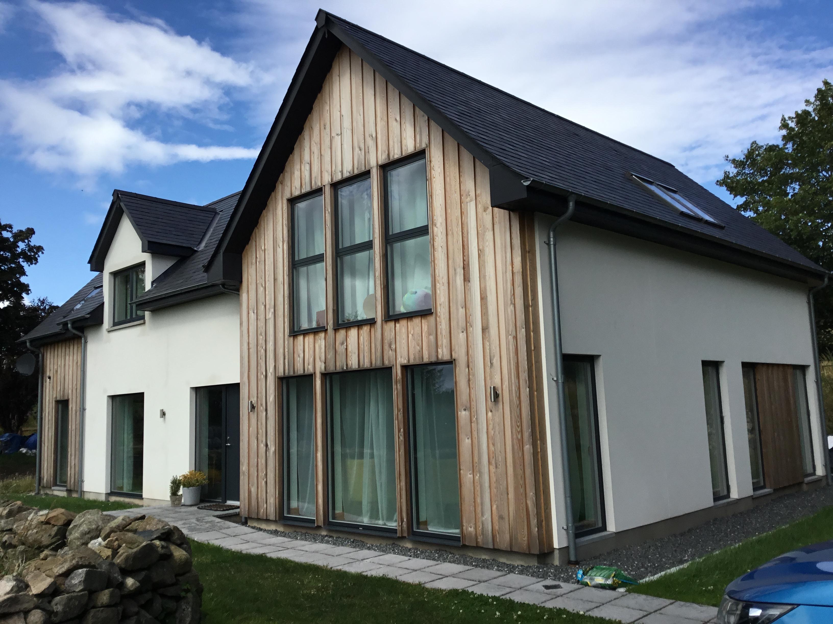

Bozza Posted July 24, 2022 Share Posted July 24, 2022 (edited) Kelvin, to assist you in your decision making I have attached pics of my house Sept 2020, March 2021 and July 22. The cladding is untreated Siberian larch, board on board. I think it’s about half way towards “silvering”. my tip would be whatever you do install have a few full spare planks left out in the weather if possible. In case you need to replace split boards, they’ll match. Edited July 24, 2022 by Bozza 1 Link to comment Share on other sites More sharing options...

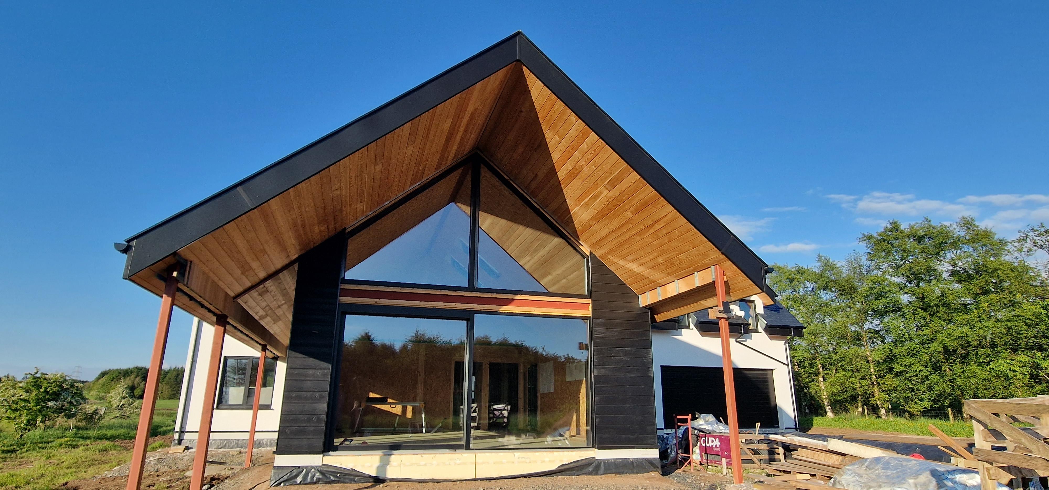

saveasteading Posted July 25, 2022 Share Posted July 25, 2022 1 minute ago, Kelvin said: SiOO:X Accelerated weathering is surprisingly expensive. I think we are going with Russwood, but untreated, on the basis that the timber is selected, ie higher quality, and so won't twist or have knots falling out. I don't like the weathered grey look (and would stain it) but am outnumbered, and presumably plain wrong. Link to comment Share on other sites More sharing options...
Kelvin Posted July 25, 2022 Author Share Posted July 25, 2022 (edited) It is indeed. Fortunately we both agree in our house on the weathered look. 😁 Russwood have a large wall of board on board that’s weathered (the pic I posted at the start) and that picture doesn’t do it justice. It’s completely uniformly silvered and has a deep silky sheen to it. We both loved it straight away. We don’t agree on the stone flooring however and after the third trip to yet another another flooring place I’m sick at looking at chuffing stone floors so have given that decision to my wife albeit we have agreed on porcelain rather than stone. We have decided on the timber flooring for the stairs and first floor though. 😂 Edited July 25, 2022 by Kelvin Link to comment Share on other sites More sharing options...
