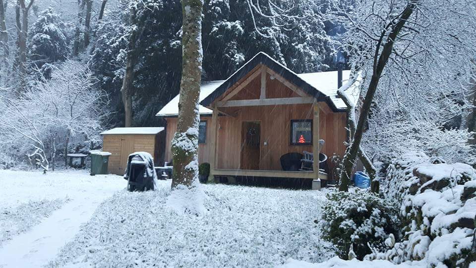

This our 44mm2 tiny home, built at a cost of £30k
9 minutes ago, Tennentslager said:
Check out my blog...49 sq/m for £9k...cosy
Where is your blog?
@Triassic - surprising how big a 44mm2 house con look on a picture!
