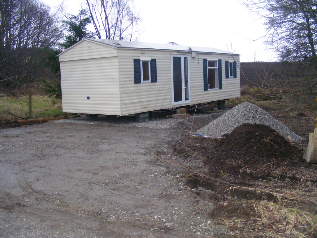

It as a last minute addition to our planning application, we’d originally thought of having an old static caravan for the duration of the build, but a 12 foot wide caravan wouldn’t pass up an 8 foot drive and craning it over 75 foot tall trees wasn’t feasible because the road is too narrow for the size of the crane necessary.
As as we live in a National Park, so we are hoping to let it out after the completion of the new build. The local expert recons we could get £500 per week! 60 weeks and it’s paid for!
You would definitely need PP to keep that as a holiday let.
We "negotiated" to keep ours after the build.  Initially the planners were only going to give temporary PP for the static 'van, which is their standard policy. When I pointed out that on the day of completion, I could remove the 'van from the site, and then immediately replace it with an identical one in an identical location, and it would qualify as  a garden outbuilding under permitted development, they then changed the planning permission to "habitational use of the caravan shall cease upon occupation of the house"
So while I can lawfully keep my static 'van as a studio and workshop, I cannot let it. That would require PP which would be unlikely to be granted.

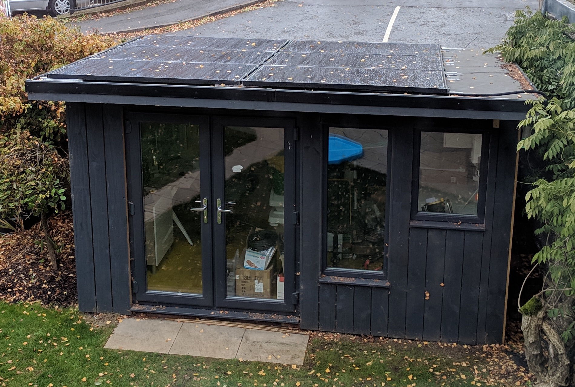

Rough costs - probably around £2000 all in
Structural timber - £20 - I found a local bungalow that was being 'scalped' for a loft conversion and just took all the timber from it. Great, slow grown, straight old timber. Doubled up a few for floor structure strength
OSB -~£200 - 18mm OSB to roof, 11mm OSB on all external faces, 9mm OSB internal wall lining, 18mm OSB floor
Windows / doors - £500 - New, found on eBay
Roof - £200 - EPDM - kit brought online included upvc trims
Insulation - £200 - Celotex to roof and floor, 100mm rockwool in walls and then 'spacetherm' blanket
Heat pump/air con - £500 - eBay

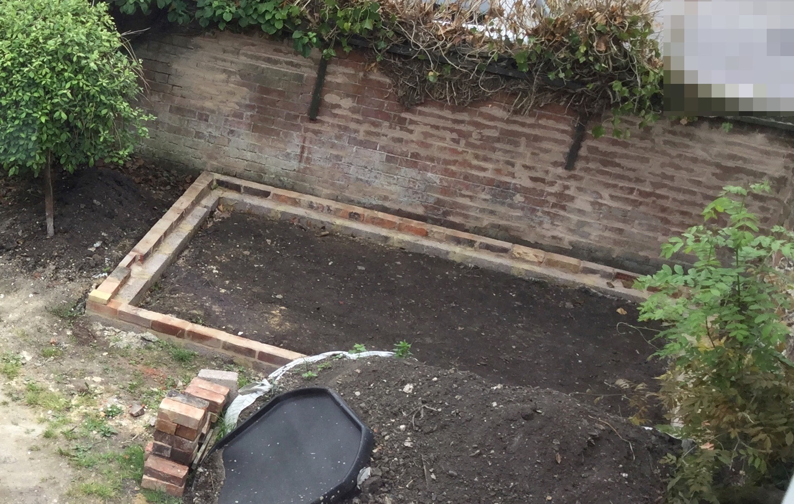

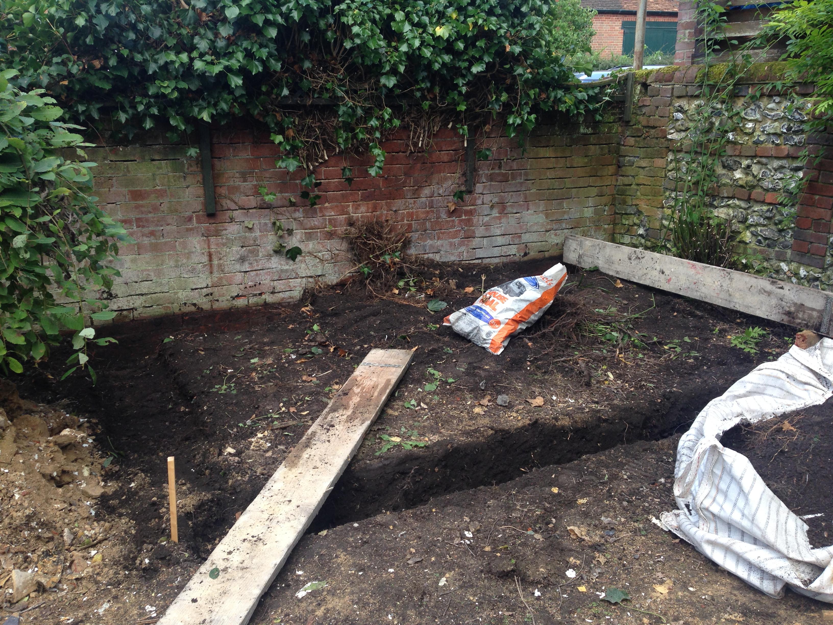

Footings - £200 - Hand dug, approx 1.5ft deep x 1ft wide 'ring' beam, 1 course of concrete blocks laid on side, 1 course of bricks that you see above the grass
Cladding - £200 - Rough sawn 'gravel boards' from local timber yard, breather membrane and battens behind

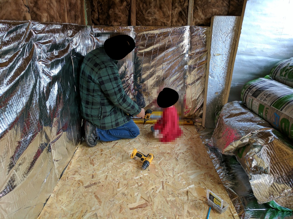

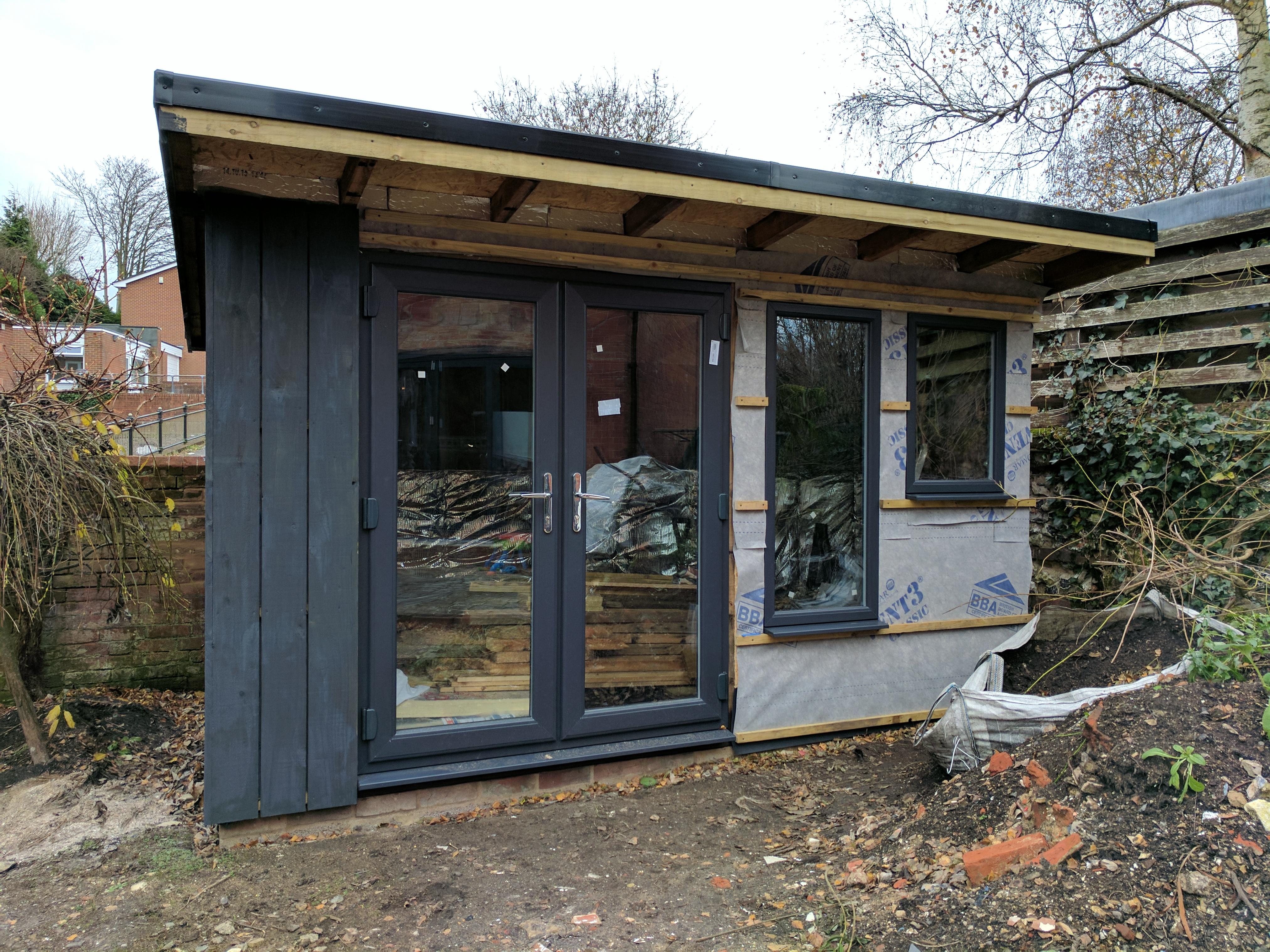

The ethos was to keep it good but cheap, use off the shelf items from builders yards etc. I didn't take many pictures whilst we were building it, heres the few I can find...it was built as 4 wall frames which I bolted together then added a roof and a floor to. The floor joists rest on the concrete blocks with some DPM and treated with creasote (the proper stuff, not the replacement rubbish)
Obligatory hole in ground...
Foundations...
Blurry people doing things with power tools...
Nearly there...
Edited by MrMagic
Added photos
Our good friends at Wagner have also been along and worked their magic on the roof...
