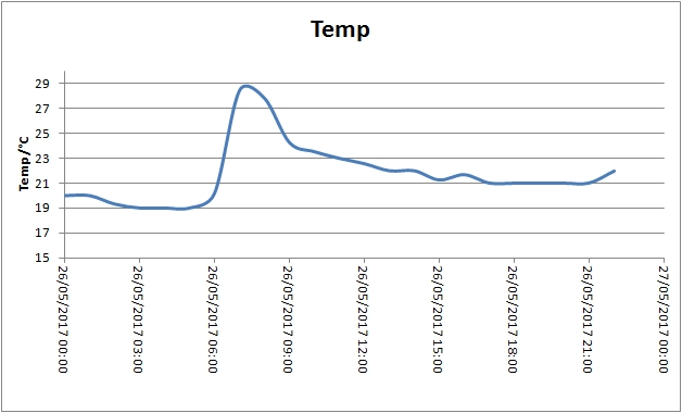

Stones Posted May 26, 2017 Posted May 26, 2017 With temperatures hitting 25C today this has been the first real test of our house in terms of overheating and how to manage excess heat. When I designed our house, I crunched the numbers, taking into account average and peak daily solar gain. Due to the large amount of SW facing glass that we have, I knew we were going to have some overheating, based on maintaining an internal air temperature of 21C. My number crunching indicated that summer overheating resulting from solar gain could be managed by means of the MVHR summer bypass, and opening a window and ventilating with cooler ambient air, and where appropriate, using blinds or drawing curtains. Up until now, ambient air temperature has always been several degrees lower than internal air temperature making it very easy to control how much of that solar gain we wished to retain. In practice we haven't had to do much in the way of control, as internal temps have not exceeded 23C in the main living areas, the bedrooms remaining 1C cooler as they are on the north side of our site. Today's challenge was how would the house perform without any cool ambient air or active cooling (albeit I do have the capability to cool our slab). I'll be honest and say I was quite concerned, but I'm glad to report that internal temperatures remained lower than external, peaking at 24C in the living areas, 1C cooler in the bedrooms. As ambient air temperature fell to 21C late this afternoon, the summer bypass kicked in and began to ventilate cooler ambient air inside (interestingly, when ambient air was higher than internal, the bypass didn't activate) and I opened two windows, one on the ground floor and the velux on the 1st floor mezzanine to create a natural draw through the house to purge some of the warm air out. This worked brilliantly and rapidly reduced the internal air temperature down to 22C, and shows how effective this method of control is. How did everyone else fare today?

Stones Posted May 26, 2017 Author Posted May 26, 2017 @ProDave We had mature trees that shaded the south west facing glazing in our last house -very effective they were too, sadly not something I have any hope of recreating up here. @Frogeye how long did it take before you noticed the cooling effect - hours? I purposefully left ours off to see what the worst case scenario would be (given the rarity of such a high temperature where I'm located). Back to normal ambient temp wise for us tomorrow so solar gain becomes useful once more.
