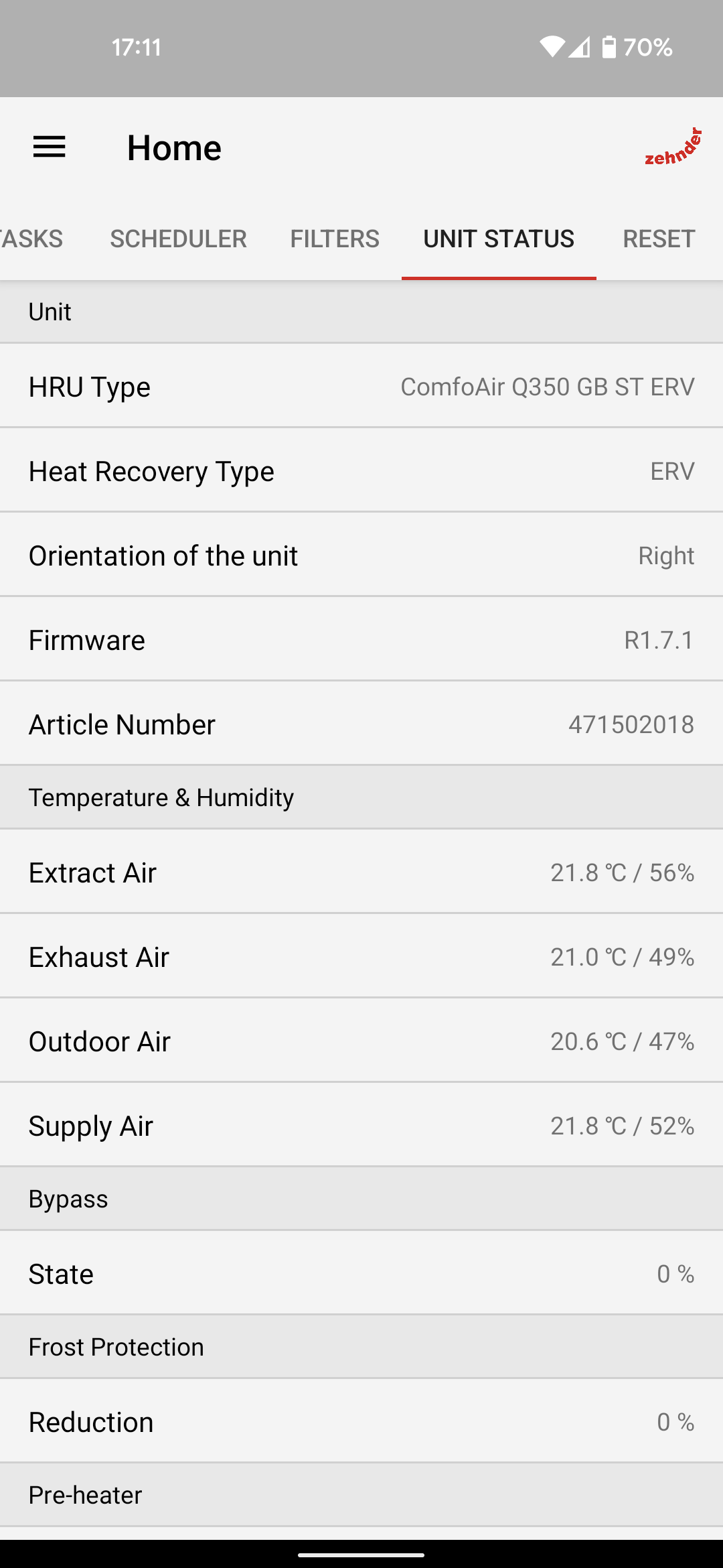

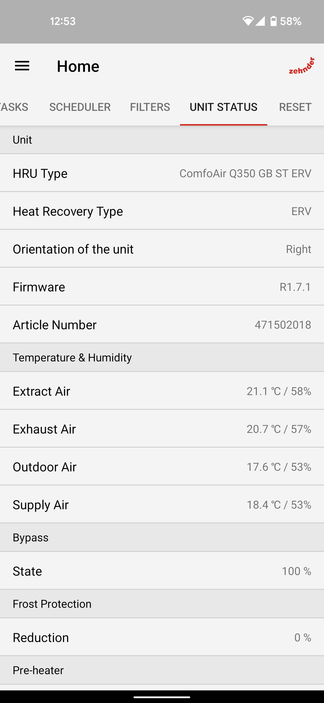

joth Posted June 20, 2022 Share Posted June 20, 2022 (edited) 4 hours ago, Adsibob said: My summer bypass is also set to automatic. I had a quick look at the status and it says: Bypass State: OPEN Inlet temperature: 19.7C Outlet temperature: 22C Does the fact that the bypass is "open" mean it is bypassing the heat exchanger and working as expected? No idea! What make/model is it, and what does the manual say? For reference here's the app for mine, around midday when it was still coolish outside and now later afternoon it's got too hot for bypass to be useful Bypass= 100% or 0% is fairly clear Edited June 20, 2022 by joth Link to comment Share on other sites More sharing options...
Adsibob Posted June 20, 2022 Author Share Posted June 20, 2022 30 minutes ago, joth said: No idea! What make/model is it, and what does the manual say? For reference here's the app for mine, around midday when it was still coolish outside and now later afternoon it's got too hot for bypass to be useful Bypass= 100% or 0% is fairly clear Thanks @joth I'm pretty sure that my Brink Flair 400's "Open" is equivalent to your Zehnder's "100". Link to comment Share on other sites More sharing options...

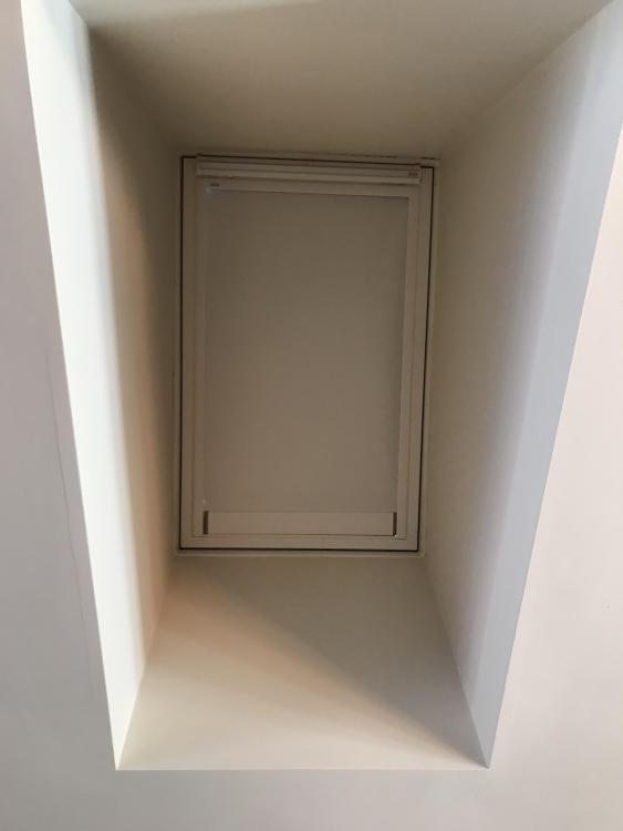

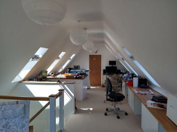

Adsibob Posted June 23, 2022 Author Share Posted June 23, 2022 (edited) So through some fairly diligent purging schedules, I’ve managed to get the temperature in most of the loft down overnight to about 17.5C or 18C. Depending on how sunny it is during the day, it rises to about 25C to 26.5C by the late afternoon. I think an external awning blind or roller shutter on the east facing Velux will help delay the heat rise to much later on in the day. But what is the difference in solar shielding performance between: an external awning blind like this and a significantly more expensive external roller shutter like this The roller shutter is complete blackout, whereas I think the awning blind cuts out about 85% of light. Will that equate to the cheaper awning blind being 15% less effective than the roller shutter at reducing solar gain? Edited June 23, 2022 by Adsibob Link to comment Share on other sites More sharing options...
Claire B Posted June 29, 2022 Share Posted June 29, 2022 On 23/06/2022 at 22:53, Adsibob said: So through some fairly diligent purging schedules, I’ve managed to get the temperature in most of the loft down overnight to about 17.5C or 18C. Depending on how sunny it is during the day, it rises to about 25C to 26.5C by the late afternoon. I think an external awning blind or roller shutter on the east facing Velux will help delay the heat rise to much later on in the day. But what is the difference in solar shielding performance between: an external awning blind like this and a significantly more expensive external roller shutter like this The roller shutter is complete blackout, whereas I think the awning blind cuts out about 85% of light. Will that equate to the cheaper awning blind being 15% less effective than the roller shutter at reducing solar gain? I've been after these Velux external shutters for a while now but I have 19 windows (largest size)! I have internal black out blinds on the bedroom Velux's but they don't keep the heat out, you have to stop it coming in through the window (using the external shutters). I've yet to hear from anyone that has them. It's a big investment and I've had no luck getting any of their 'approved fitters' round to quote. Link to comment Share on other sites More sharing options...
saveasteading Posted June 29, 2022 Share Posted June 29, 2022 Silver or white internal blinds help significantly: more than I can logically explain. I suspect the main difference is in reflecting a large proportion stright back out as light. Perhaps the local pocket of heat also resists transfer. Link to comment Share on other sites More sharing options...
JohnMo Posted June 29, 2022 Share Posted June 29, 2022 Black is great at absorbing heat, not sure if you have a black coating out the outside face of the blackout blinds. We also have white internal blinds and they have a great effect at keeping the sun's heat at bay. Not as good as external blinds but can certainly keep the room cooler by 3 or 4 degrees when closed. Link to comment Share on other sites More sharing options...
