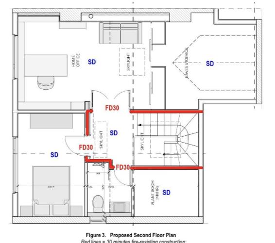

markocosic Posted June 19, 2022 Share Posted June 19, 2022 Floorplan? AC on landing is nice. Performance of splits materially exceeds performance of portable units. Don't oversize; do check the detail performance docs; question units without docs available. What is background "hotel load" that your gizmos and gadgets are contributing? Air2Air Performance.xlsx Link to comment Share on other sites More sharing options...

Adsibob Posted June 19, 2022 Author Share Posted June 19, 2022 17 minutes ago, markocosic said: Floorplan? i don’t have a cross section to hand, but ceiling is quite high, about 3.1m and flat from the double doors to the left, whereas it drops diagonally at a 45 degree angle from the double doors to the right. So the Velux is on the diagonal roof. 17 minutes ago, markocosic said: What is background "hotel load" that your gizmos and gadgets are contributing? I have one pc and one flat screen monitor in the “home office” as it’s referred to on the plan. The pc does get a little bit warm to the touch, but not excessively and certainly not enough to warm up such a large room. plus one mobile phone and a MFC printer. Room was hot before I bought the printer. I really doubt the appliances are doing much to the room temp. Link to comment Share on other sites More sharing options...

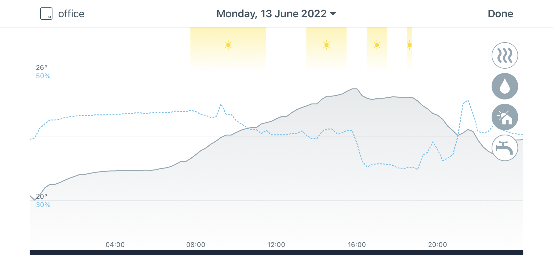

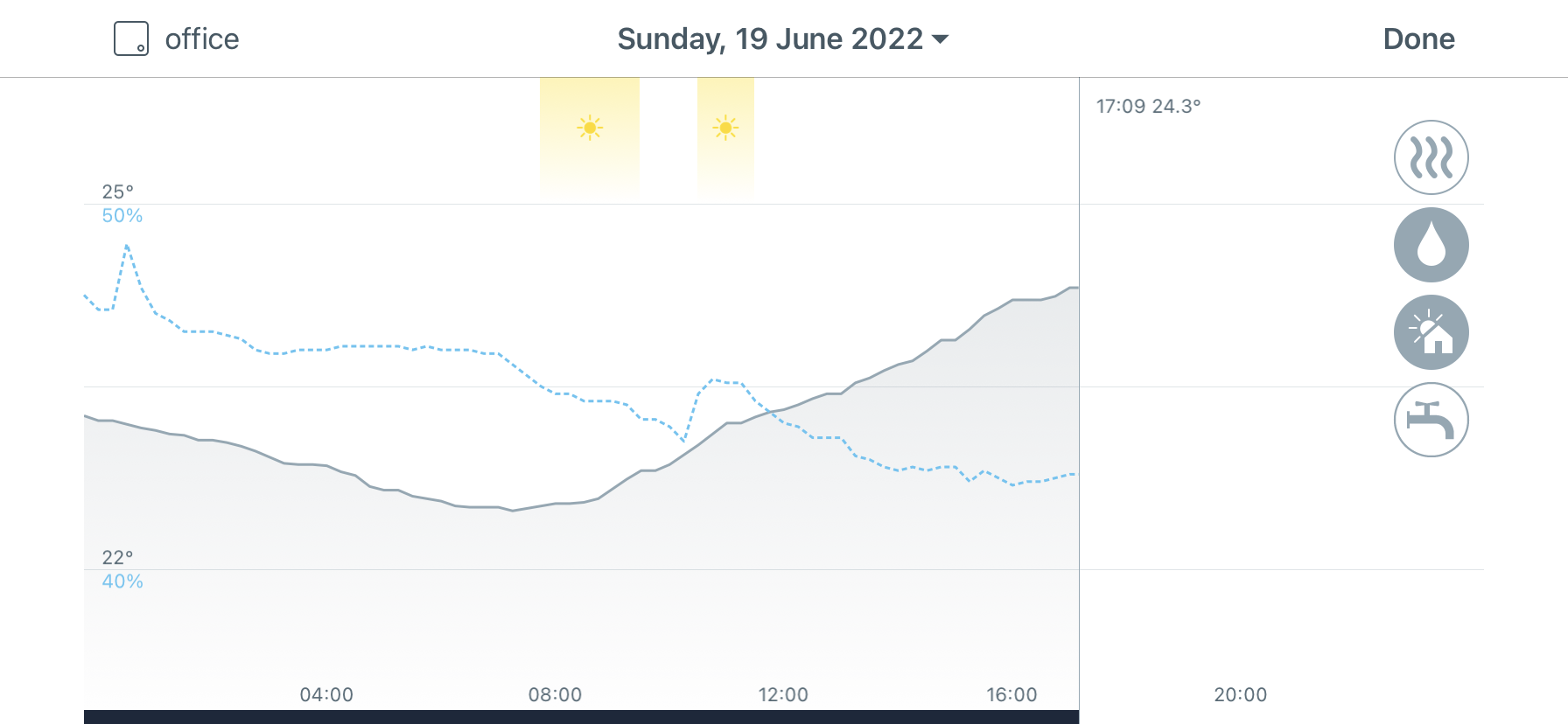

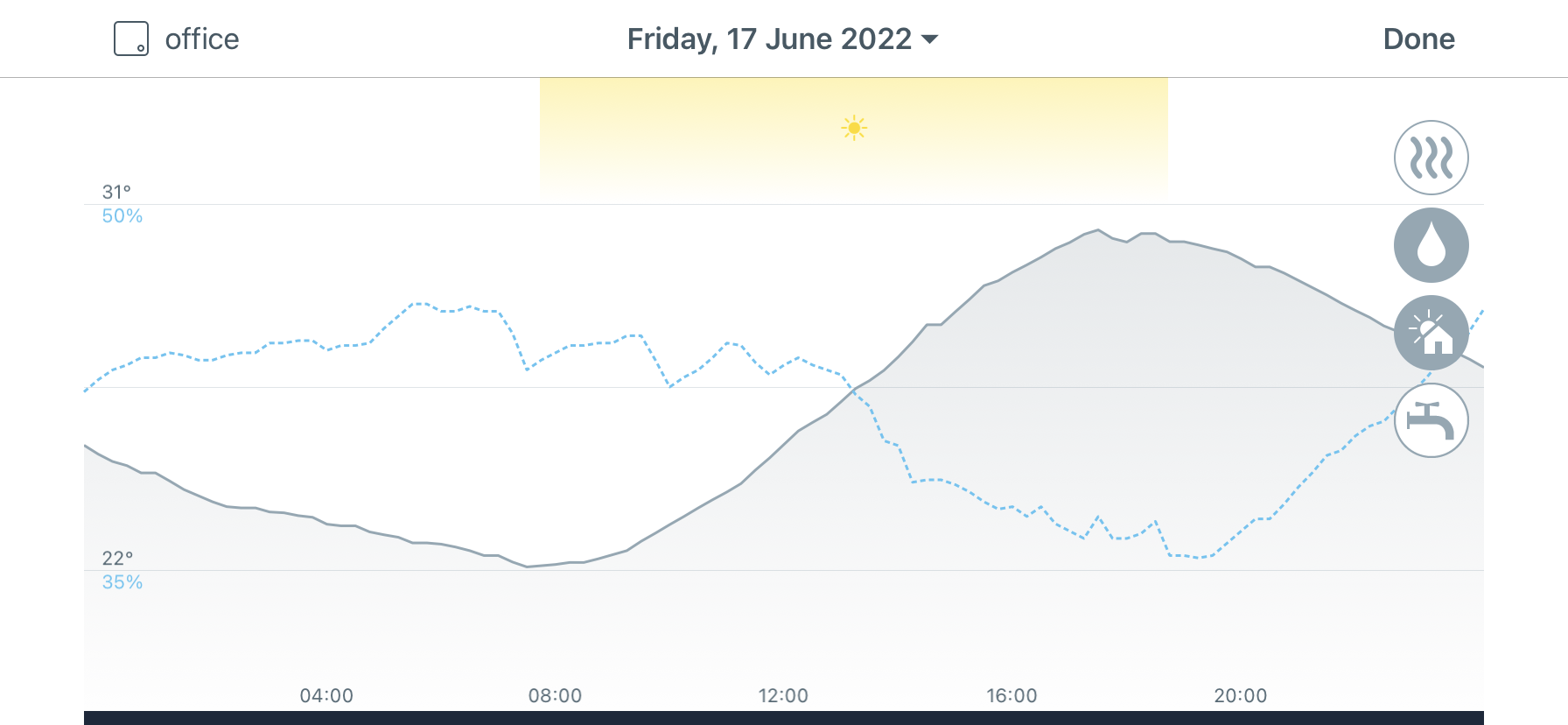

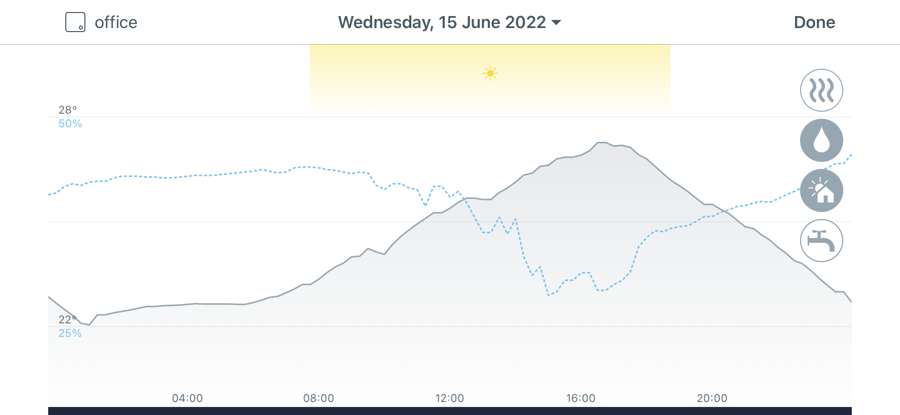

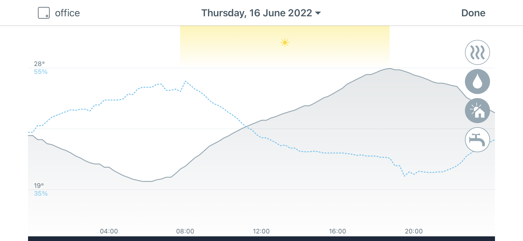

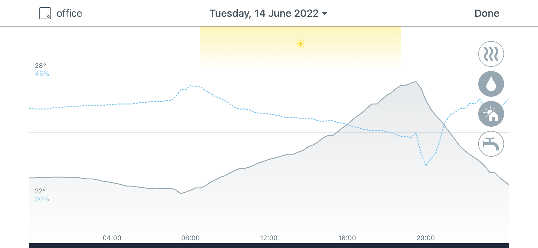

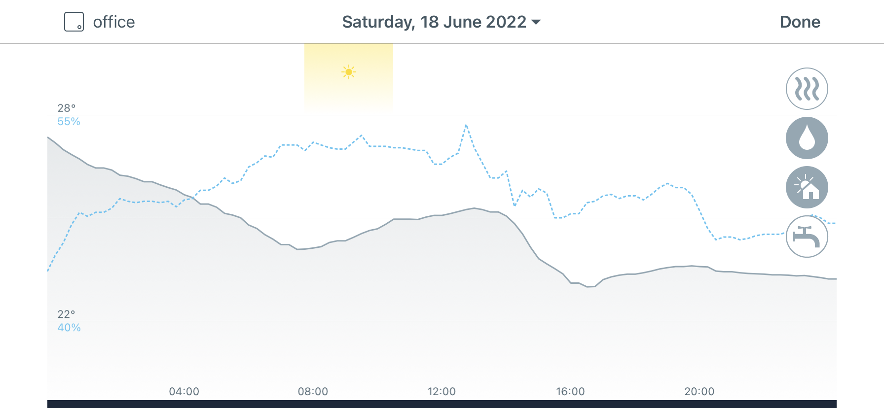

SteamyTea Posted June 19, 2022 Share Posted June 19, 2022 3 hours ago, Adsibob said: Just had a look at temperatures: the second floor rooms are currently 23.6 and 23.5 whereas the rooms directly underneath them are both 23C. So maybe it is more solar gain than internal heat, no idea really. Outside it’s currently 18C, although that’s based on the bbc as I don’t have an external thermometer. That is today's OAT, hasn't London just had 30⁰C plus for a couple of days? To only get internal temperatures in the low 20s when it is mid 30s outside seems a success to me. Link to comment Share on other sites More sharing options...
Adsibob Posted June 19, 2022 Author Share Posted June 19, 2022 1 minute ago, SteamyTea said: To only get internal temperatures in the low 20s when it is mid 30s outside seems a success to me. Have a look at the graphs I just posted, tell me if that is the picture of success? Am I expecting too much? Link to comment Share on other sites More sharing options...
