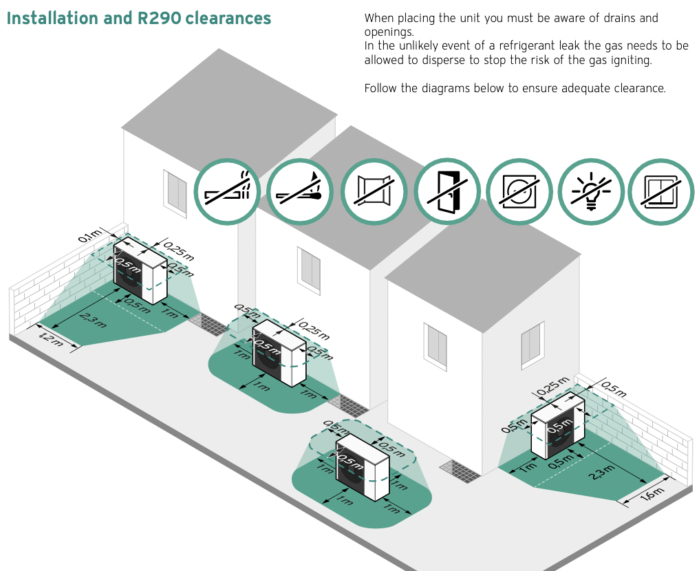

Radian Posted July 8, 2022 Share Posted July 8, 2022 49 minutes ago, HughF said: (personally, not r290 based, siting them is a faff) Are there any additional restrictions on Propane? Link to comment Share on other sites More sharing options...

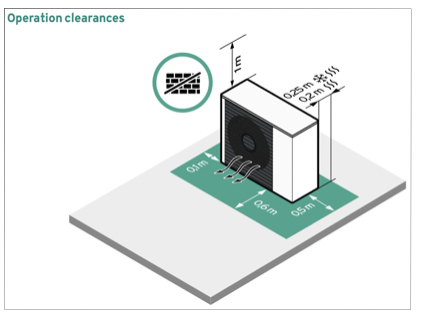

Dreadnaught Posted July 8, 2022 Share Posted July 8, 2022 1 hour ago, Radian said: Are there any additional restrictions on Propane? This will give you a flavour, at least for the AroTherm Plus model: Operational clearances: Propane related fire-risk clearances, especially from drains: 1 Link to comment Share on other sites More sharing options...
ProDave Posted July 8, 2022 Share Posted July 8, 2022 That's pretty much the same clearances for LPG bottle storage. Link to comment Share on other sites More sharing options...
Dreadnaught Posted July 8, 2022 Share Posted July 8, 2022 (edited) Interestingly, if read the manual correctly, the weight of Propane contained in the ASHP is just 0.9kg, which is rather smaller than the smallest usual gas cylinder (see below). And which, in liquid form, would, if my conversion is correct, would be just under 2 litre and so might fit in your kettle. This in turn would evaporate to form 520 litres of gaseous propane. Edited July 8, 2022 by Dreadnaught Edited to note that: Moreover, 2 litre of LPG converts in to 520 litres of gaseous propane. Link to comment Share on other sites More sharing options...
