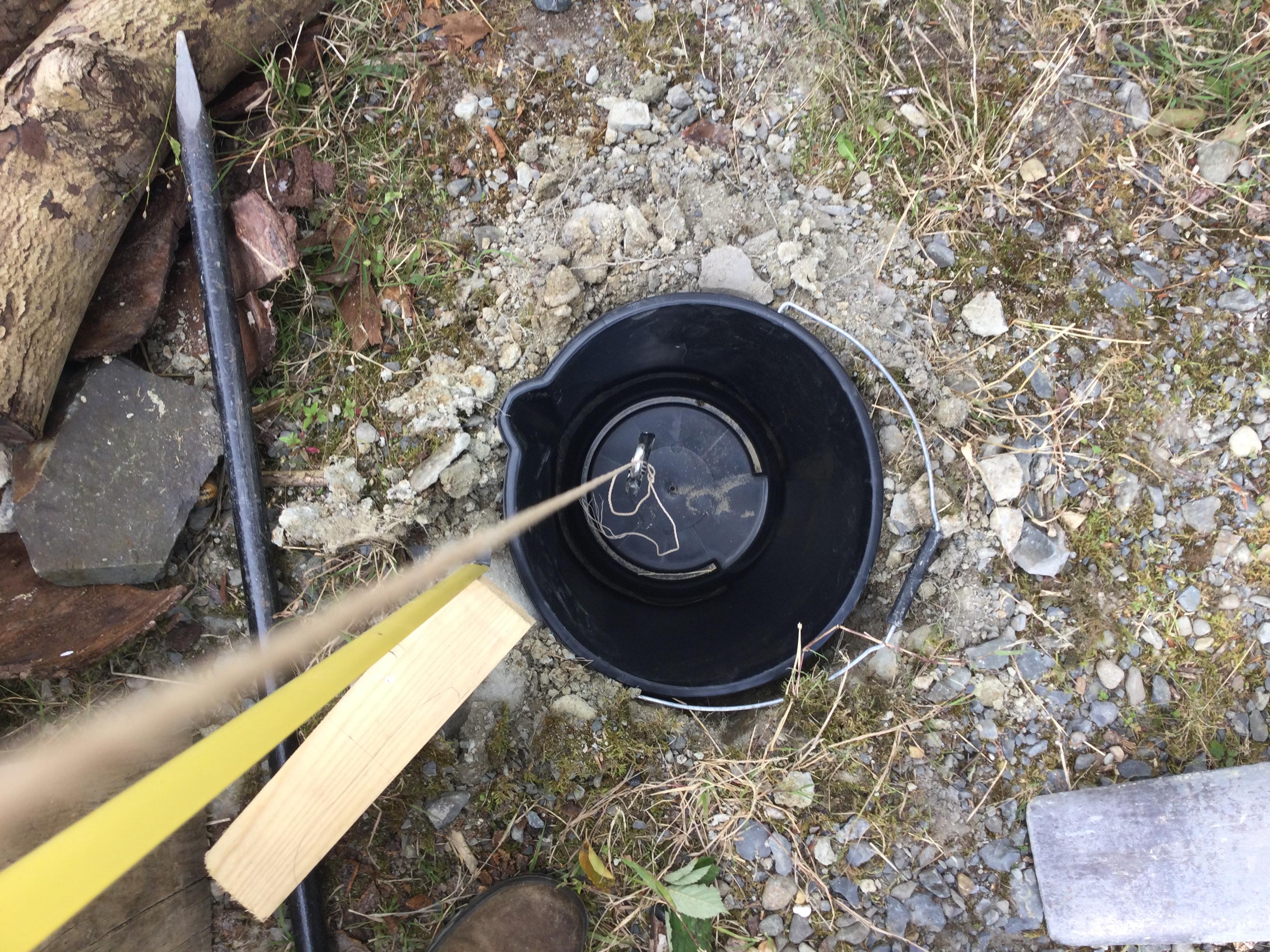

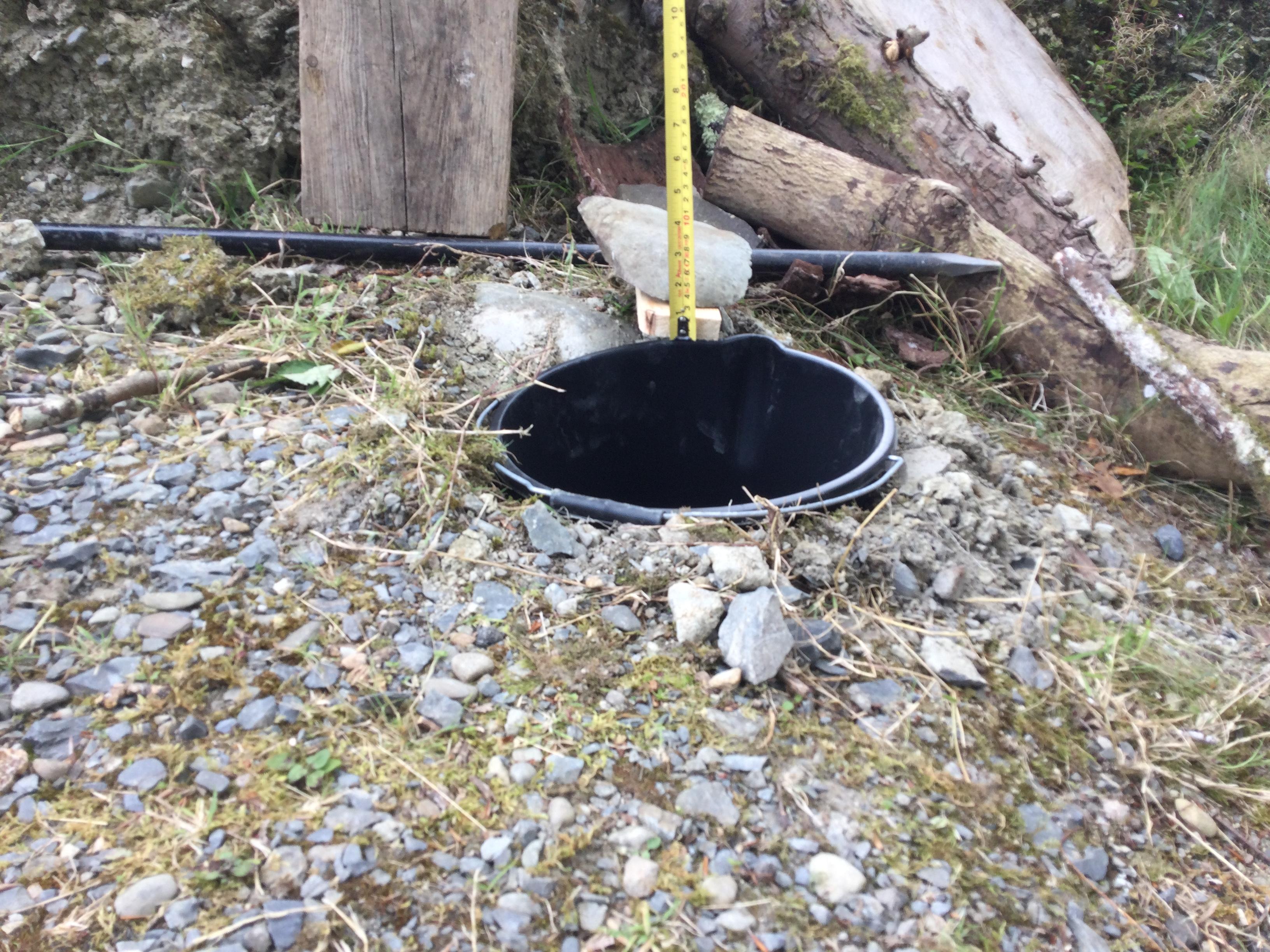

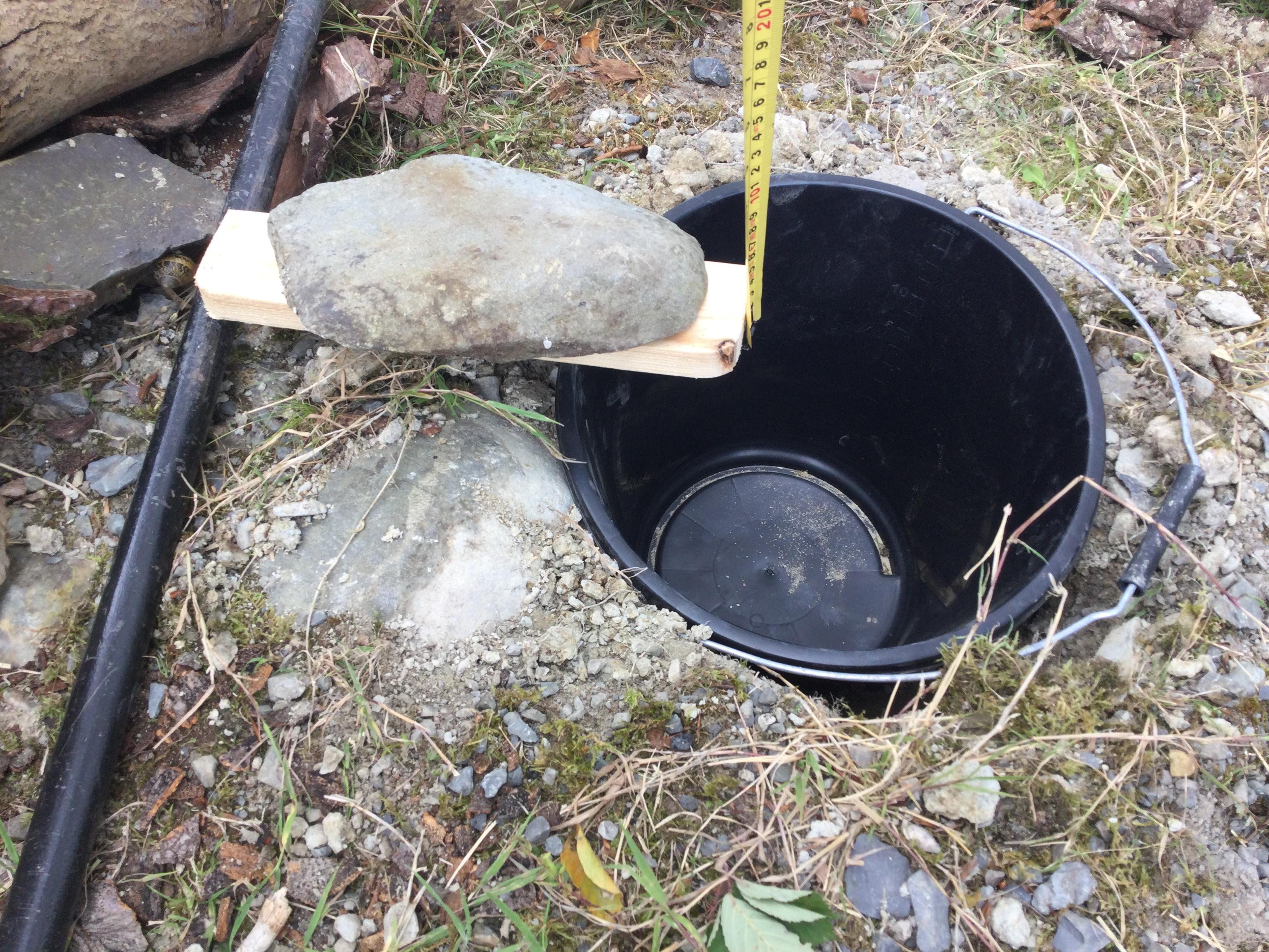

zoothorn Posted August 20, 2022 Author Posted August 20, 2022 47 minutes ago, Onoff said: 8mm st/st rod will be fine with stainless nuts and washers. Good ok. Right dug one hole. Is the approx idea, once shoe on, that the spike (8" long) say aim to go into concrete 6"? I don't think I'm aiming to get the full 8" in, & the shoe bottom to touch the top of concrete.. I can't do this as my bucket's a bit deep tbh. And is it ok slightly off centre into the concrete pad? I'm up against a huge stone one side of me hole. So my post spike will be 1/3rd point in, instead of centre. Thanks, zoot
zoothorn Posted August 20, 2022 Author Posted August 20, 2022 Point of spanner, as it were, is plumb line.
zoothorn Posted August 20, 2022 Author Posted August 20, 2022 My huge stone hampering getting bucket ideally over 3".. & the tape mark is both the extent of post (& fairly accurate spike position). So Tape end/ btm of galv bracket is 2" above bucket rim. Concrete will need to go right up to bucket rim.
