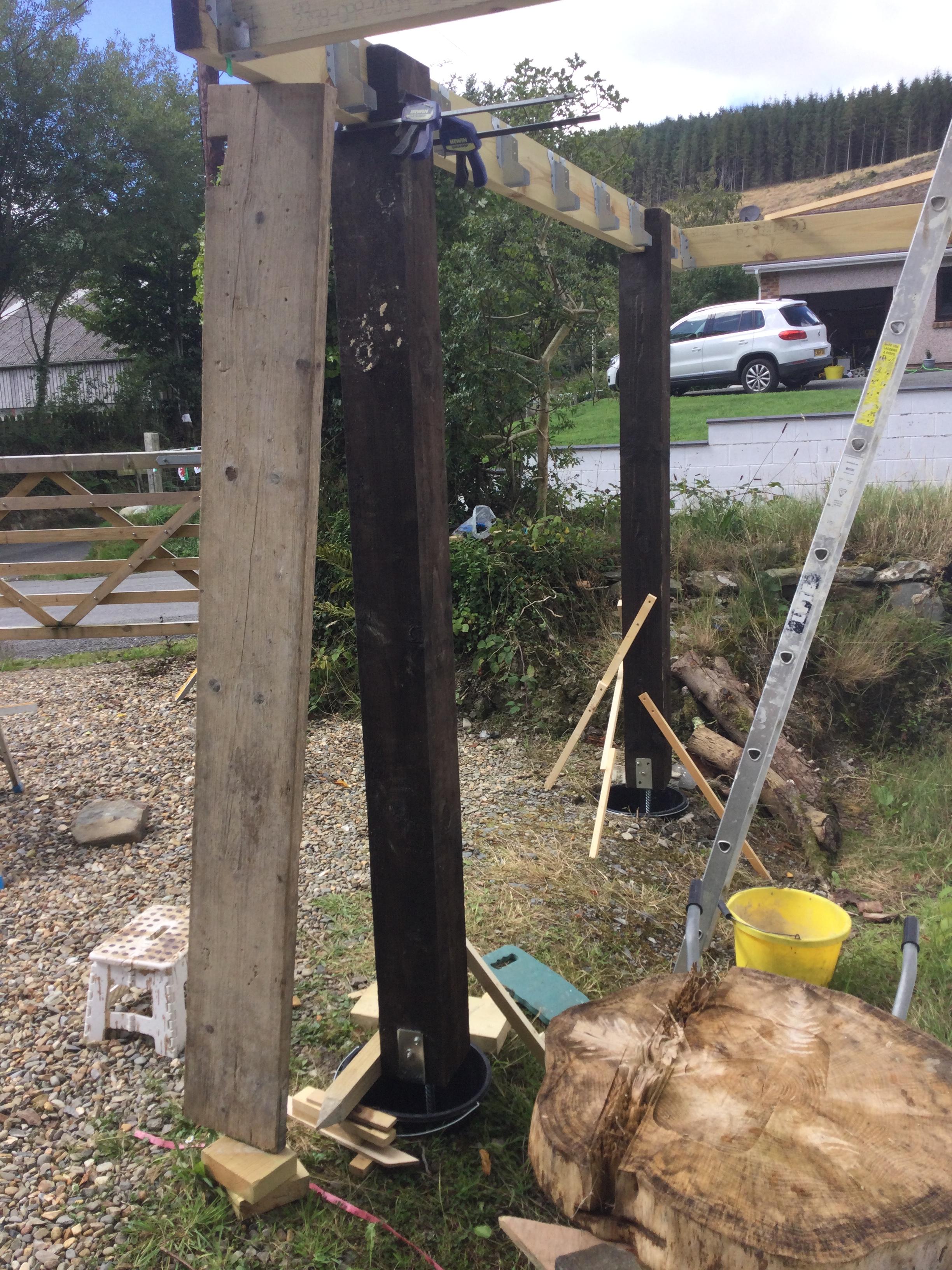

Hi chaps. notches cut y'day, couldn't use chopsaw/ mechanism got in the way.. dammit. So took most of the day using a circ saw handsaw & chisel.
Painted notches, shoe spikes on. So sort of ready to fix posts in place. Would the idea be:
1) offer up post, rest it on something, temporarily screw front beam into it.
Use batons fixed to lower area of post & fettle into place to get frame above it level.. & post plumb.
Then add hardcore ( into bucket, bottom jigsawed out).
Ready for postcrete.
? I can't quite do Onoff idea of resting spike onto a slate or so, lying on hardcore.. as I'd need to fill each bucket 2/3rds full of hardcore, in order to get the slate high enough. Unless I'm not thinking right.
Thanks, zoot.

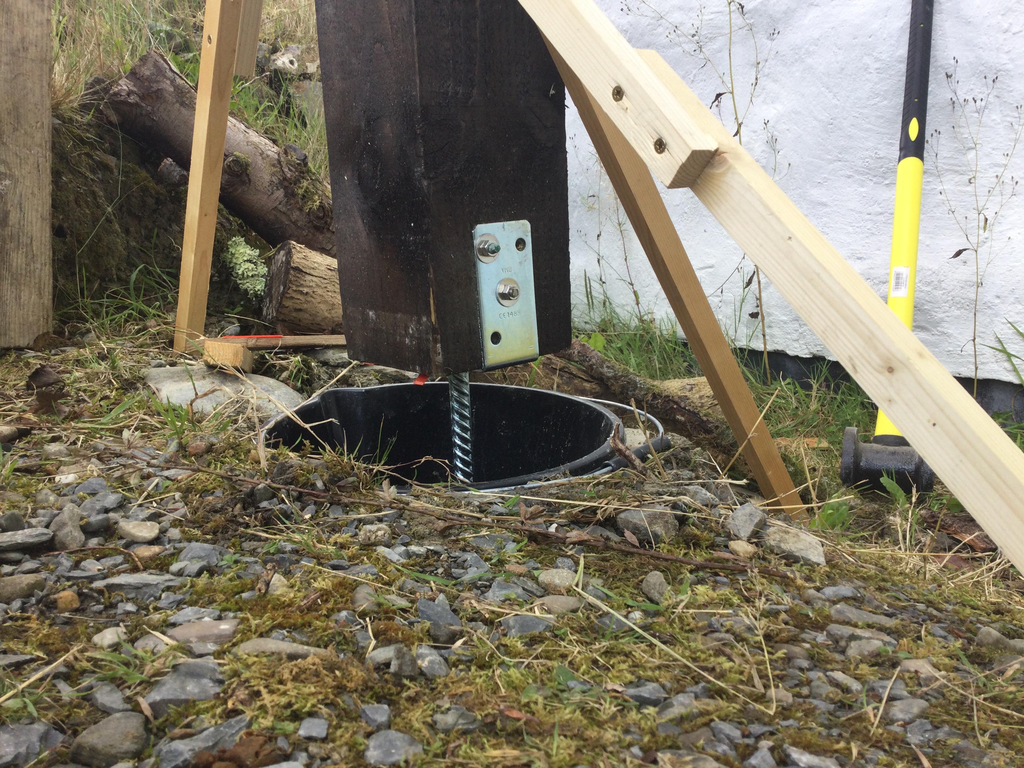

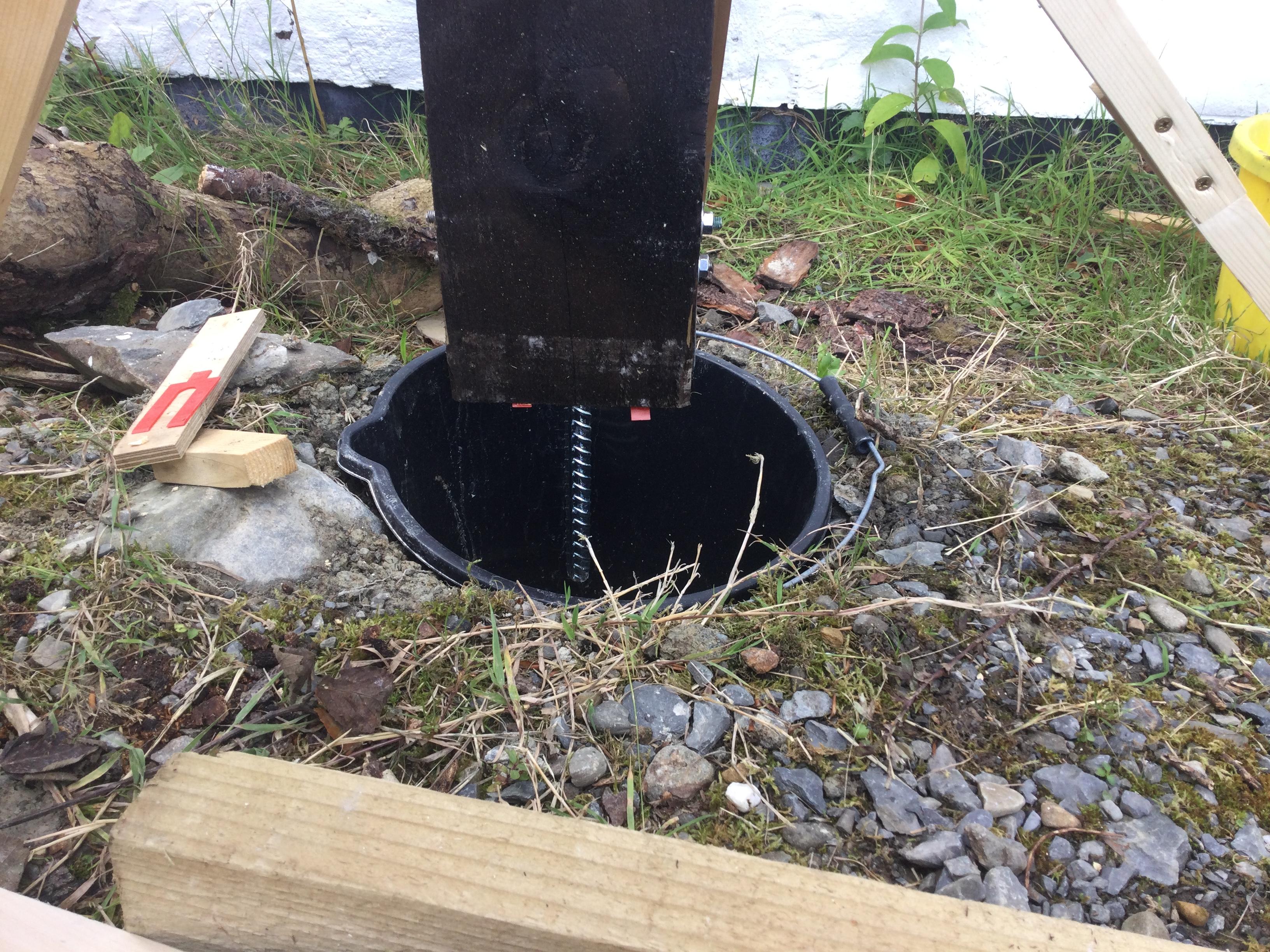

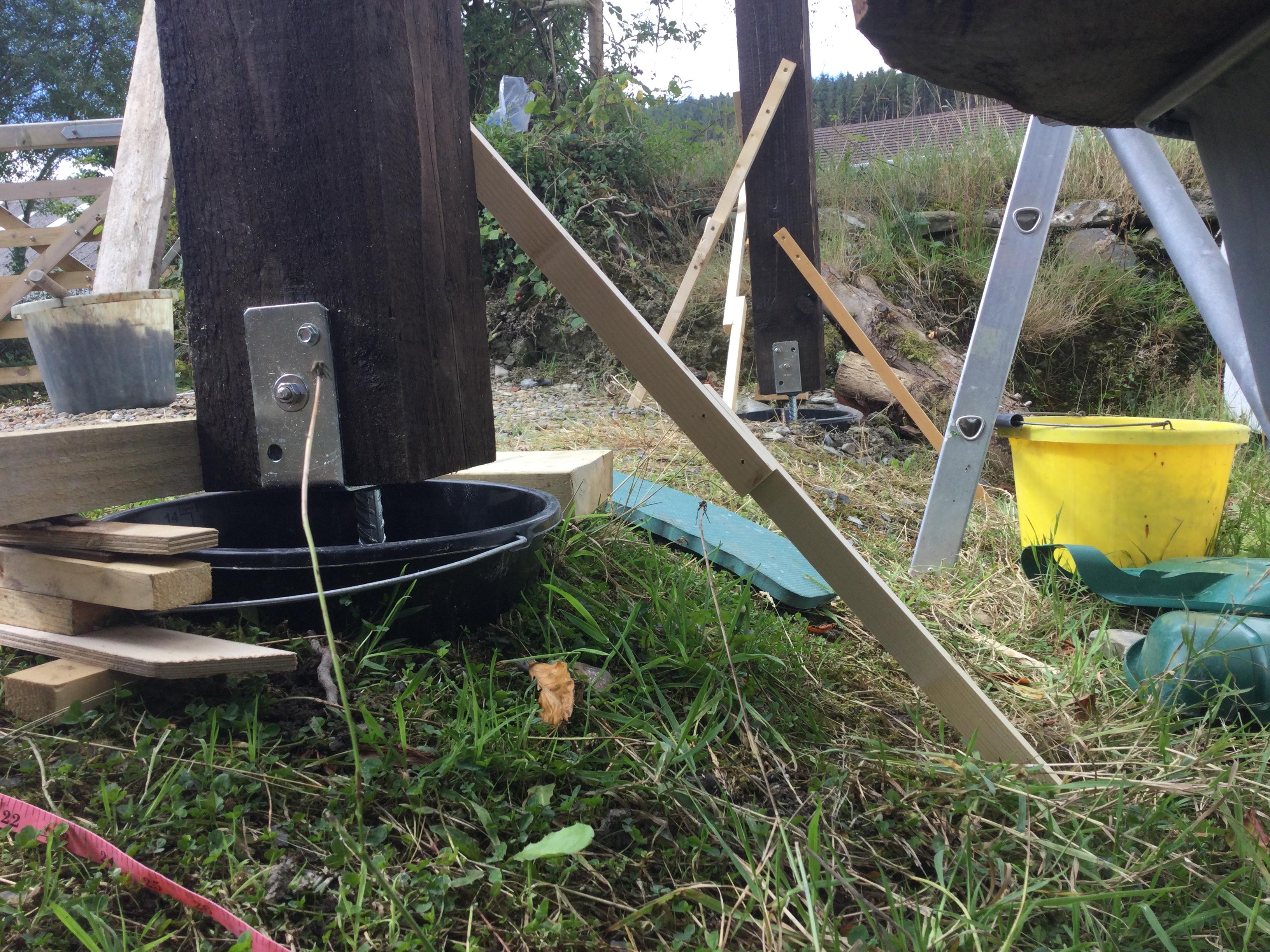

Back on board with job today. Ok got this far (all morning to get post set.. but it's not yet rock steady, even with my 3 tethers, because of the weight pulling down: your idea of the spike sitting on a slate is best.. but not easy for me alone to do). Post is temp screwed into frame: the only thing holding the post up. I might have to redo all this.. urgh.
Ok. The concern I have as it is, is my spike only hits halfway down bucket. If I fill concrete to very rim, I'll only be 5" spike in concrete. Spike is 8" long. I whacked the clay base firm, which in turn caused the bucket to go down an inch.. not helping.
Now I do have a bucket of hardcore. So, could I maybe: lift bucket up, pour in hardcore for an inch " bed", then rest bucket onto it? It now won't be wedged in though. Sloped bucket sides etc.. so this problem to solve.
Job you guys would do in 2 hours... taken me 1/2 a week!!
Thanks, zoot

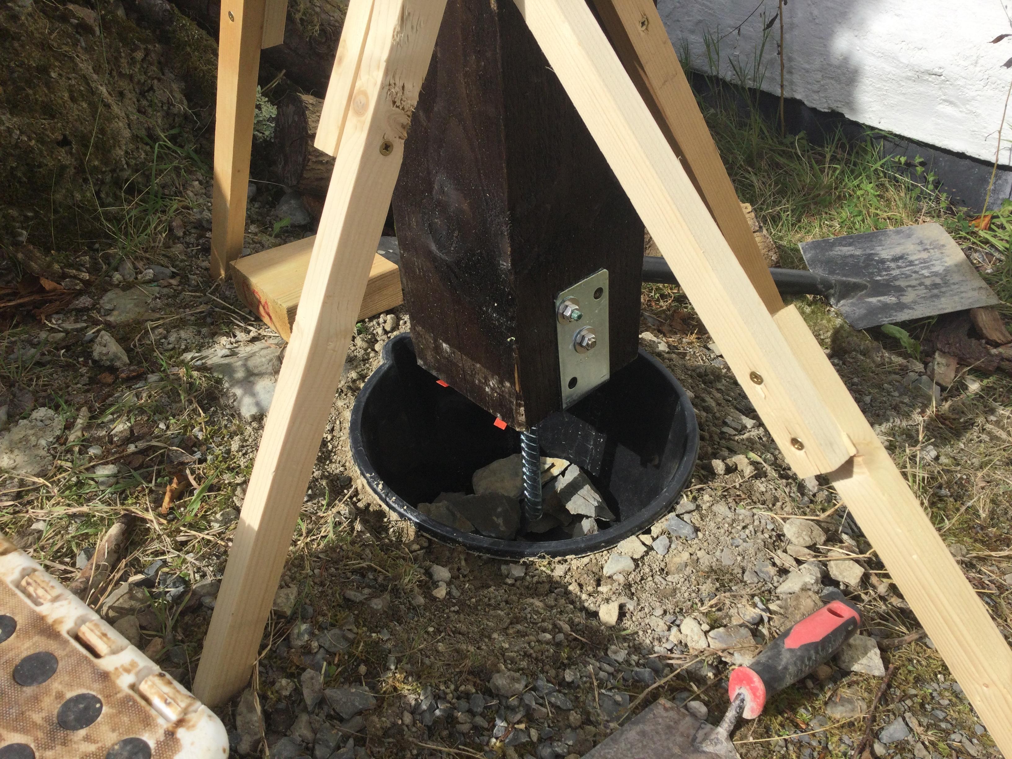

Bucket has base cutout. Now I have a bucket of hardcore
@Onoff need your help here/ anybody..
As you can see this bucket just ok if I fill it to brim (= spike set 6" into concrete).. but far bucket is a good inch lower. Means I need to raise it an inch, to get my (8" long) spike in 6" into concrete.
So do I put a 1" bed of hardcore in hole, rest bucket on, then fill in gap around bucket ( formed because of lifting it up a bit) with soil? Does this need to be really well compacted? After al, it's what the concrete block within the bucket, will rest against is my point. Thx zh

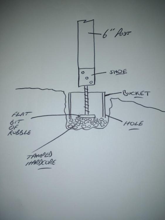

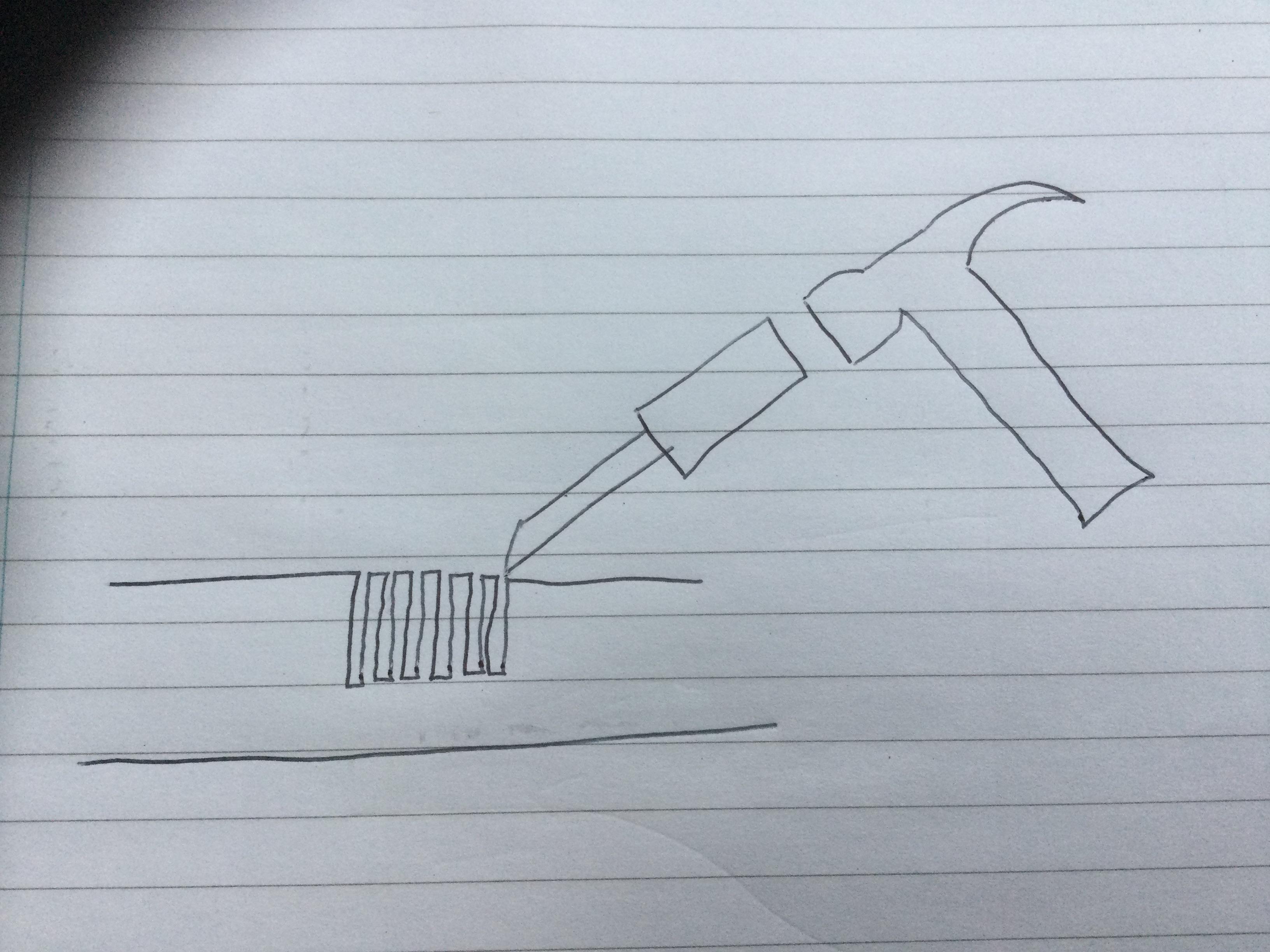

This drawing of mine from way back whenever. Can't remember if I specifically said but the idea was o take the bottom out if the bucket and use as a former...as I've drawn. I said then to tamp down hardcore in the base of the hole...you didn't but are talking about it now.
Get in with it, you'll do whatever you want.
Yes. Which is exactly what I've done Onoff.
