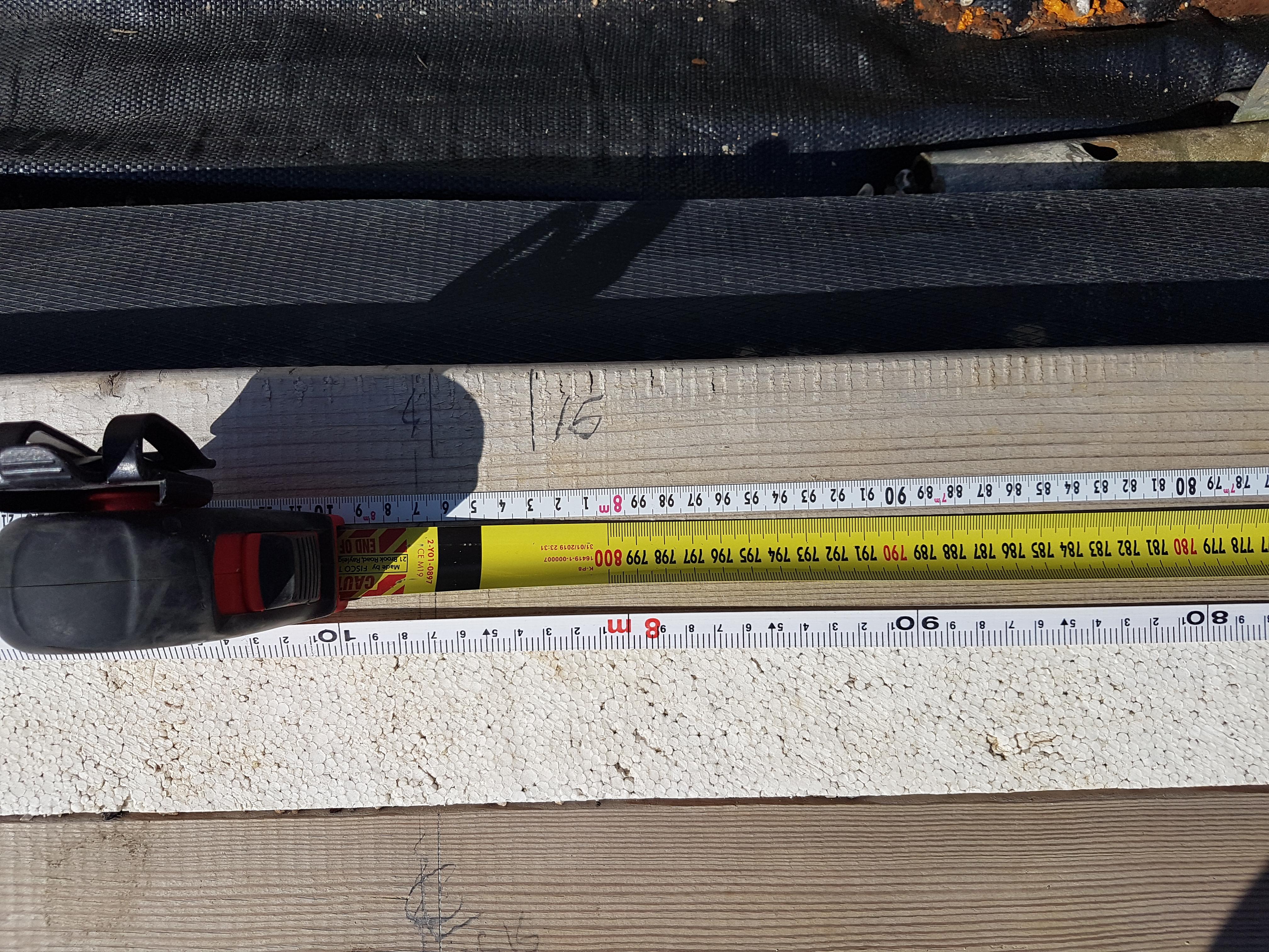

MikeSharp01 Posted June 7, 2022 Posted June 7, 2022 Get decent class 1 tapes and work with them. Here are two of mine, about 1mm out over 8m, against a non class one tape.
Marvin Posted June 7, 2022 Posted June 7, 2022 4 minutes ago, MikeSharp01 said: Get decent class 1 tapes and work with them. Here are two of mine, about 1mm out over 8m, against a non class one tape. For a class one it should be no more than 0.9mm over 8 meters in accordance with EC regulations 2004/32
SteamyTea Posted June 7, 2022 Posted June 7, 2022 6 minutes ago, MikeSharp01 said: about 1mm out over 8m Where they at the same temperature?
MikeSharp01 Posted June 7, 2022 Posted June 7, 2022 Yes - they were left out together to stabilise, maybe one absorbed more sun than the other.
