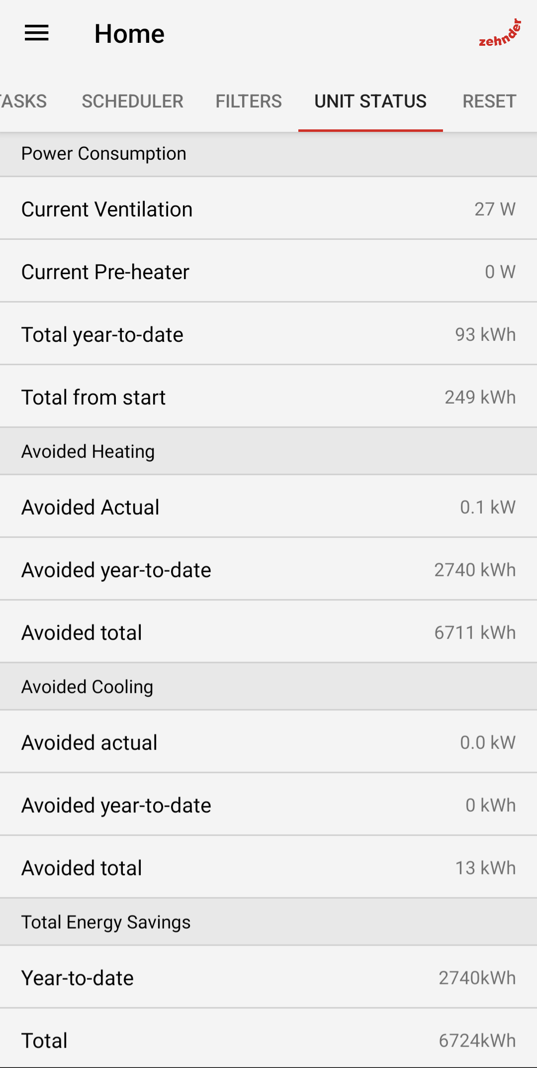

joth Posted June 9, 2022 Share Posted June 9, 2022 Ours was installed a bit over a year ago and here's the stats from its built in data logging. 249 kWh consumed running the ASHP 6724 kWh energy saved through heat recovery. So about £700 saved over one year and a bit (assuming our ASHP COP 3 would have provided the heat otherwise) 2 Link to comment Share on other sites More sharing options...
JohnMo Posted June 9, 2022 Share Posted June 9, 2022 You must have a quite large house I assume. You also need to factor in the cost of filters and service costs to get the total savings and a percentage of the hardware and install costs, based on expected life span, say 20 years. Link to comment Share on other sites More sharing options...
