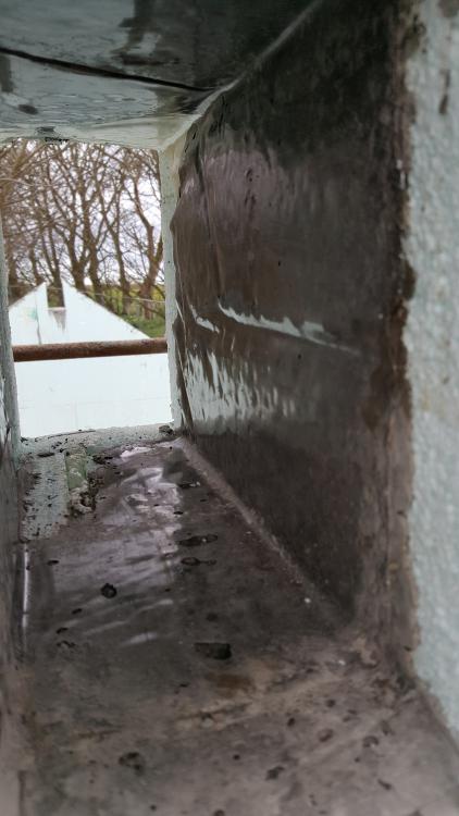

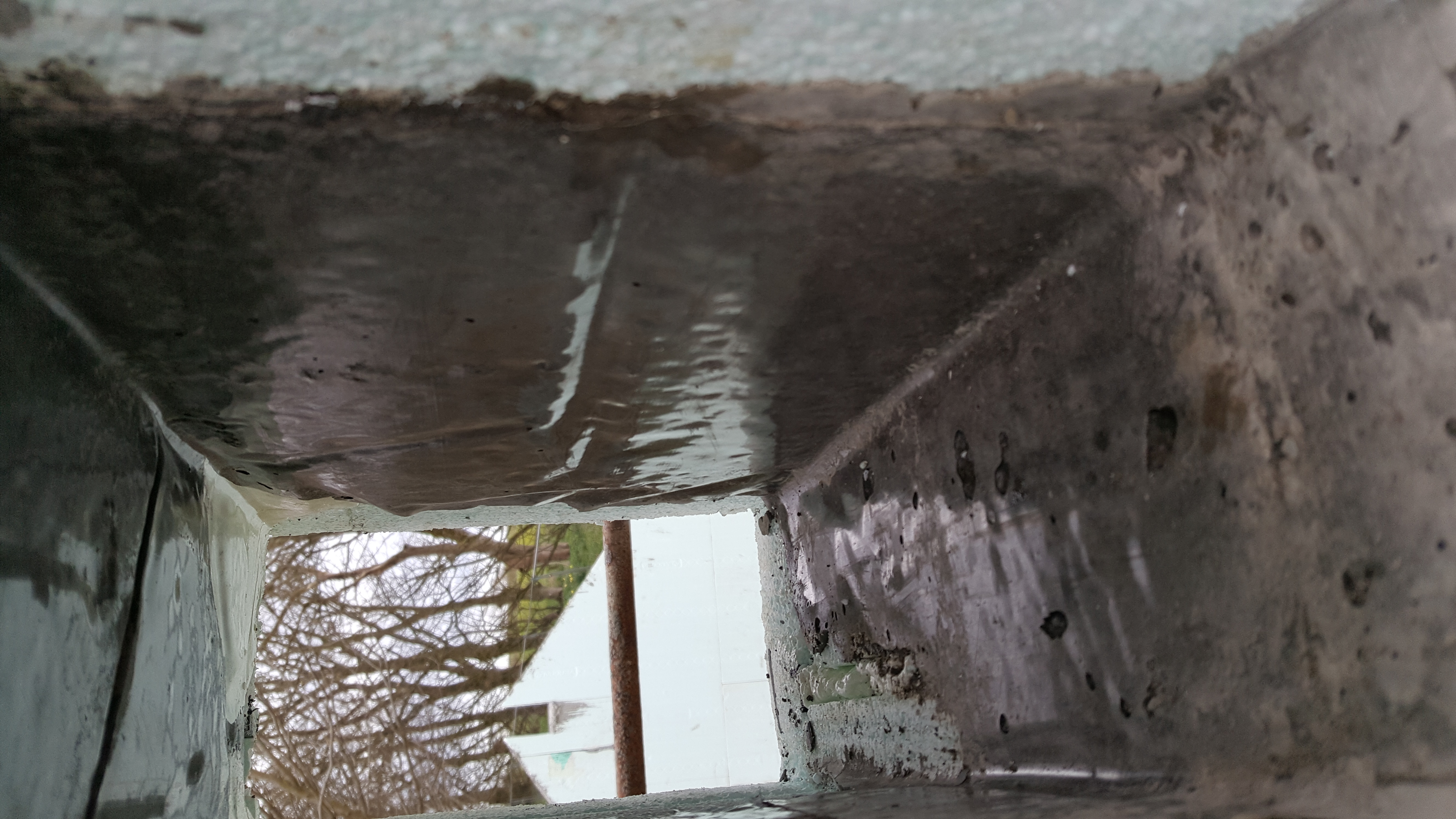

Alexphd1 Posted May 17, 2017 Share Posted May 17, 2017 We done 2 pours with nudara icf and used a poker both times (not sure if nudara recommend a poker) 1st time was a big 110v poker from the local tool hire, it was to big and you would be easy to damage/blow out the icf if you wasn't watching what you was doing. Second time we bought two used belle mega vib (with smallest head available) from flee bay. It done the trick is was surprising how much the concrete level dropped (air pockets coming out) after using the poker . I have attached a picture of a pocket in the icf to show the concrete consistency for a I beam which was approx 1m concrete drop from the top of icf. I also had a friend who used amvic icf who had to open up a lot of the icf for various fixings (cantilever stairs etc) who also used a poker and everything was perfect. I also was on the quad lock installer course and they also said use a poker. Link to comment Share on other sites More sharing options...

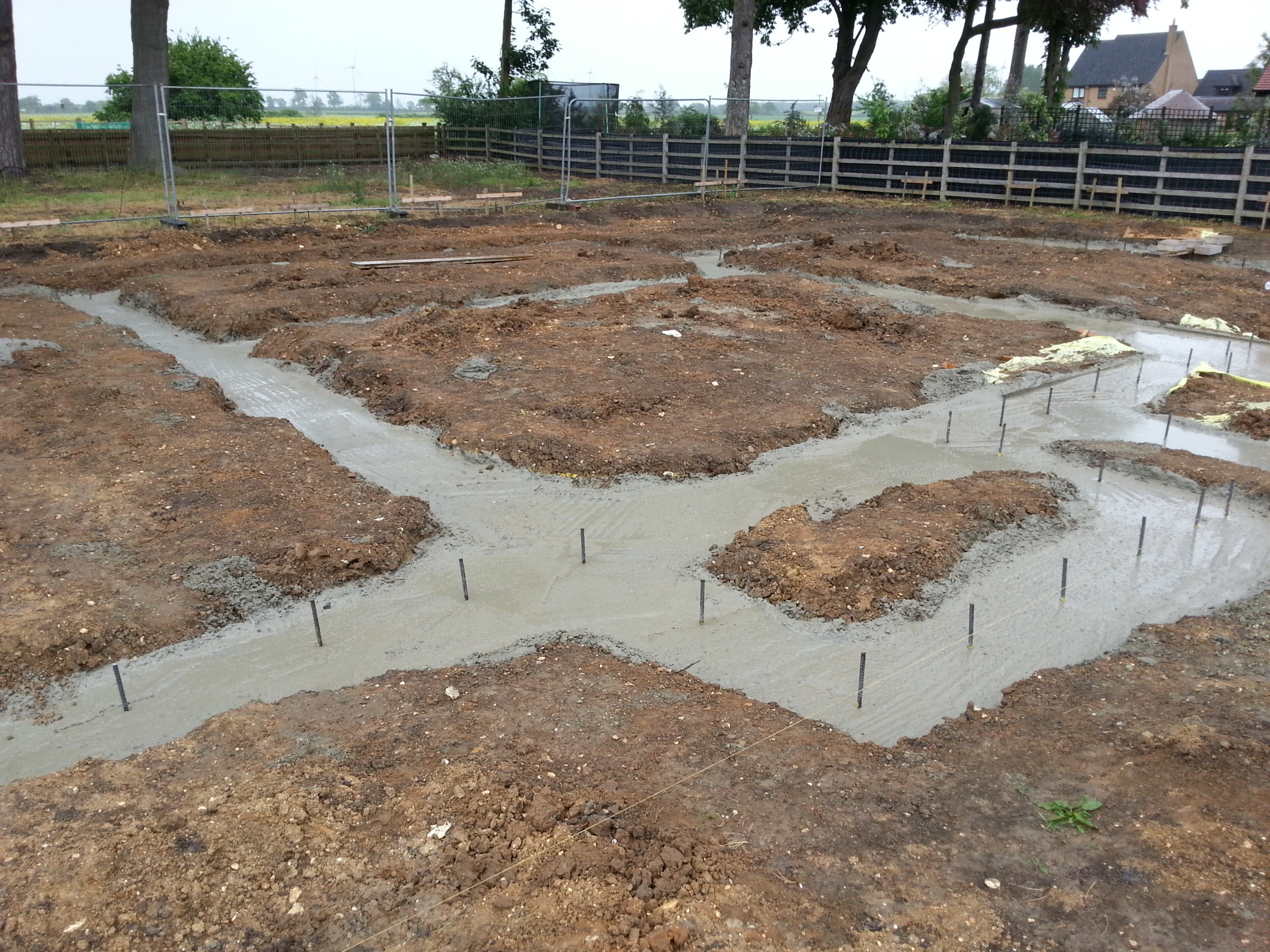

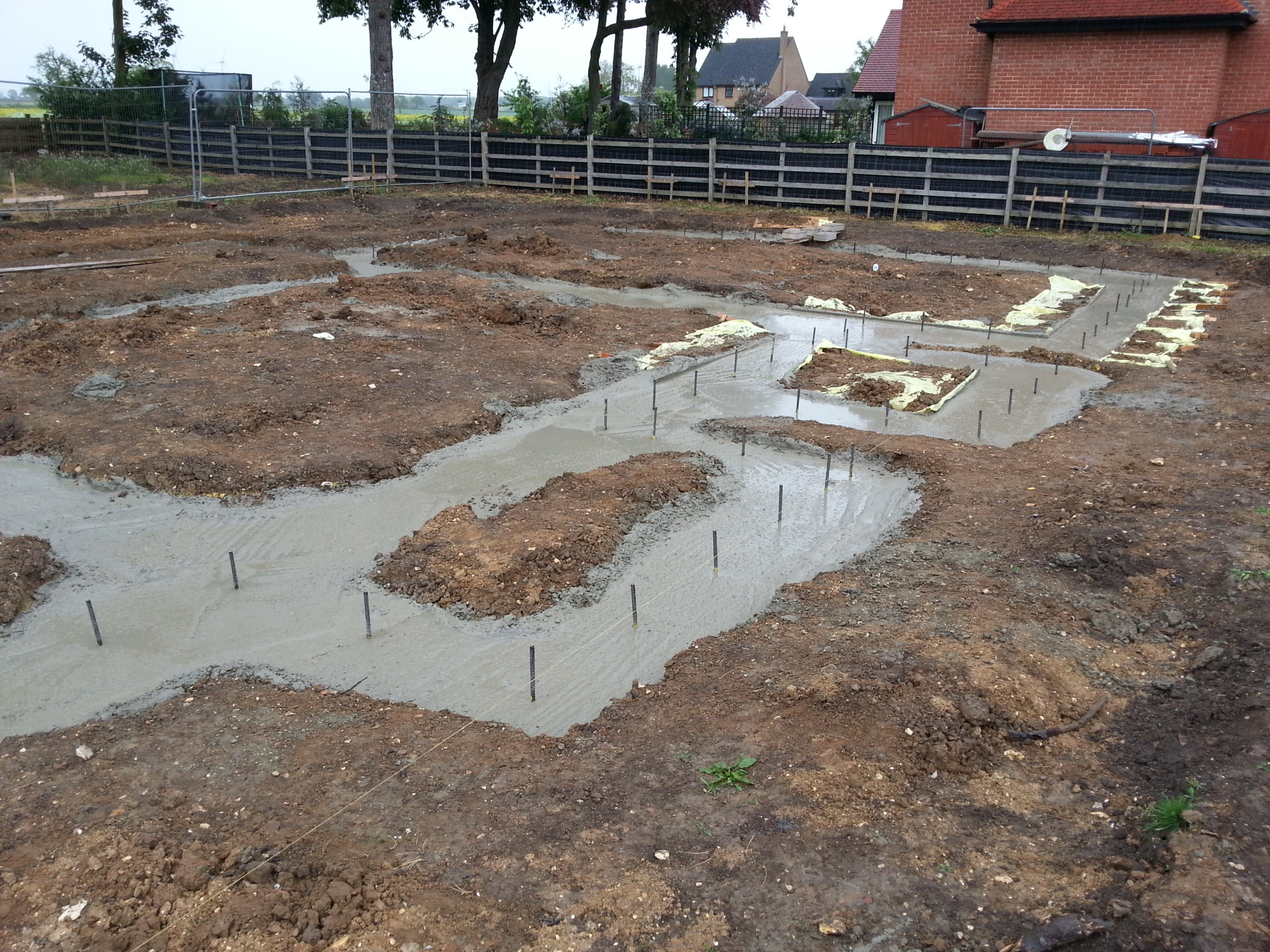

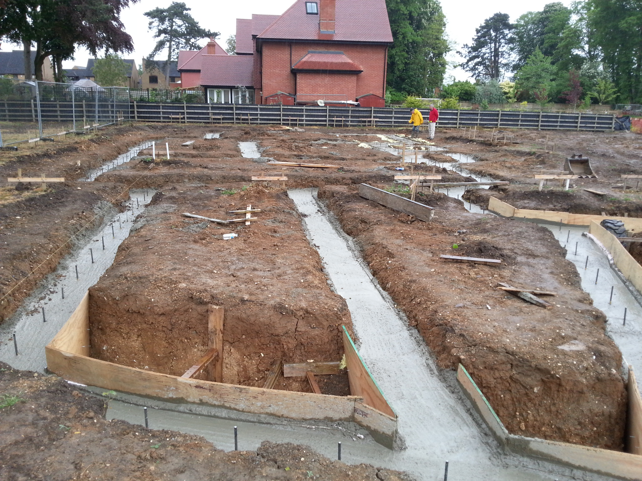

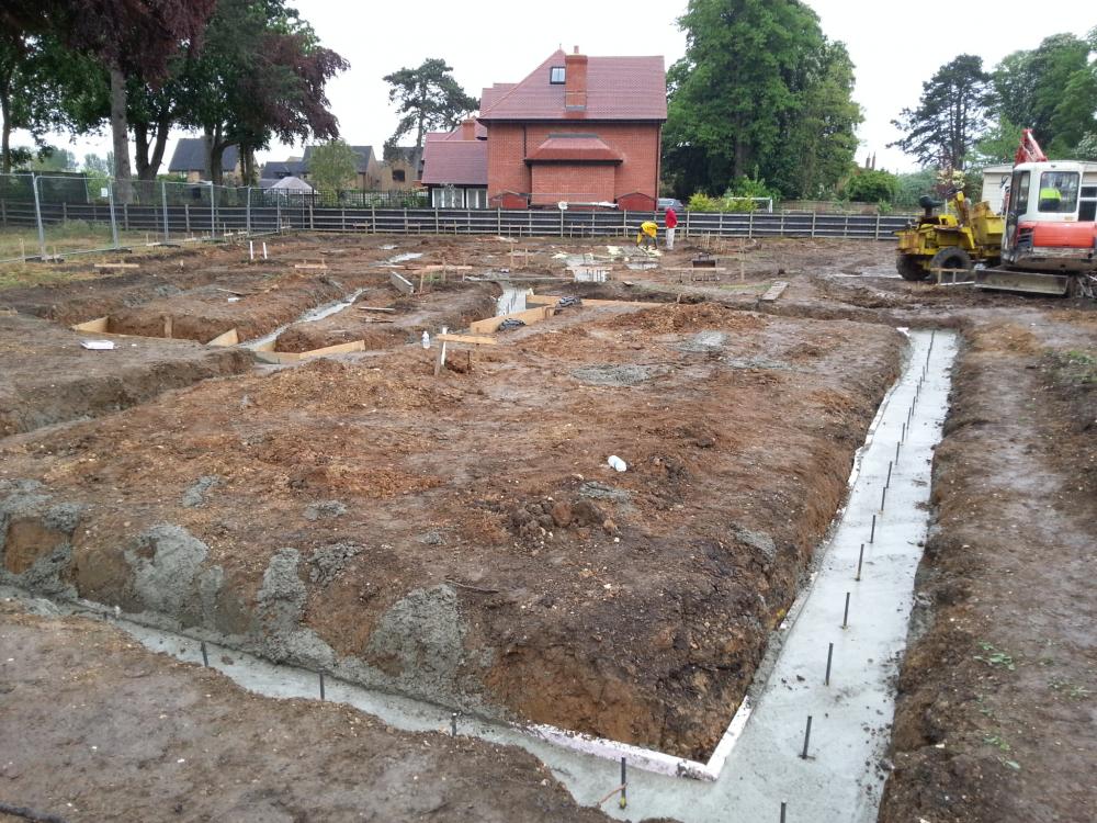

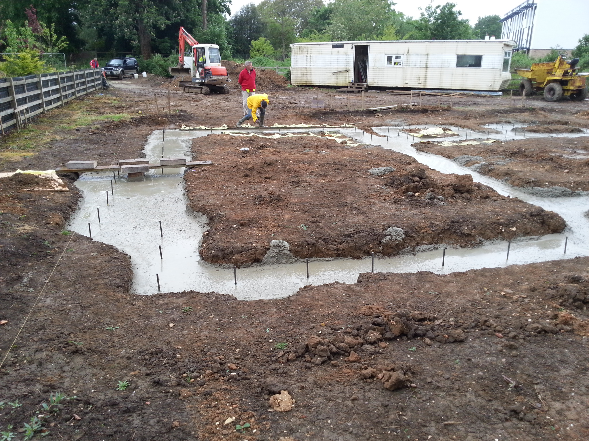

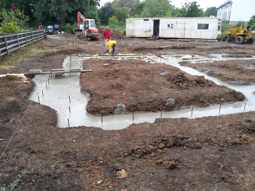

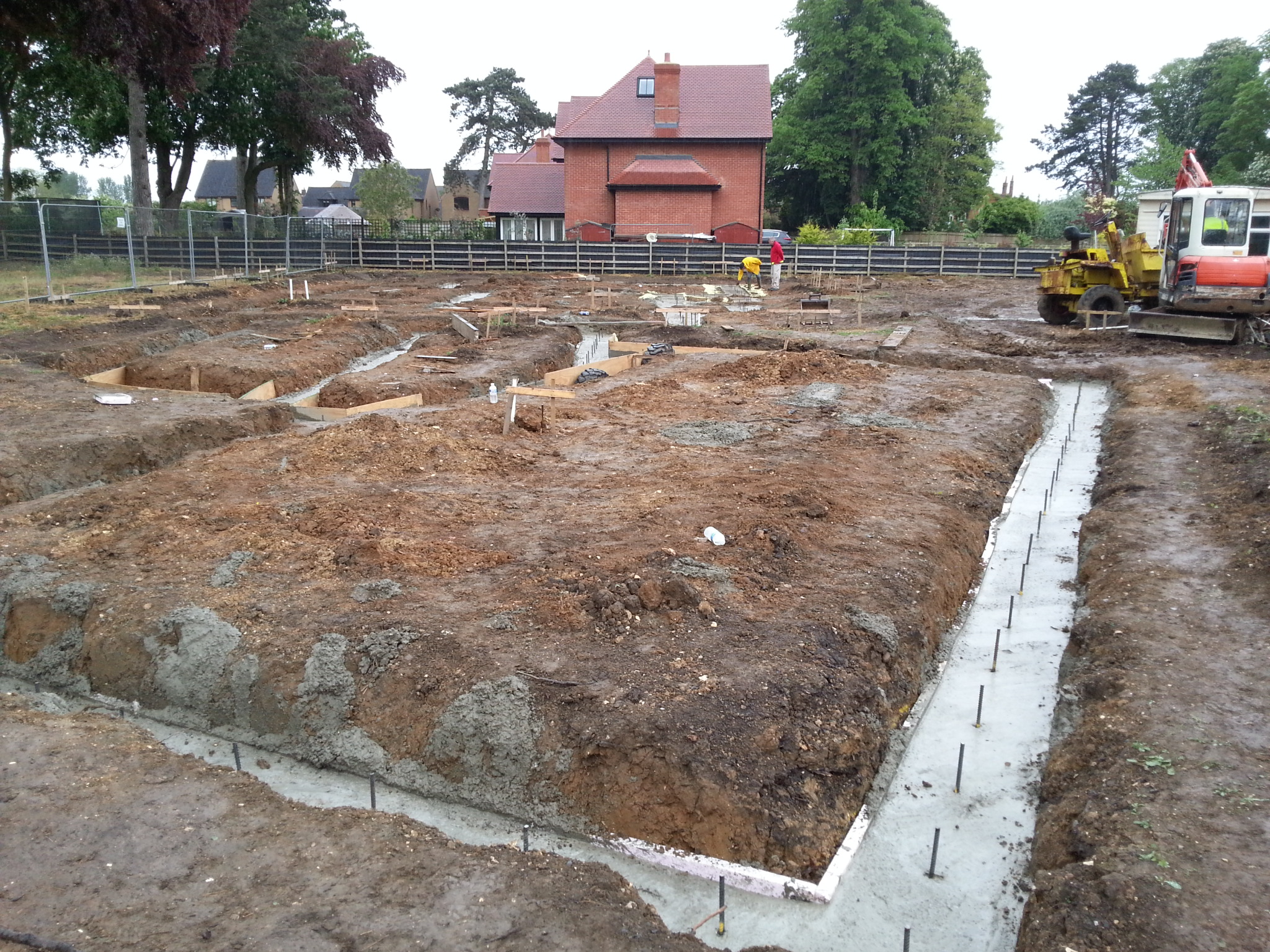

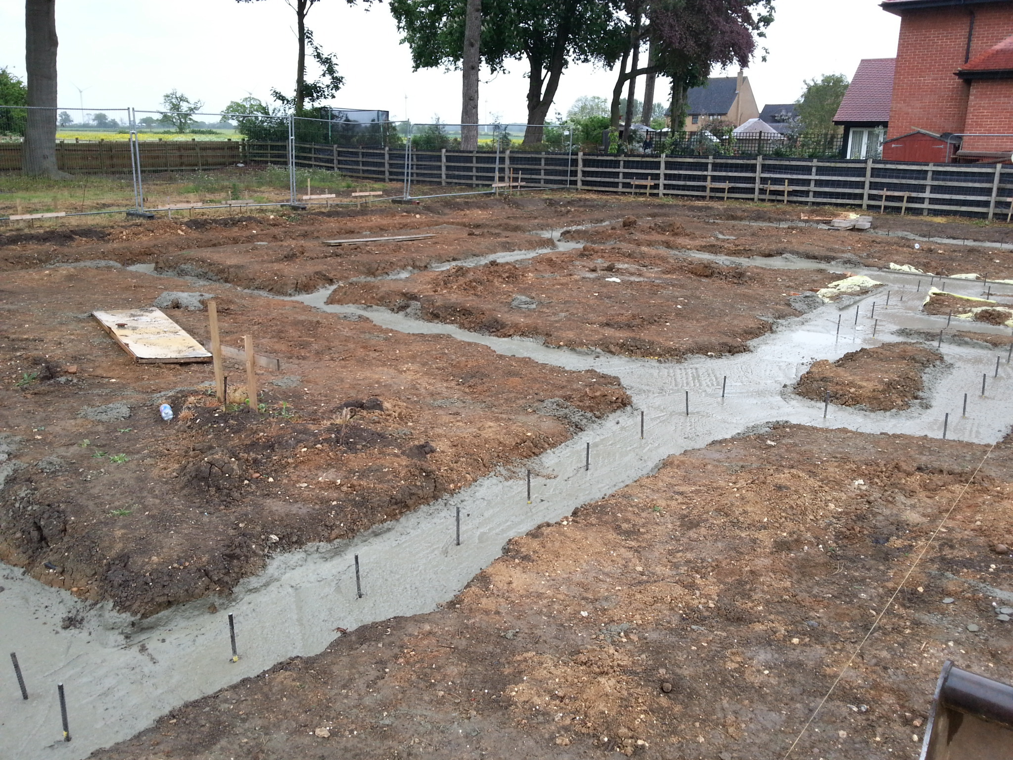

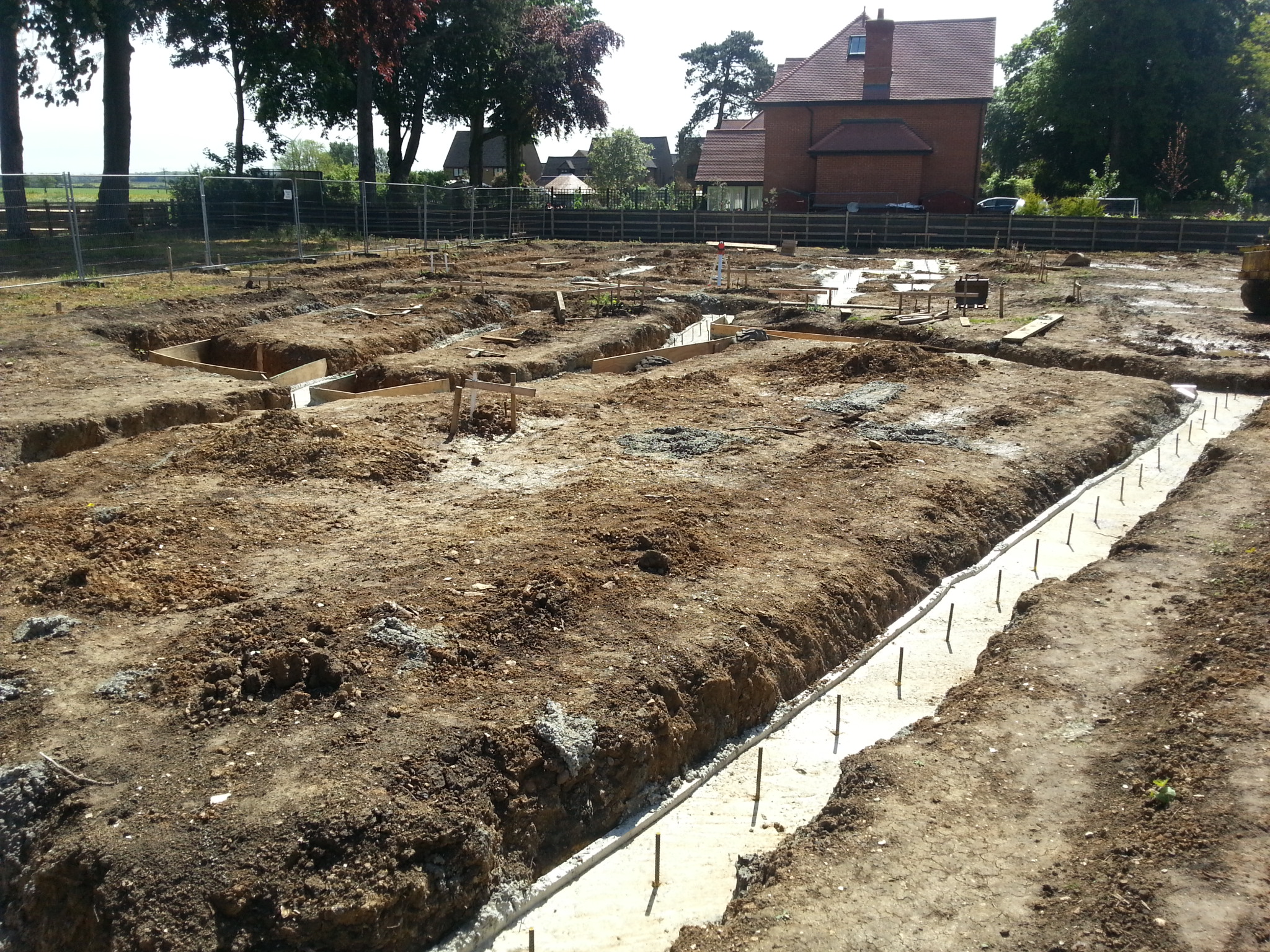

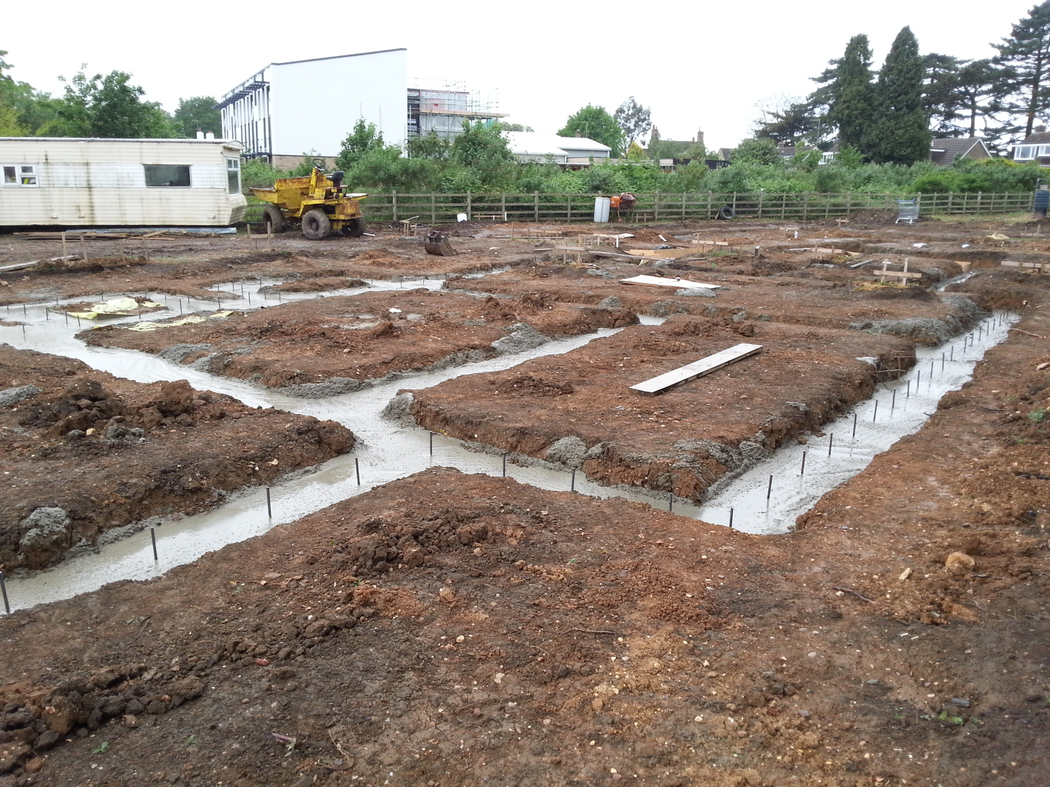

Vijay Posted May 19, 2017 Author Share Posted May 19, 2017 (edited) To say we're all exhausted is an understatement but it's done! Was a half 4.30 get up and finally sat down for something to eat (back at home) at around 9 last night. Ended up using 93.5m3 of concrete which was exactly 9 lorries. Drivers were friendly and brilliant but the pump guy was the most miserable unhelpful bloke I could have - and I'll be speaking to the concrete company about him this morning. I don't think they should have put him on my job if he wasn't a "team player", was so obvious he just cared about getting the concrete out of his pump - even asking the drivers to add water to speed things up. He ended up just dumping the crap out of his pump without asking where or for the bag we had, which left a horrible mess over the access road and has probably upset my neighbour (which we already don't get on). Levelling was quite a headache as with so many corners in the footings, things would slump a little. Then when there was too much water, you would have things level and then after half an hour, where it was level was no water which was evaporating. We did use a small vibrating poker but was far from mad with it, probably a 2 or 3 out of 10 in terms of how vigorous. Had one mate doing the rebars (400mm at the top) which saved us a big job at the end, as he was constantly behind us waiting for the concrete to set enough for them to stand up. Weather held off until the very end where we were packing up in the rain, but a massive relief to drive away with it all done Edited May 19, 2017 by Vijay 2 Link to comment Share on other sites More sharing options...

Oz07 Posted May 19, 2017 Share Posted May 19, 2017 how much linear meterage if trench have you got there?! Looks immense Link to comment Share on other sites More sharing options...

Vijay Posted May 19, 2017 Author Share Posted May 19, 2017 9 minutes ago, Oz07 said: how much linear meterage if trench have you got there?! Looks immense 162.5M Link to comment Share on other sites More sharing options...
Carrerahill Posted May 19, 2017 Share Posted May 19, 2017 (edited) 4 hours ago, Vijay said: To say we're all exhausted is an understatement but it's done! Well done. What are the excavated but not filled (boxed out with ply) parts of the trench about? I poured 2 mixed loads of concrete yesterday... Edited May 19, 2017 by Carrerahill Link to comment Share on other sites More sharing options...
Vijay Posted May 19, 2017 Author Share Posted May 19, 2017 They are where I had to move a few bits and rather than just fill with concrete that costs me, I shuttered them, then will remove the ply and back fill Link to comment Share on other sites More sharing options...
Carrerahill Posted May 19, 2017 Share Posted May 19, 2017 40 minutes ago, Vijay said: They are where I had to move a few bits and rather than just fill with concrete that costs me, I shuttered them, then will remove the ply and back fill I figured it was a concrete saving initiative but I figured I would ask in case there was some special reason - access to your fallout shelter or something. Link to comment Share on other sites More sharing options...

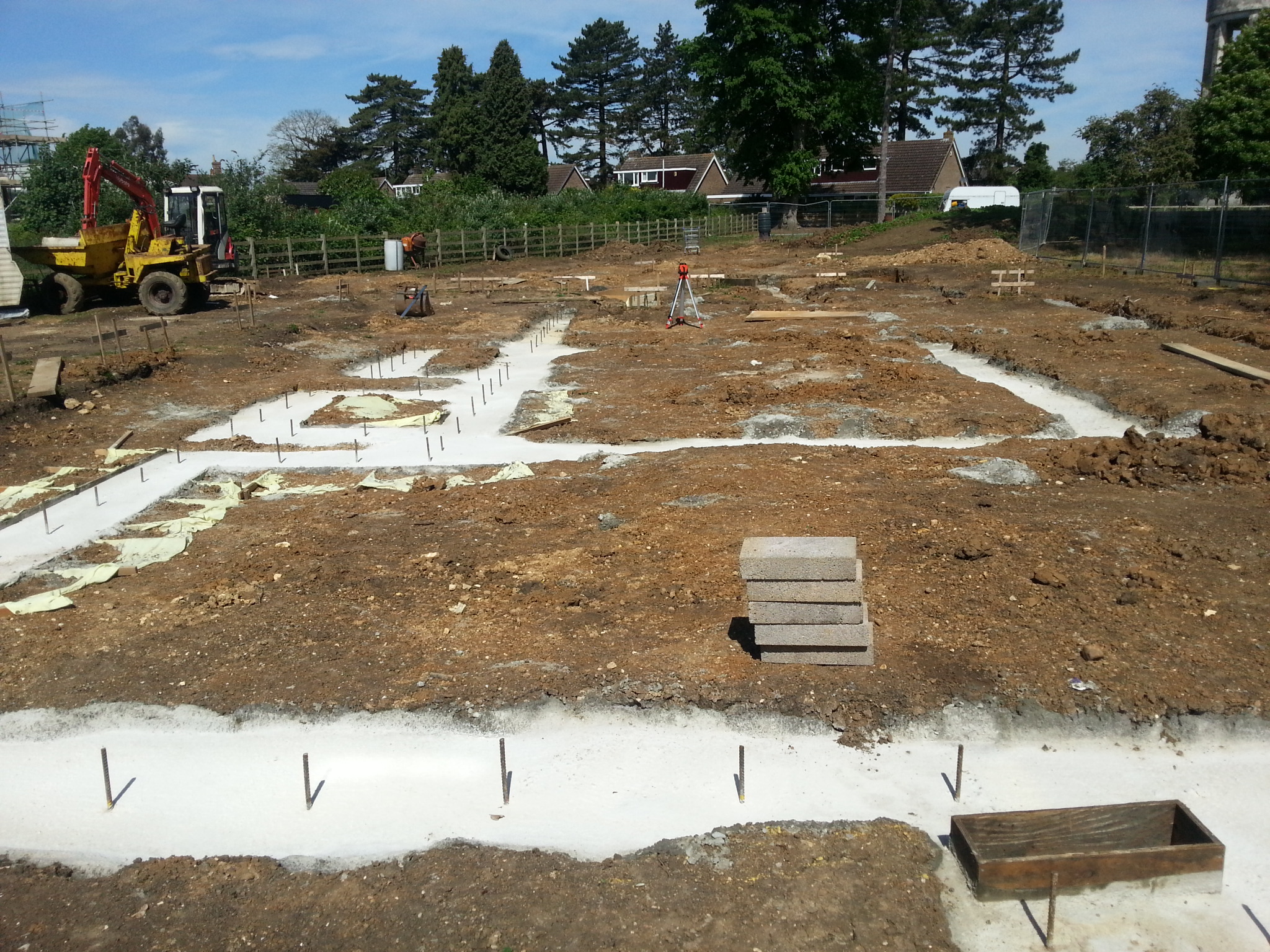

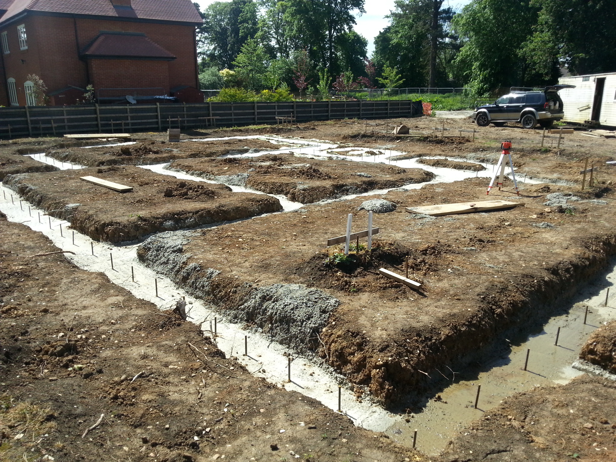

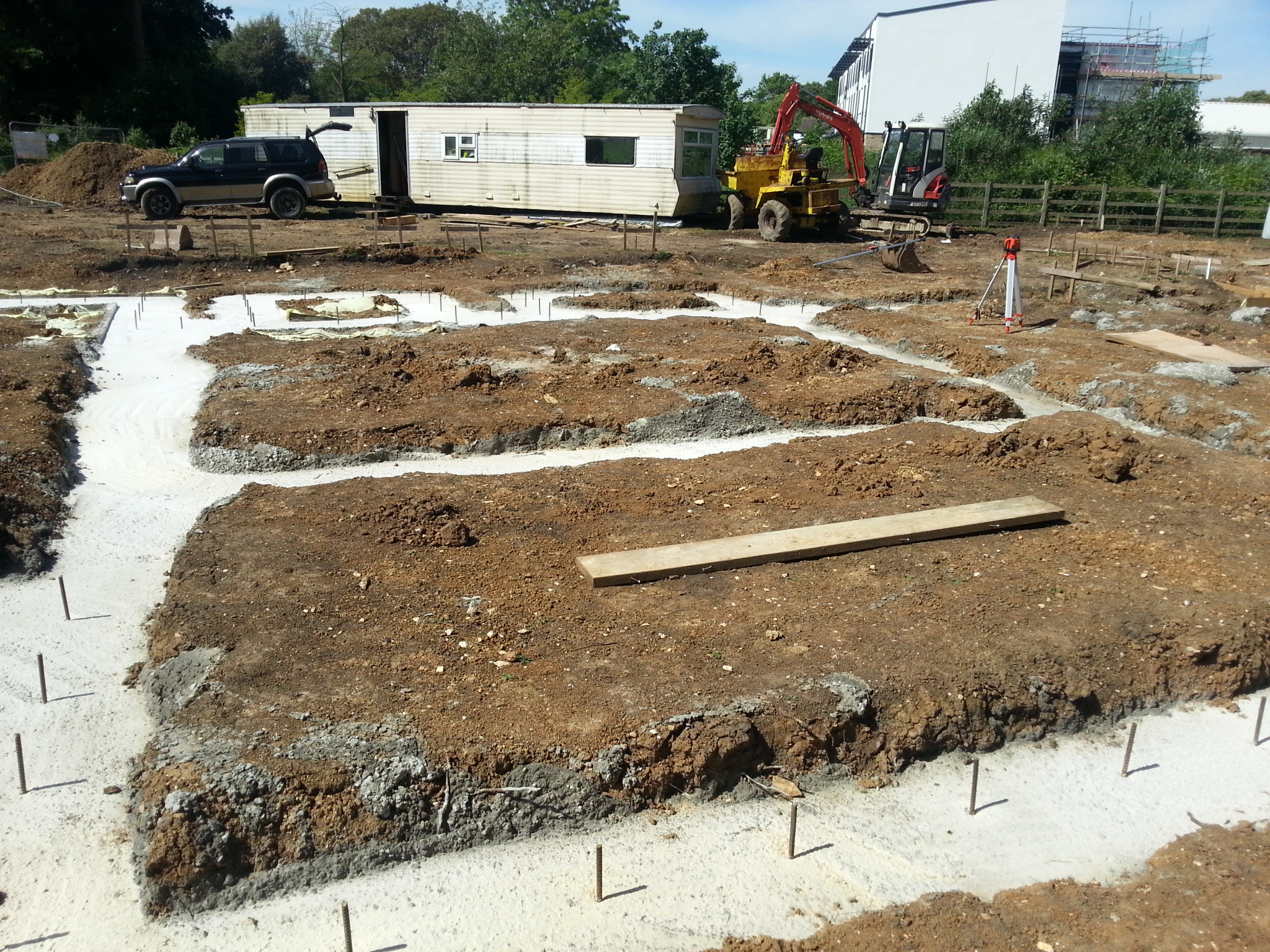

Vijay Posted May 22, 2017 Author Share Posted May 22, 2017 Cheers Roger. You're more than welcome anytime mate Went up there today, it's drying out nicely. Levels aren't spot on but if I'm being honest, I never thought it would be over 30m. It's gonna take a bit of work getting the first course of ICF spot on. Link to comment Share on other sites More sharing options...
Russell griffiths Posted May 23, 2017 Share Posted May 23, 2017 Don't worry about the levels, if it was your standard building site job you would be pleased if they got it within 50 mm. Link to comment Share on other sites More sharing options...
Mr Punter Posted May 23, 2017 Share Posted May 23, 2017 Give the ICF firm a call and ask them the best (quickest / cheapest) way to get over slightly uneven foundations. They will be most amenable. 50mm is well within tolerances for foundation concrete. Link to comment Share on other sites More sharing options...
