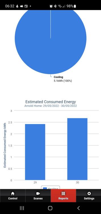

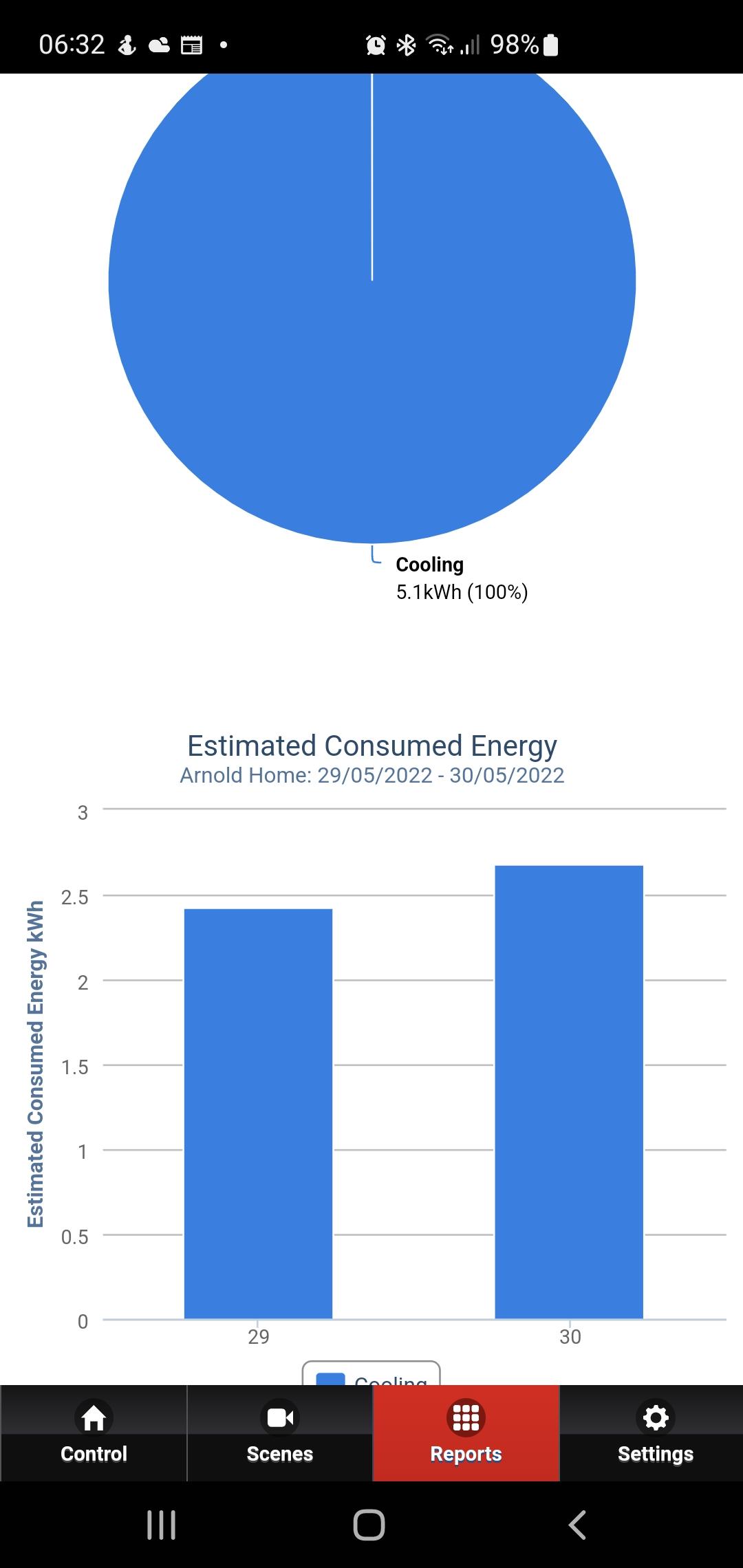

LA3222 Posted June 7, 2022 Author Share Posted June 7, 2022 I was away for a few days last week and turned the DHW off, heating and cooling was already off. The MEL cloud shows: Link to comment Share on other sites More sharing options...

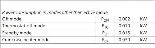

Luke1 Posted June 13, 2022 Share Posted June 13, 2022 I've got a NIBE F2040 8kW model. I have a shelly 3M monitoring the power usage. It would appear that when not in use the system is using 0.03kW. According to the installer manual this would suggest that the crankcase heater is operational. I do not see any settings to disable this and wondered if anyone else had found anything? I would expect the system to either be in Thermostat-off mode, or standby mode as per below table. Link to comment Share on other sites More sharing options...
JohnMo Posted June 13, 2022 Share Posted June 13, 2022 As I said loads of entries ago, the heater is stop liquid refrigerant forming in the lube oil. If you could or did disable the heater, you would be buying a new compressor quite quickly. The only way to stop this load is to switch the unit off at the mains. When the unit restarts it will go through a heat up period to ensure the refrigerant is expelled from the lube oil before starting the compressor. If you are using 5kWh a day on standby, while waiting to heat DHW, you may as just switch it off and use your immersion. Link to comment Share on other sites More sharing options...
RobLe Posted June 13, 2022 Share Posted June 13, 2022 @JohnMo You're entirely right, it is for that reason. I found a ref to the same fact in a book that I've borrowed on heatpumps. Annoyingly despite being a 400+ page book on heatpumps it didn't go into any more detail than that, so I'm left to speculate, and maybe you know more which would be great! I made my own heatpump that has been running fine for 6 months with no heater (don't think I'm an expert, all just diy).... ahhh - a bit of googling before posting works wonders - there's a wiki article on it, I think says we're both right "crankcase heater": "A crankcase heater is an electrical component in a compressor in an air-conditioning system, heat pump system, or chiller system. The crankcase heater is normally on all the time, even when the unit is not running, though temperature sensors and set points may turn it off when not needed. A crankcase heater's sole purpose is to prevent refrigerant migration and mixing with crankcase oil when the unit is off, and to prevent condensation of refrigerant in the crankcase of a compressor. The crankcase heater keeps refrigerant at a temperature higher than the coldest part of the system." Link to comment Share on other sites More sharing options...
