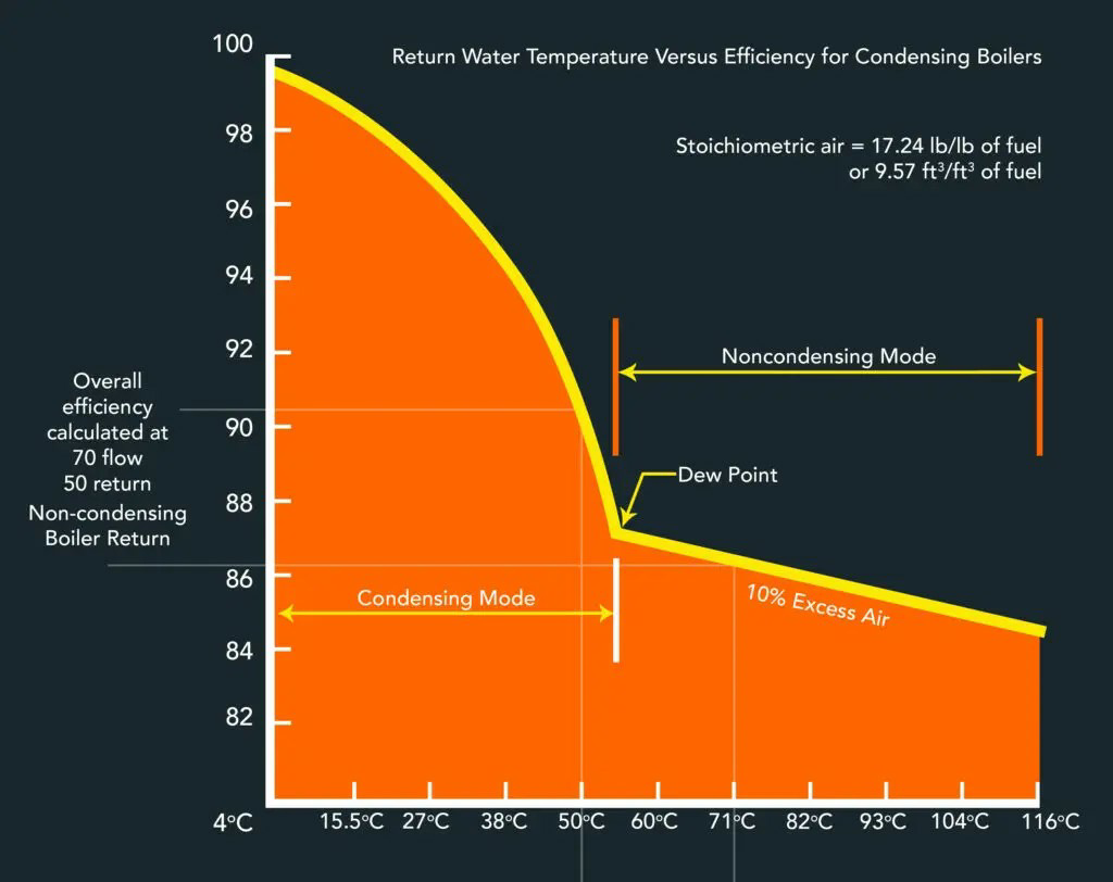

Good point. What would be a reasonable % efficiency to assume? A few years ago we had 2 large extra radiators installed with the same boiler so return temperatures should have dropped significantly. A brief look online suggests ideal efficiency of 95% translates to real world efficiency nearer 80%. My EPS/MCS estimate of 16MWh gives 76% so seems reasonable? Still a very impressive SCOP of 4.8 including that annoying idle power usage.
A condensing boiler starts to condense at I think a 56 degC return temp, the more it condenses the more efficient it gets.
Cut and paste from heat geek, it shows steady state efficiency, a stop start kills the efficiency.  76 more like 70% would be nearer.
