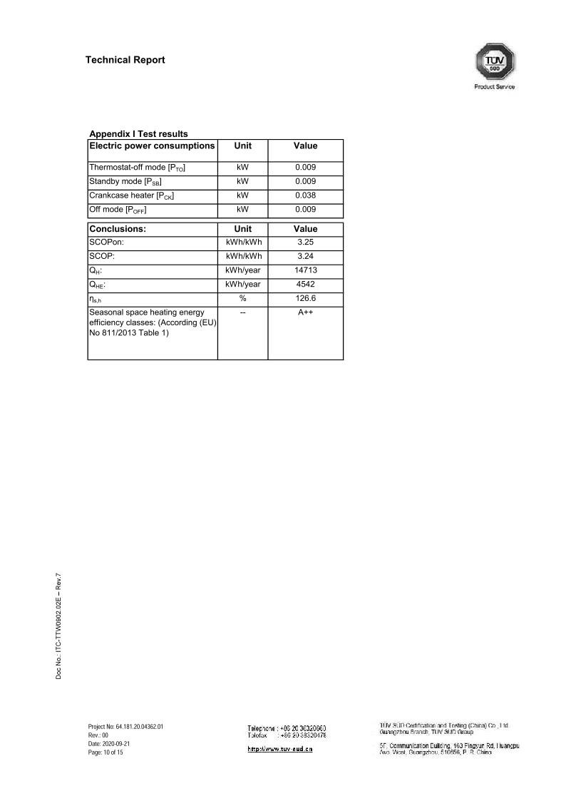

3 minutes ago, dpmiller said:
Lifted out of the TUV certificate1172750848_CE-iVT9EN1482564_181_20.04362.01Rev.00TRPerformancePages_pdf.thumb.jpg.fe585aaf8dfc4cf91a70daa4d58d6842.jpg
So a 38 W heater, and 9 W.
Total of 47 W some of the time.
Or.
That 38 W could be an average. But that would be a strange way to show it.
