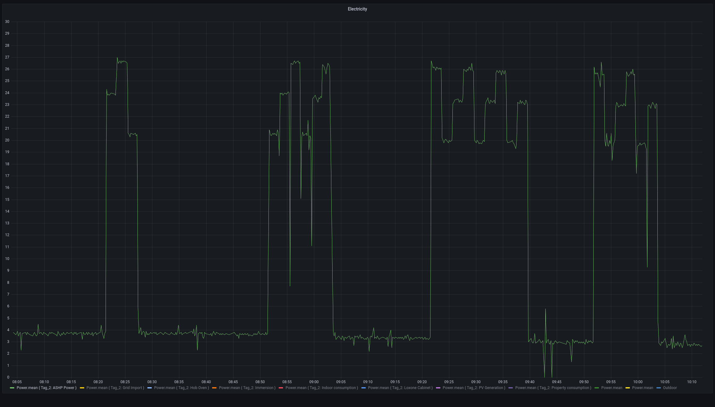

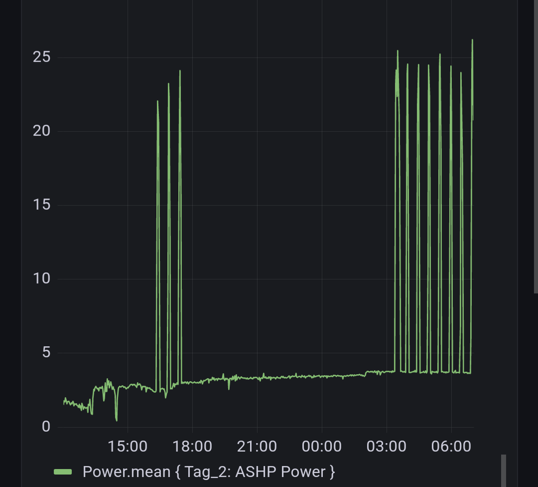

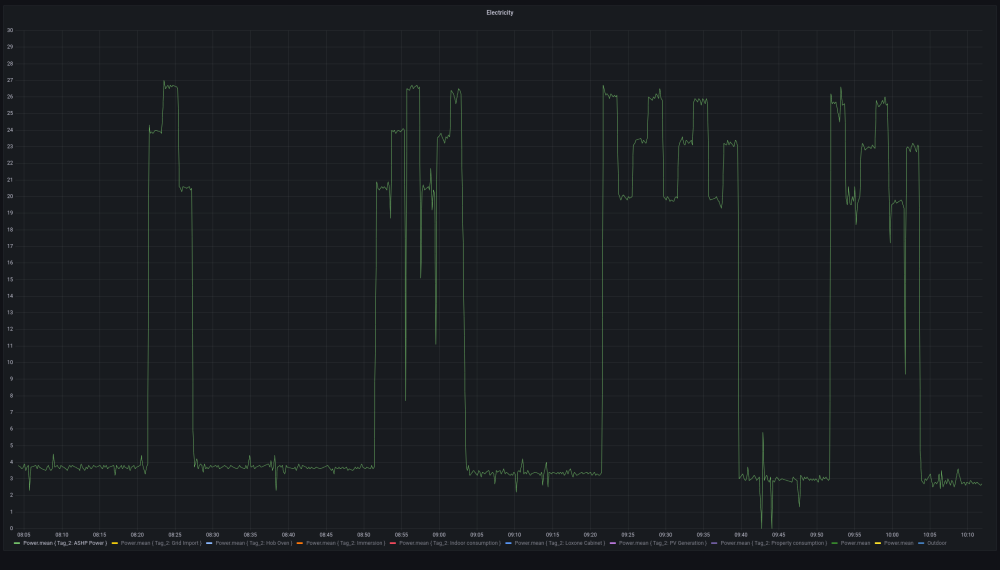

Very early days, but what I'm seeing with a dedicated CT (pzem-004t v3) is it alternating between 3W and 27W on a 30 min cycle, so maybe averaging 15W continuous. This is for a PUZ-WM85VAA with FTC6 controller.

Going by this post on the emporiaenergy community forum only the two Main clamps measure real power, all the others will show VA.
I think this is why there's a lot of discussion going on around this subject. The real power is probably quite modest (maybe why the Mitsubishi tech didn't bat an eye) but people checking with CT clamps not referenced to the line Voltage phase see alarming numbers.
I don't know how portable your Emporia Vue is but if its the one with two big clamps and 16 little ones, you could temporarily clip one of the big ones around the Ecodan supply wire and check the real standby power with that.

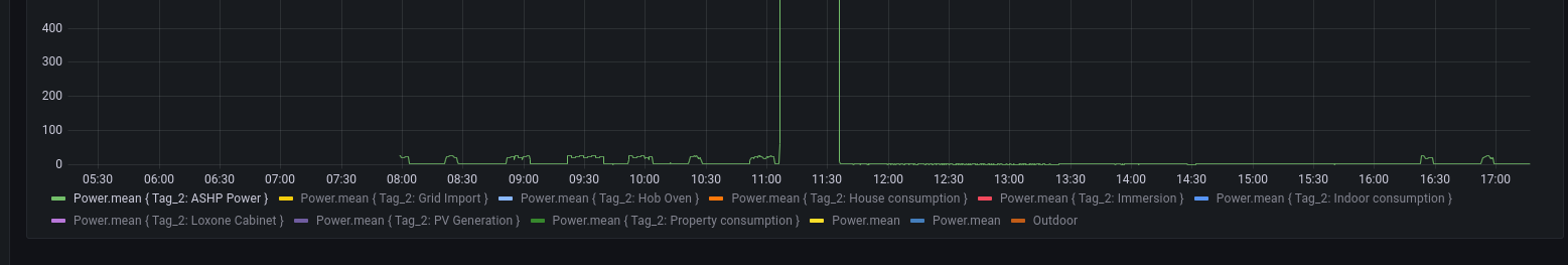

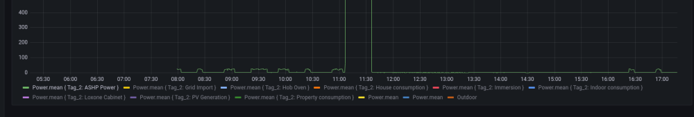

One more finding:
I ran the DHW for 30mins at 11am this morning (reheated the tank right up to 55C), and the periodic 27W draw ceased for the following 5 hours. I presume as the compressor was nice and hot it didn't have any need for warming it up. Thus, the draw would appear to be dynamic based on environment and operational conditions, not a static invariant load.
Yes the vampire load is very variable on my ecodan. After operating for 30mins at 11am yesterday it as dormant until 5pm, had 3 blasts of 25W and then dormant again until 3am.
So ignoring the actual operation, the energy accumulator says the background load has drawn 124 Wh in the last day, giving an average background load of 5W.
Not perfect, but low enough not to worry about.
