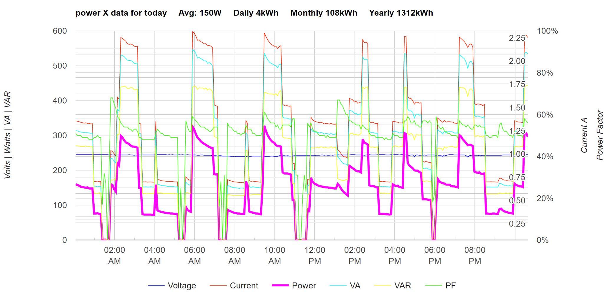

Is this 200W real? I mean like a resistive load with a power factor of one? A crankcase heater would be but a compressor might not. My fridge and freezers  have a PF of around 0.5 so they show up on simple current clamp meters as drawing twice as much power as they are billed for.

The utility companies meter would only register real power so if that was used to establish the vampire load that would clinch it. Alternatively many of the smart sockets with power monitoring can be made to expose VA and VAR if they are reflashed with Tasmota. That's how I got the insights into my fridge freezer power use (all three plugged into same smart socket):

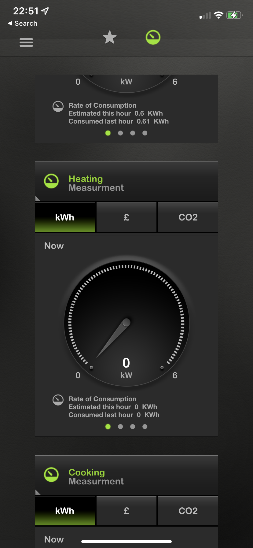

My Eco Dan uses 300w constant until I turned it off at the wall! 😁👍
I probably only need it on in BST 3 hours a day to top up the Hot Water. I’m going to create a workaround with a 4 ch relay that schedules the heat pump to come on 4 hours during mid day and 1 hour of that use the external boiler function to block the HW and Heating inputs that way its warming the oil before kicking in.
shame I have to create a work around think this function would be built into the FTC Eco mode but I found that the Eco mode doesn’t do anything or make any changes to how the system functions .

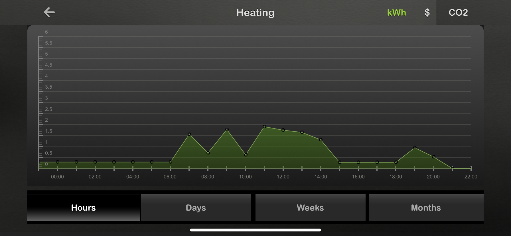

I don't understand this graph, as it's plotting kWh against time. Is that kWh per hour? Also known as kW (averaged over an hour).
If so, yes that does seem to be 300 W  😮
