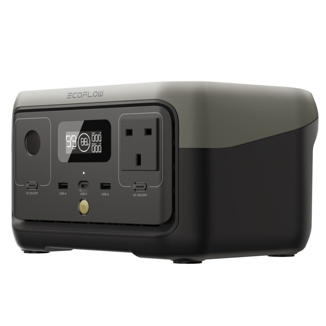

Russdl Posted February 12, 2023 Author Share Posted February 12, 2023 Have I found the answer to my problems in a power cut? This little rascal is the EcoFlow River 2 Portable Power Station. I can plug it in to the mains and then plug the MVHR into it. In the event of a power cut it will instantly take over (in 30ms according to the blurb) and run the MVHR. If I’ve got the maths correct and more importantly I’ve understood the electrickery bits properly it’ll run the MVHR on setting 2 for over 11 hours (standing by for being slated on both the above points…) It’s capacity is 256Wh and the rated power of the Brink on setting 2 (200m3/hr) is 23W. On top of all that, when I go wild camping (I don’t) I can take it with me to power the ghetto blaster for ages! Does anyone have any experience of the portable power stations? Is my planning sound? 3 Link to comment Share on other sites More sharing options...

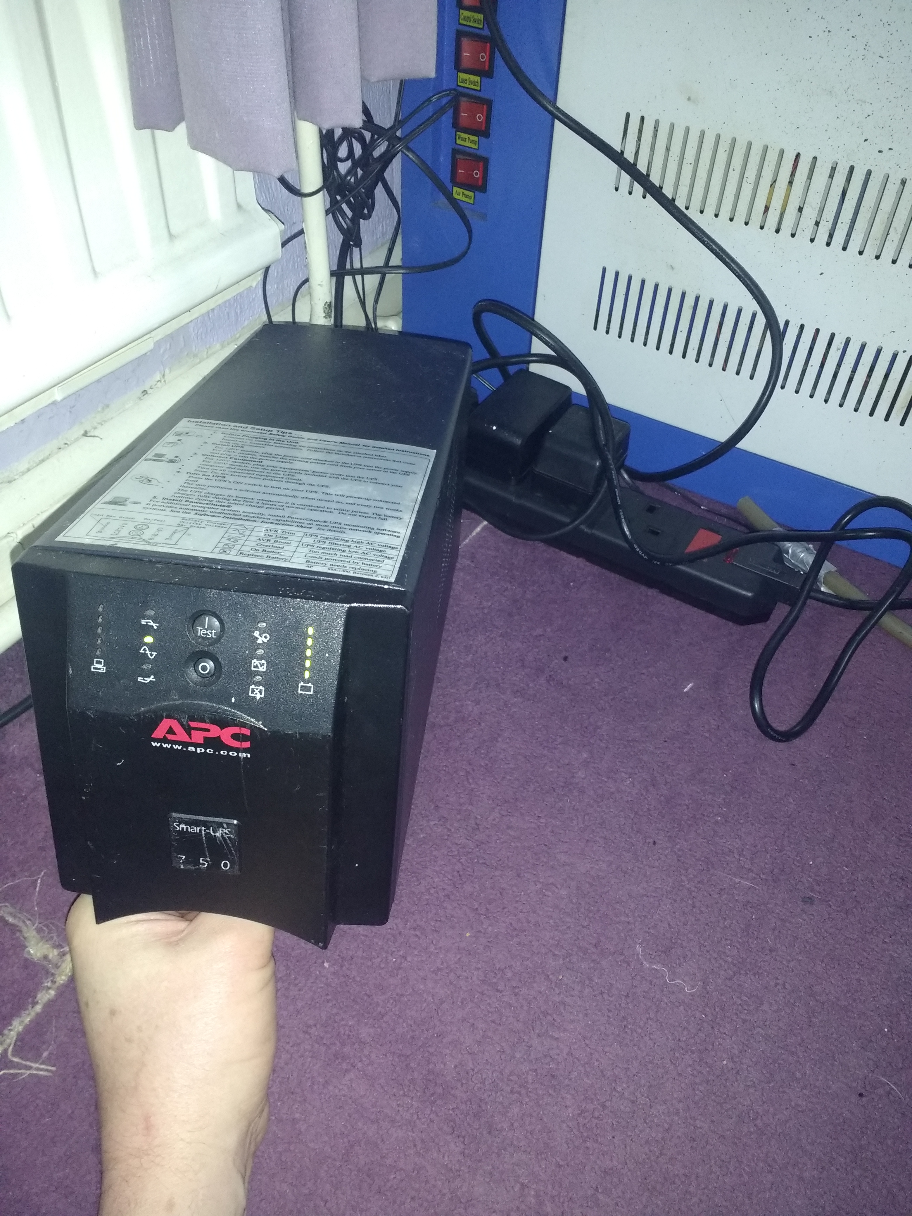

Onoff Posted February 12, 2023 Share Posted February 12, 2023 Dunno, got this for nothing and even got two new batteries for it, for nowt, the other week. 500W. Just use it for the phone, answerphone and router. 1 Link to comment Share on other sites More sharing options...
Russdl Posted February 12, 2023 Author Share Posted February 12, 2023 @Onoff nowts a good price - nice one 👍 1 hour ago, ProDave said: So it was you we passed walking up Cairn Gorm Unlikely. I would have been running. But how about the question, have I got the sums about right? Link to comment Share on other sites More sharing options...

Russdl Posted February 12, 2023 Author Share Posted February 12, 2023 @Kelvin Thanks for that, the plan is that it will be plugged in 24/7 so fully charged all the time and only discharging to the MVHR in a power cut (or when I take it away for a day trip up some mountain somewhere). It would appear from the blurb that its was primarily designed for off grid use but also functions as power station, UPS, call it what you will. I think I’ll go for it. Link to comment Share on other sites More sharing options...
SteamyTea Posted February 13, 2023 Share Posted February 13, 2023 (edited) 10 hours ago, Russdl said: It’s capacity is 256Wh and the rated power of the Brink on setting 2 (200m3/hr) is 23W. 9 hours ago, Russdl said: have I got the sums about right 256 [Wh] / 23 [W] The watts cancel out leaving the hours. 256 / 23 = 11 [h] Yes How much is it? Edited February 13, 2023 by SteamyTea 1 Link to comment Share on other sites More sharing options...

Adrian Walker Posted February 13, 2023 Share Posted February 13, 2023 11 hours ago, Russdl said: Have I found the answer to my problems in a power cut? This little rascal is the EcoFlow River 2 Portable Power Station. I can plug it in to the mains and then plug the MVHR into it. In the event of a power cut it will instantly take over (in 30ms according to the blurb) and run the MVHR. If I’ve got the maths correct and more importantly I’ve understood the electrickery bits properly it’ll run the MVHR on setting 2 for over 11 hours (standing by for being slated on both the above points…) It’s capacity is 256Wh and the rated power of the Brink on setting 2 (200m3/hr) is 23W. On top of all that, when I go wild camping (I don’t) I can take it with me to power the ghetto blaster for ages! Does anyone have any experience of the portable power stations? Is my planning sound? For ~£300 it will give you comfort during power cuts and I’m sure you will find other uses for it during the year and yes the numbers work. 1 Link to comment Share on other sites More sharing options...

Russdl Posted February 13, 2023 Author Share Posted February 13, 2023 1 hour ago, SteamyTea said: How much is it? £269 the cheapest I’ve seen so far, so an expensive solution to a rare problem but it’s not a one trick pony which is what tempts me. 2 Link to comment Share on other sites More sharing options...
SteamyTea Posted February 13, 2023 Share Posted February 13, 2023 29 minutes ago, Russdl said: £269 the cheapest I’ve seen so far, so an expensive solution to a rare problem but it’s not a one trick pony which is what tempts me. If it was just for the MVHR, I would be tempted to buy a cheap inverter that runs of a leisure battery, which is on a trickle charger. But that is probably £200 quid in reality. Link to comment Share on other sites More sharing options...
