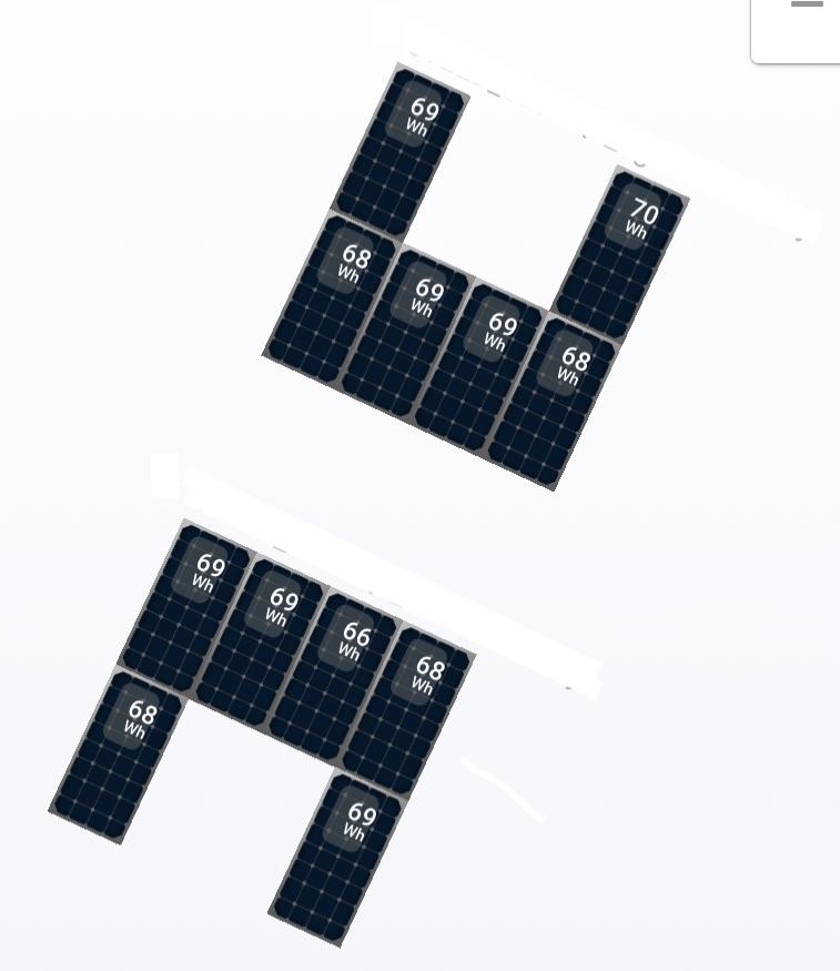

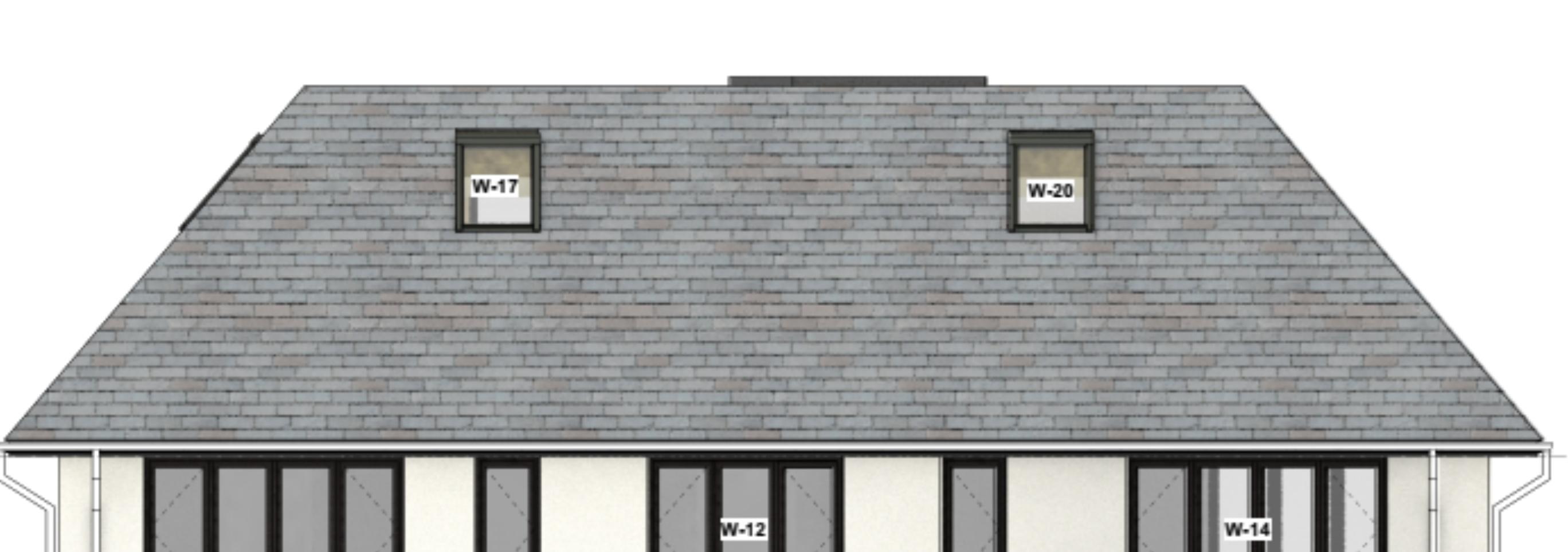

Was wondering about this. With in-roof, I would imagine you effectively have "trays" for standard panels, no? Or is it a totally different system?
My sun-facing roof section has windows in it, I somewhat worry that trying to fit panels on it would leave lots of spaces, but I imagine in-roof would, if anything, be worse?

If it is not built yet, get rid of the hips, get more on then.
But basically yes, standard trays around the windows.  I think Velux actually do a PV system.
Edited by SteamyTea
The trays are the same size as the panels so will follow however you propose to lay them out.
You'd have the same constraint whether using on roof or in roof.

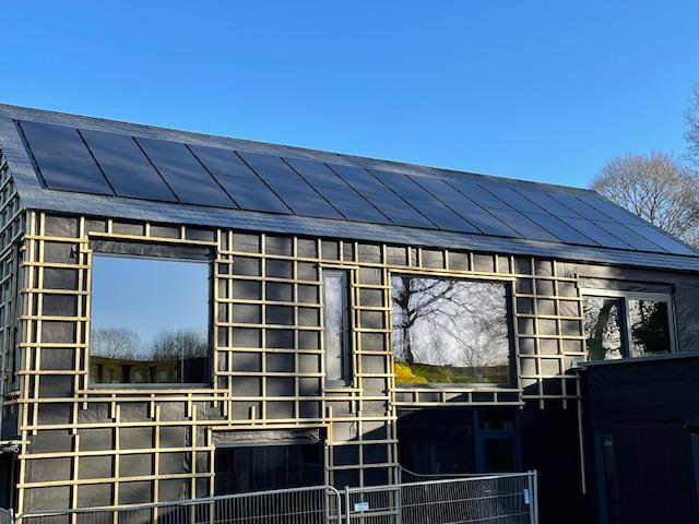

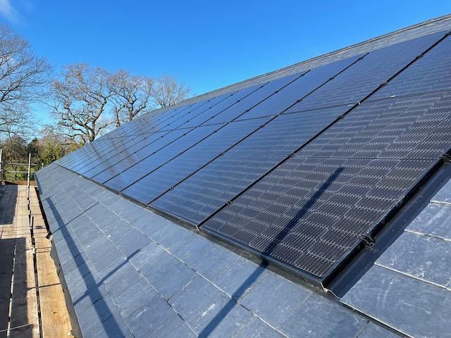

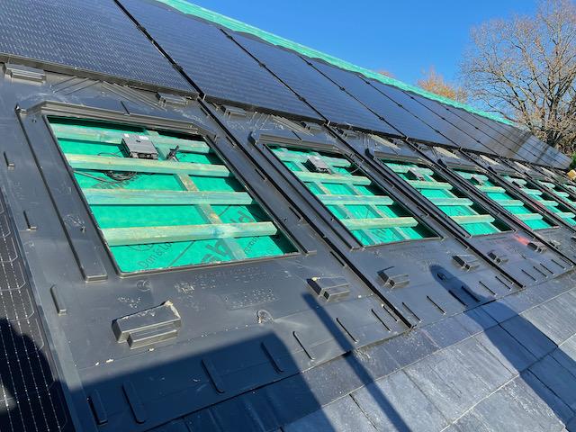

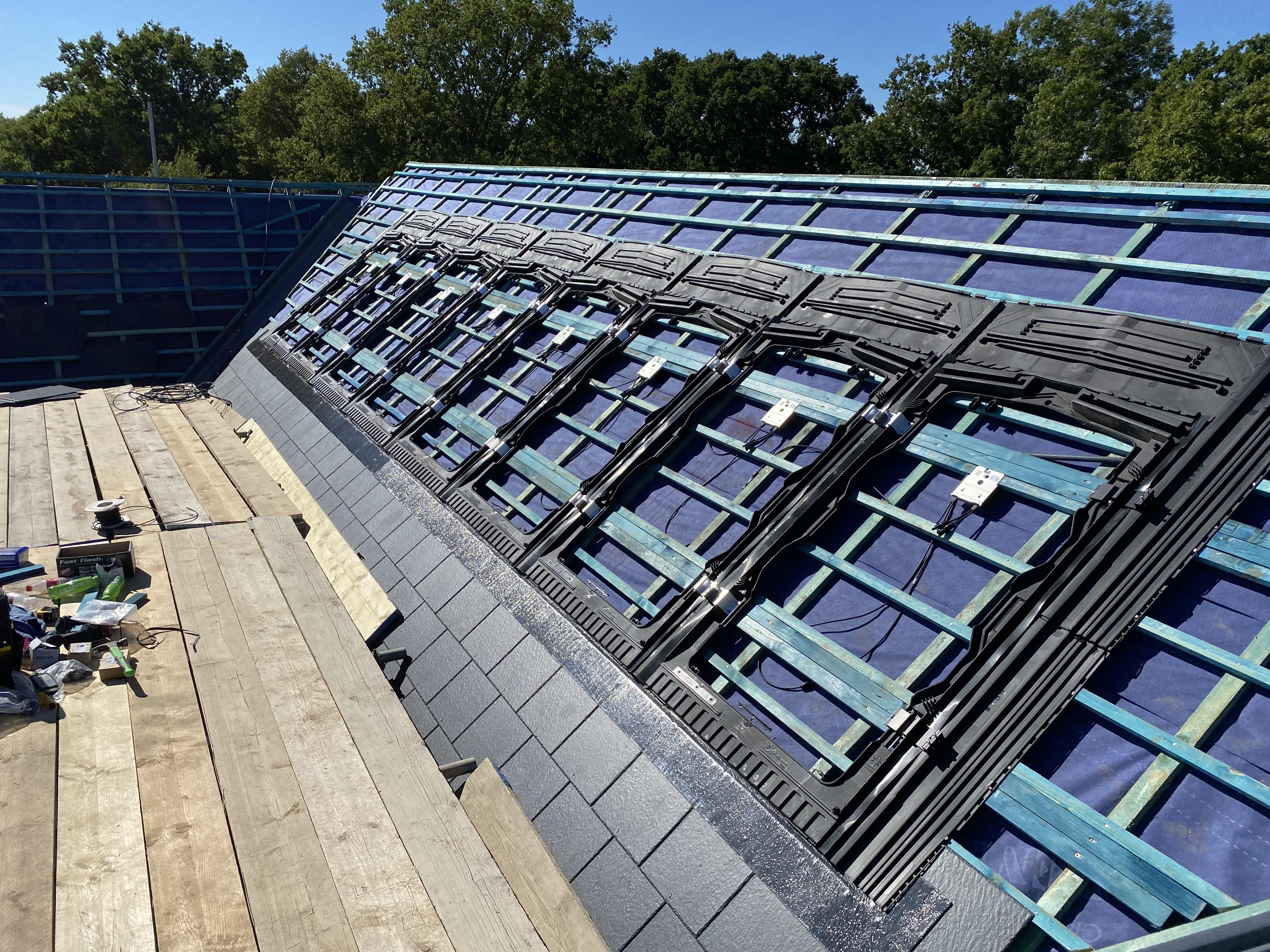

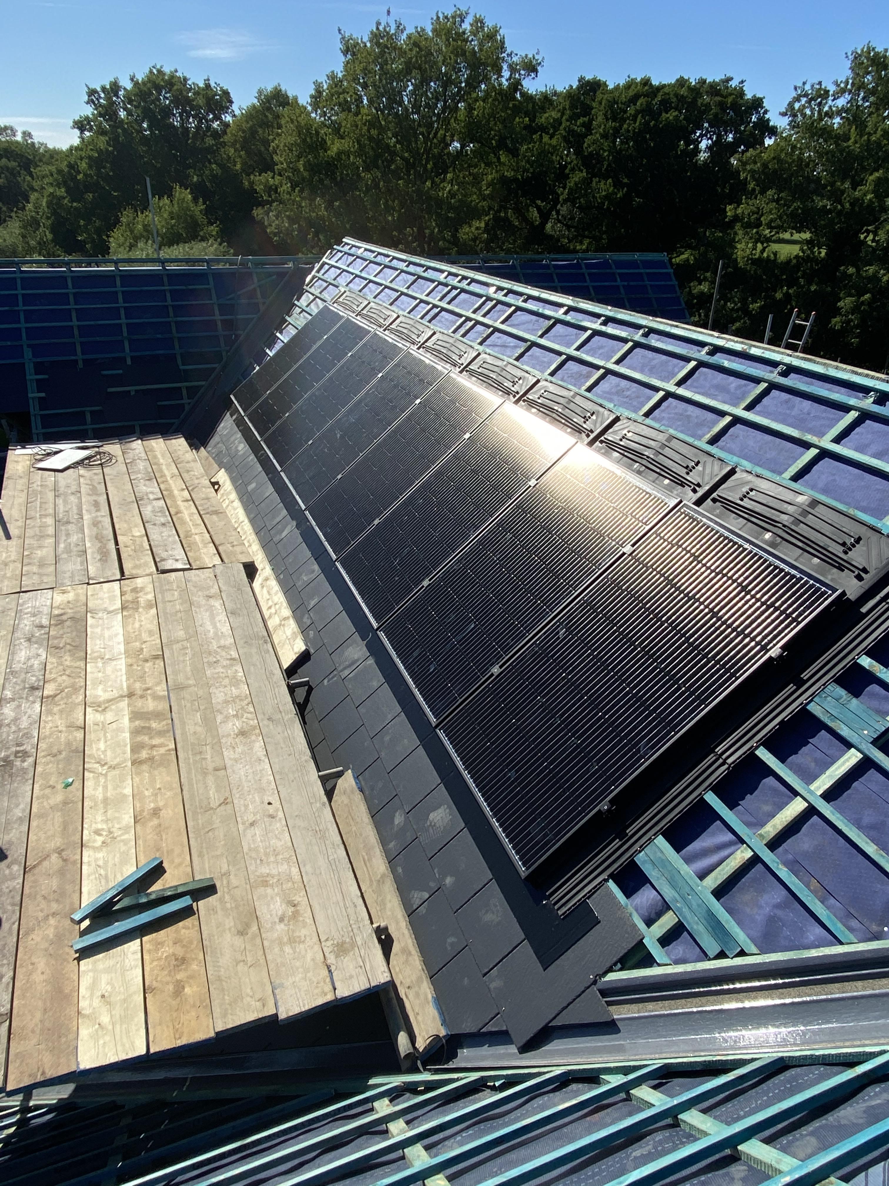

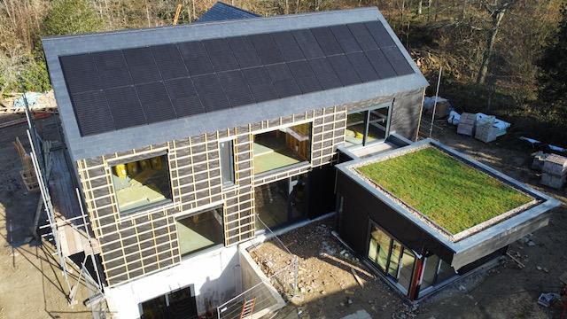

here's my install. so much nicer than on-roof!
Yes that’s definitely the way to go. As it’s over the battens it doesn’t seem like such a big deal to me. Though I might need to re-felt which will make it a bigger job obviously.

yeah. definitely easier on a new build rather than renovation. but if you're having the roof re-tiled then it makes it easier (and potentially cheaper on not having to use tiles under the panels).

Very nice! Which brand/supplier?
GSE trays and the panels are LG 375W Mono NeonH Black E6.
the supplier is a little bit of a sore point as we used Enhabit for our M&E design and they supplied the components for our Solar PV, MVHR and ASHP/DHW. But they have recently been bought out by/merged with Green Building Store and no longer offer ASHP or Solar PV so I have been left with incomplete installations. But that's life I guess and I can find someone else to finish the job.

LG are at the top end of panels so they weren't cheap but they degrade slower than something like the JA Solar panels and have guaranteed performance after a certain number of years. (sorry I forget the actual figures!)
