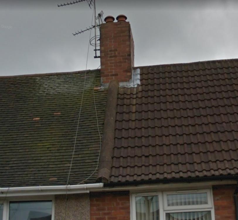

JohnBishop Posted January 30, 2022 Posted January 30, 2022 Hi All, There are leaks on the shared wall and after looking on the outside I think the rain water seeps from the neighbouring roof I think it's flatter than mine and some water makes its way under my tiles. Something is not right. There are also some leaks into the chimney. I think this also needs doing. Please advise. Best regards
Big Jimbo Posted January 30, 2022 Posted January 30, 2022 It looks like your roof has been re-done at some point. Looks like water getting under the ridge tiles between the Two buildings. 1
JohnBishop Posted January 30, 2022 Author Posted January 30, 2022 Yes, it's newer than the neighbour's but the ridge bit needs doing. What is this black residue under his roof, is it from the water exposure, an overflowing gutter? This is northern side so the green stuff can be justified. His roof could be leaking in few places. I think chimney also needs an inspection.
Dave Jones Posted January 31, 2022 Posted January 31, 2022 (edited) there should be a hidden gutter between the two roofs under that bodge of ridge tiles. It's purpose is to provide a watertight barrier where you have 2 dissimilar tiles that dont bond. Not a huge job, get rid of those ridge tiles and fit the trays. days work tops. Assume the right hand house is a council house with the external cladding, maybe get onto them ? Edited January 31, 2022 by Dave Jones 1
dpmiller Posted January 31, 2022 Posted January 31, 2022 the bottom two rows of tiles kick up a helluva bit. Did the damp follow windy weather? I'd suggest the felt at the eaves is questionable at least. 1
Nickfromwales Posted January 31, 2022 Posted January 31, 2022 9 hours ago, JohnBishop said: What is this black residue under his roof It’s just moss / other growth that hasn’t been hit by the rain. You’ll see it on many surrounding properties and is of zero concern. 1
Carrerahill Posted January 31, 2022 Posted January 31, 2022 Not sure what that bodge of ridge tiles is about. As far as I know those are ridge tiles for a ridge. What should have been used is called a "Secret joining/bonding gutter" - it looks like a flat piece of tray with an upstand in the middle, the flat sections have some grooves and usually a rough finish to limit water travel, you cut back the neighbouring roof slightly, they lap the hopefully good felt up onto the gutter, then your new roof membrane is laid up to the gutter before re-covering. Job done. Looks like someone has gone cheap and used tiles on your roof instead of slate which has maybe caused the contractor (horse tied up out back?) some issues with the joint. But that is an abomination. If they have not used a gutter, which I suspect they have not or else why the ridge tile bodge? Then I do wonder if they have just lapped the felt, then tried to rely on the ridge tiles and mortar to provide the seal. The ridge tiles and mortar are now ropey and there you have it, a leak. 1
Russell griffiths Posted January 31, 2022 Posted January 31, 2022 @JohnBishop why do you think it’s your neighbours roof leaking, if yours was the one that was replaced, then it was the roofers that did yours that haven’t provided a good join between old and new. Others have said that’s it’s a bit of a mess, well it is, but that row of ridge tiles was a very standard practice in the 80-90s for joining two roofs of different materials. The tiles on the left are a clay small tile, not slate. The tiles on the right are an interlocking concrete, again a standard replacement due to cost. I think you need a roofer and I would say it’s down to you to fix it, your neighbour was probably very happy with their roof before yours got re done., and could well be causing a leak on their side as well. The black stuff as nick said is air pollution that doesn’t get washed off because it is hidden under the roof line. 2
JohnBishop Posted January 31, 2022 Author Posted January 31, 2022 @dpmiller @Dave Jones @Carrerahill @Russell griffiths Thank you for your suggestions I reckon I get rid off the ropey ridge on the other side as well as this will leak there too. I think they haven't done a good job around chimney as well what would explain the damp on the chimney wall. 1

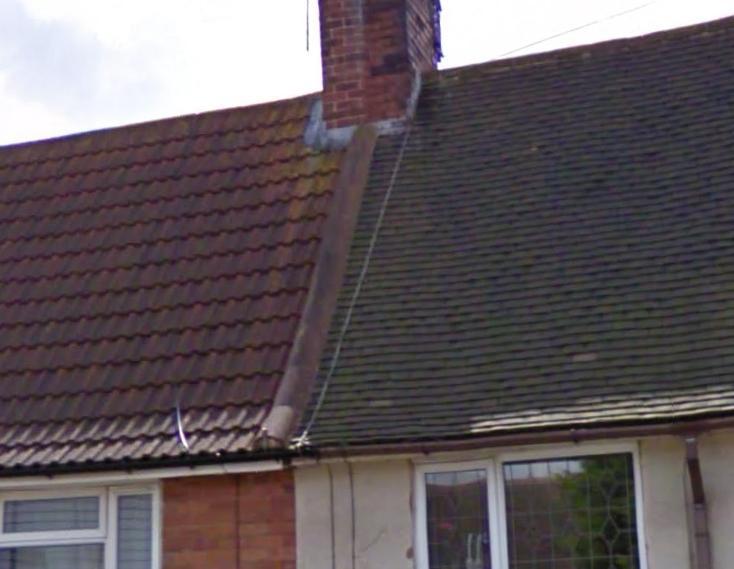

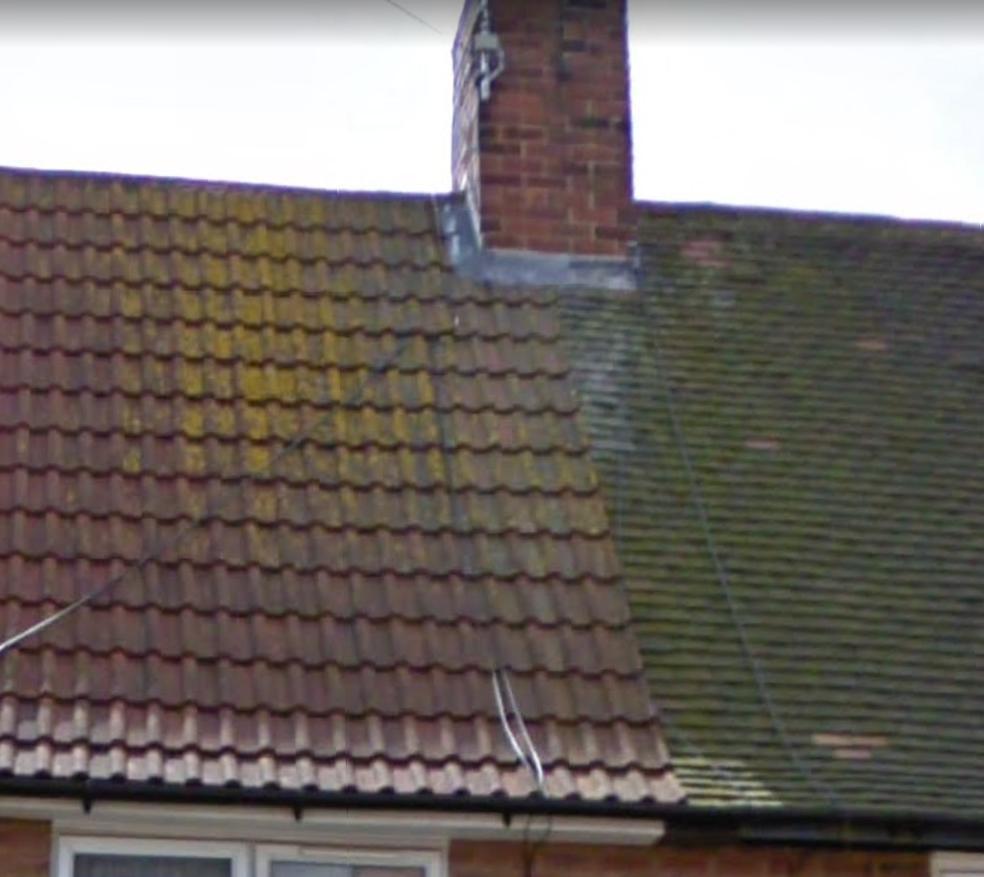

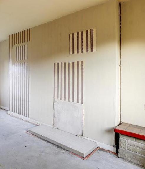

JohnBishop Posted April 25, 2022 Author Posted April 25, 2022 (edited) My surveyor has done L3 survey at the property and it seems all the leaks originate from the ridge tiles but I think also the chimney AND/OR the area around the chimney what would explain the wet spots on the 2nd picture above. The fireplace on the ground floor has been completely walled/sealed. I think I need this fireplace back for better airflow. I think they walled it because the council tenant was burning stuff he wasn't supposed to. The ridge tile on the other side does (Southern) looks better and is not leaking (I reckon because mortar has a better chance of drying) but will eventually needs doing. How do you think what would be the cost of fixing this? I have asked for quotes 3 local roofers but they didn't come back yet, I don't know maybe not interested in fixing things but replacing the whole roof but I don't want to go that route yet as I am planning to put solar panels in not distant future so I would do it at one go. I reckon this cannot be done without a scaffolding or at least some of the work would require scaffolding. Edited April 25, 2022 by JohnBishop
tonyshouse Posted April 25, 2022 Posted April 25, 2022 Plain tiles are more likely to leak and should have had soakers down under the ridge tiles and probably didn’t. I don’t like the detail one bit, virtually guaranteed to leak, even with a secret gutter it might! 1

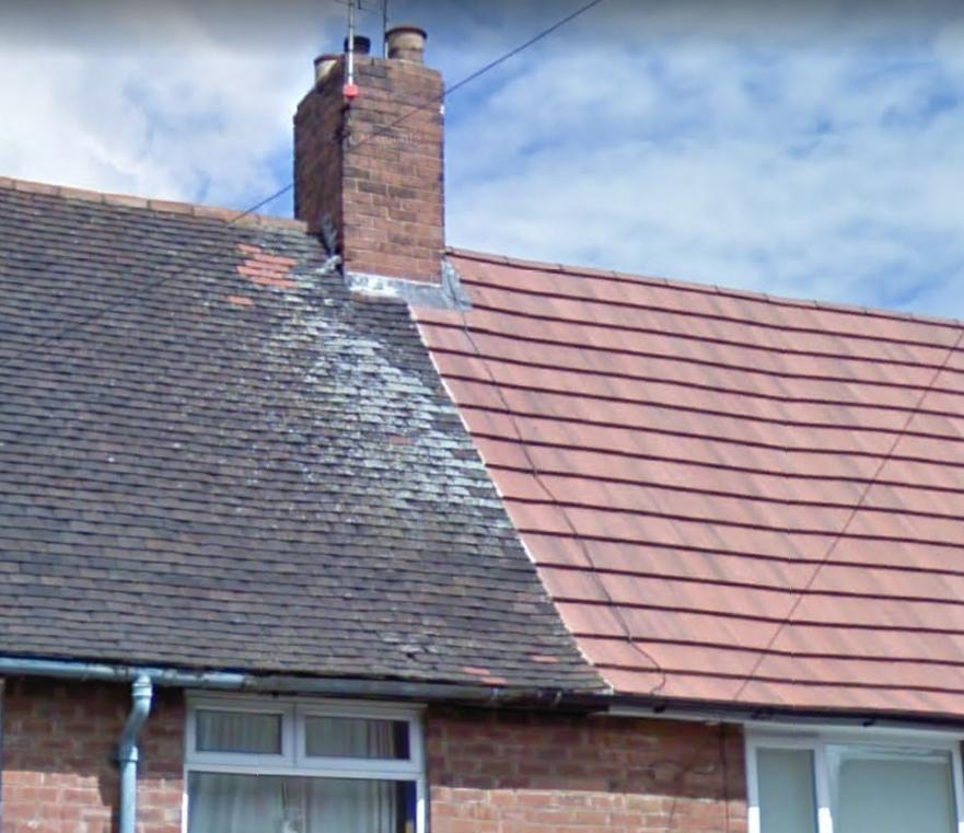

JohnBishop Posted April 28, 2022 Author Posted April 28, 2022 (edited) I mean I see over 30% of the semi-detached houses in the neighbourhood have different tiles and ridge tiles in the middle so it does not look like rare or bad practice. Example picture 1 and 2 What I understand based on your input is that a roof without ridge tiles last longer. Example picture 3 and 4. I reckon the problem is that this hasn't been done properly - no protection underneath (no secret gutter) and mortar disintegrated over time. The question is if the fireplace should be reinstated to provide a better ventilation but I also would want to install a wood stove as a backup. Edited April 28, 2022 by JohnBishop
