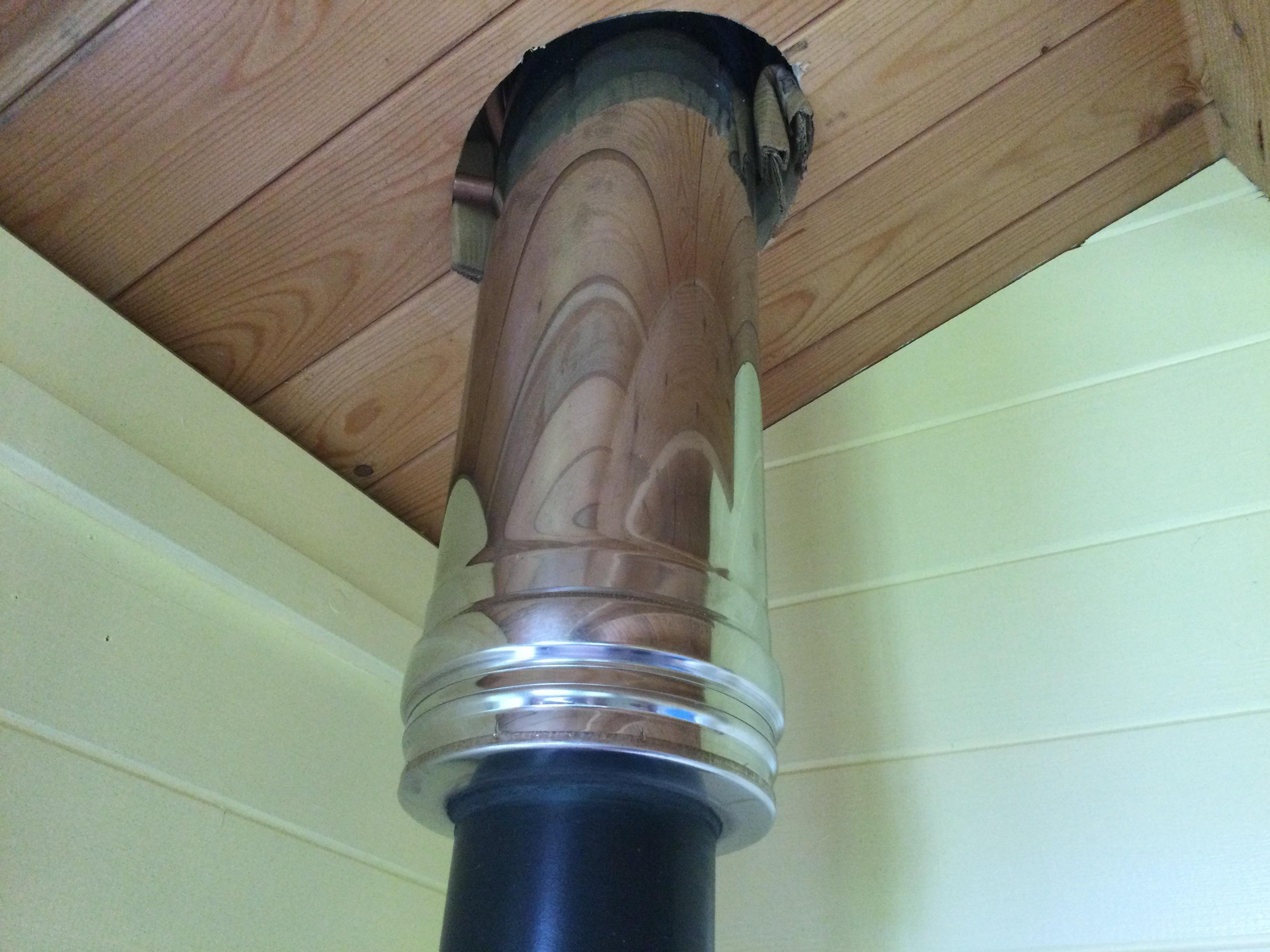

zoothorn Posted May 30, 2022 Author Posted May 30, 2022 3 hours ago, saveasteading said: My bad question. I meant that glass/rock wool is fibres that are glued together where they touch. If it gets wet it stinks and falls apart. so maybe that would also fail in heat. If it is compressed enough that wont matter. I have rockwool stuffed hard around an uninsulated pipe, perhaps 50 thick, then plasterboard and it only gets slightly warm so you should be fine, but keep an eye on the surrounding area for any sign of colour change. 3 hours ago, saveasteading said: My bad question. I meant that glass/rock wool is fibres that are glued together where they touch. If it gets wet it stinks and falls apart. so maybe that would also fail in heat. If it is compressed enough that wont matter. I have rockwool stuffed hard around an uninsulated pipe, perhaps 50 thick, then plasterboard and it only gets slightly warm so you should be fine, but keep an eye on the surrounding area for any sign of colour change. Thanks understood SAS. I'll keep a close eye on colour change here: I can also undo the plate easily to check on the loft wool. If I find some rockwool offcut.. will replace it. Thanks, zoot.
zoothorn Posted May 30, 2022 Author Posted May 30, 2022 2 hours ago, PeterW said: That’s only 200mm up from where the 2 sections join - not surprised it gets hot as at the join to the enamel the inner and outer skins are connected. Good point. Hopefully I'm being paranoid... but worth being super cautious being a timber cabin. Will keep a close eye on this area for first few fires. Get my workshop extinguisher in there until I'm confident, just to be safe. Thanks Peter. zoot.
PeterW Posted May 31, 2022 Posted May 31, 2022 For it to be an issue you’ll need to get the stack above 350°C all the way up through the roof - it will be the felt that melts first ..!! Carry on as you are, but a small extinguisher is always a good plan .! Aldi have them in the centre aisle this week for £12

zoothorn Posted May 31, 2022 Author Posted May 31, 2022 1 hour ago, PeterW said: For it to be an issue you’ll need to get the stack above 350°C all the way up through the roof - it will be the felt that melts first ..!! Carry on as you are, but a small extinguisher is always a good plan .! Aldi have them in the centre aisle this week for £12 That reply gives me confidence. And relax. I'm still putting my rad thermometre on next time tho. Dang, our Aldi has a very limited 'diy/ chaps' aisle.. barely anything sold tbh. A mini 🧯 is a good idea though. Thanks.

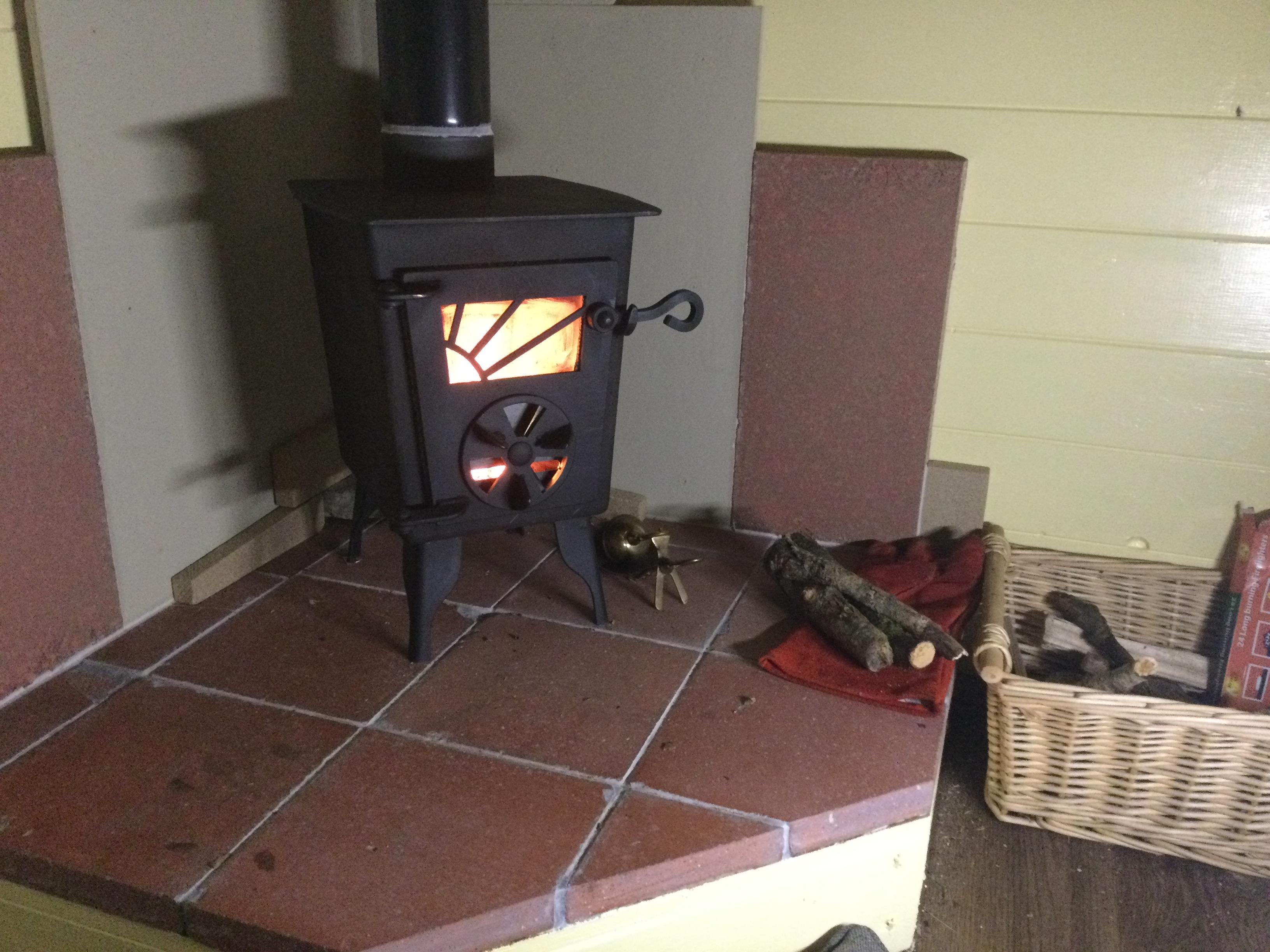

zoothorn Posted May 31, 2022 Author Posted May 31, 2022 1 hour ago, Onoff said: I might have some "proper", green, Rockwool slab offcuts that would be suitable if you'd be happier with that. If so I'll post them. I know where you live! 😂 That would be terrific Onoff. Saves me scrabbling in skips like an aber hobo. Let me know the £postage. One last thing I'm considering, is putting in firebricks ( 2 sides, & the back ). Idea being to minimize the stove's output. It's a belter & I'm gonna cook in there as it is. Usefully the 2 larger/ longer sides, lean outwards. So if I fashion a back.. then two correctly- cut sides can pop in to keep back in place. Just an idea. But essentially I think I can say the job.. is complete! Great. Thanks zoot.

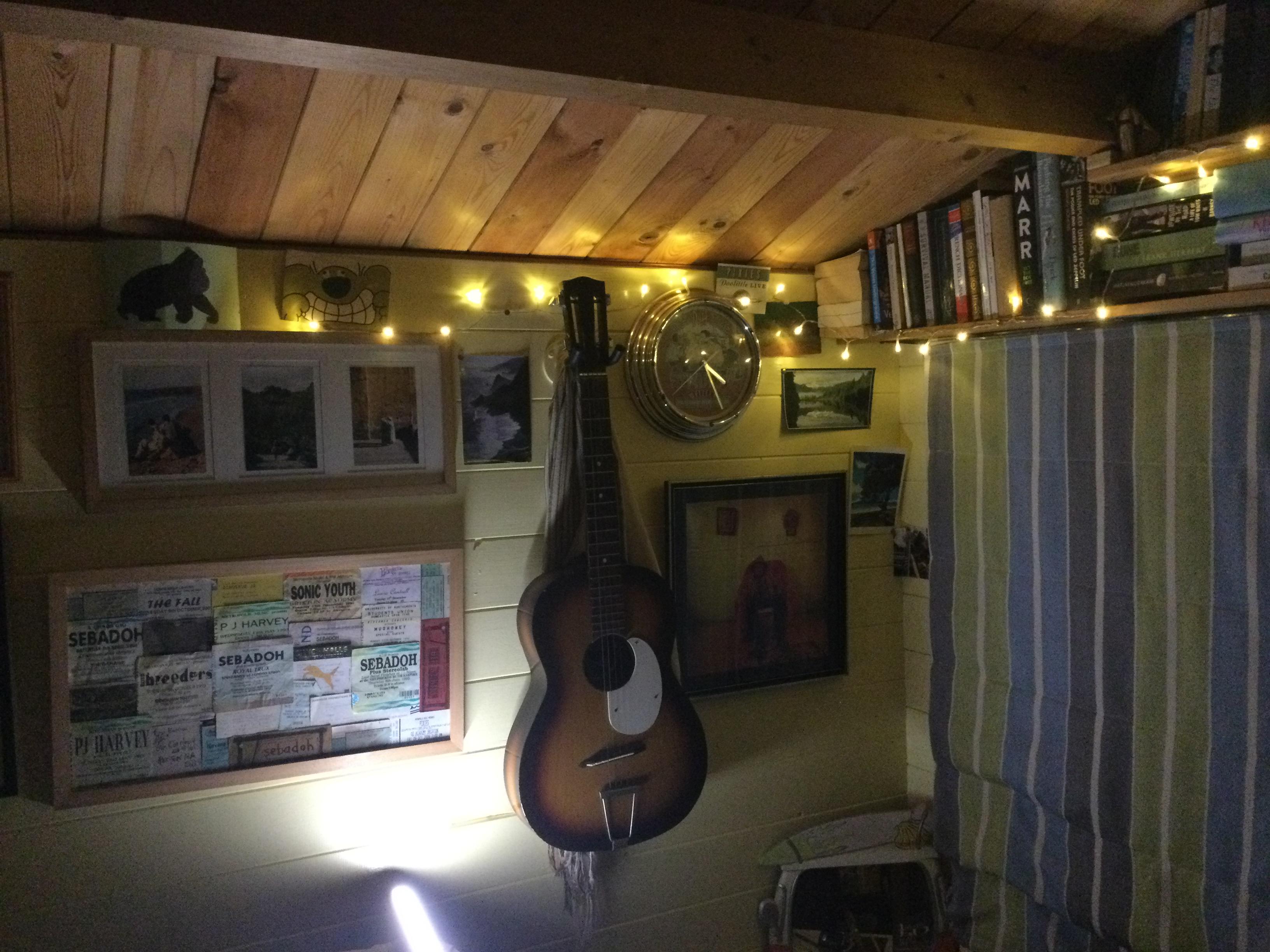

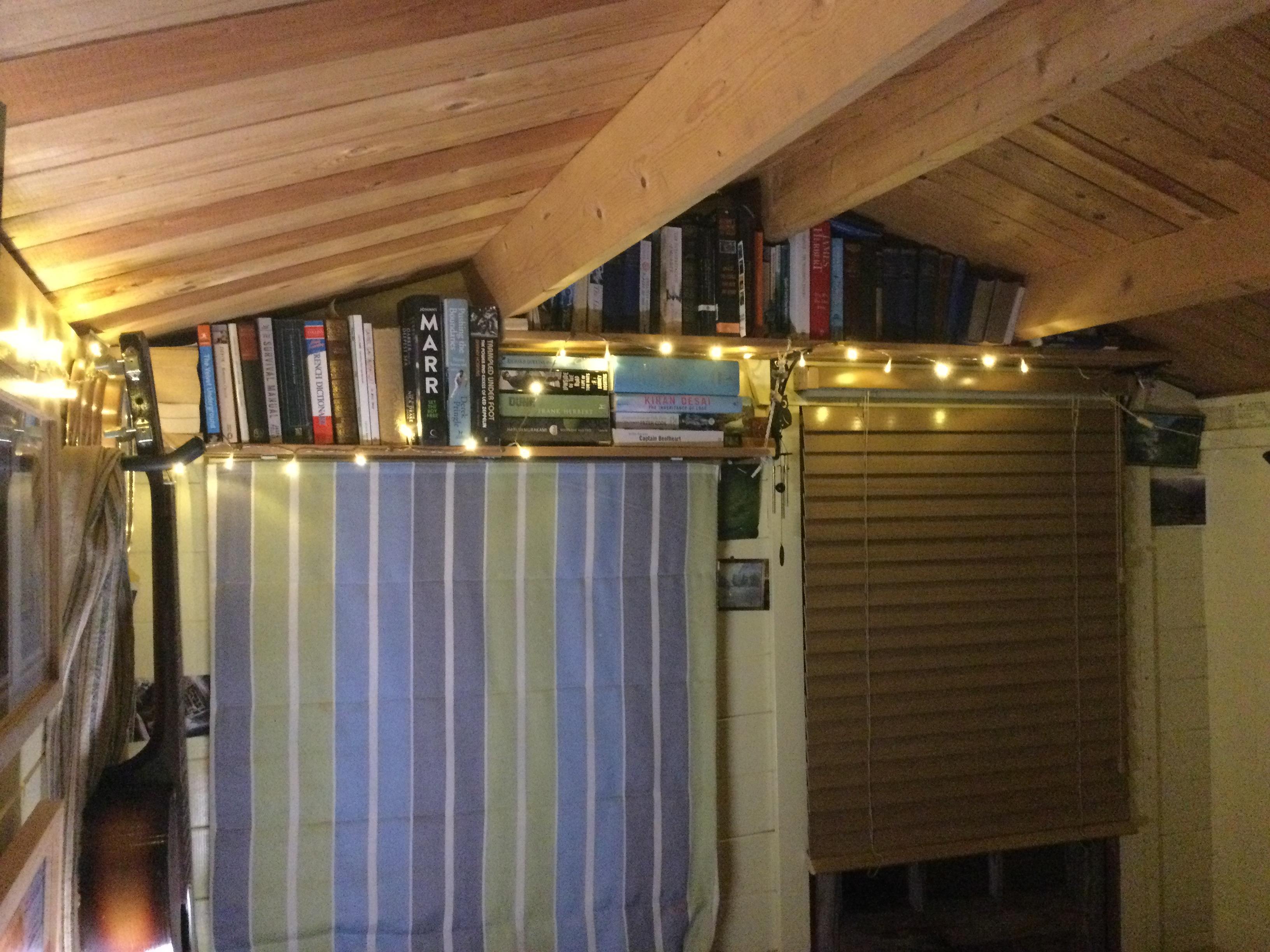

zoothorn Posted October 5, 2022 Author Posted October 5, 2022 @Onoff few pics as an update. Had 3 fires so far. I lined inner stove walls & back with 30mm firebricks, even so no.1 was literally like a sauna, 34*C in cabin. no.2 I reduced wood to Max half the stove volume, 28*C still a bit hot. No.3 last night 26*C almost ideal. So, it takes a tiny ammount of logs/ super efficient, & I know in coldest winter I can ramp it up a bit & keep warm. Battery lights, ipad with a downloaded 2 progs for a few hrs: warm, offgrid & offline, & free wood too (collected on walks). Every other evening minimum I'll be in here now, as Im far warmer than in house & far cheaper too- truly fantastic results. 6

ProDave Posted October 5, 2022 Posted October 5, 2022 5 minutes ago, Onoff said: I only have the one garage. Anyway, it's far too close to the house. If I had a stream I'd put the cabin the other side as SWMBO can't swim. Then you would have to build a bridge (on my list of projects to do) @zoothorn is the Guitar okay in there all the time? it will get cold when the stove is not on. My acoustic goes out of tune on it's own in a constant temperature house, but I rarely play that much preferring the pretend Stratocaster.
zoothorn Posted October 5, 2022 Author Posted October 5, 2022 54 minutes ago, ProDave said: Then you would have to build a bridge (on my list of projects to do) @zoothorn is the Guitar okay in there all the time? it will get cold when the stove is not on. My acoustic goes out of tune on it's own in a constant temperature house, but I rarely play that much preferring the pretend Stratocaster. Good point, I moved my (albeit battered) Taylor indoors as temp differences are alarming. This tho: a £10 dusty gtr shop corner 'lemon', very rusty strings, tho it is a peach. Thanks chaps, very proud of this project- once I nestle down in evenings I'm transported back to solo wild camping (with car) in NZ, just my video shot that day for company in evenings. I really make the best of, & relish the solitude thing. Zoot 1
