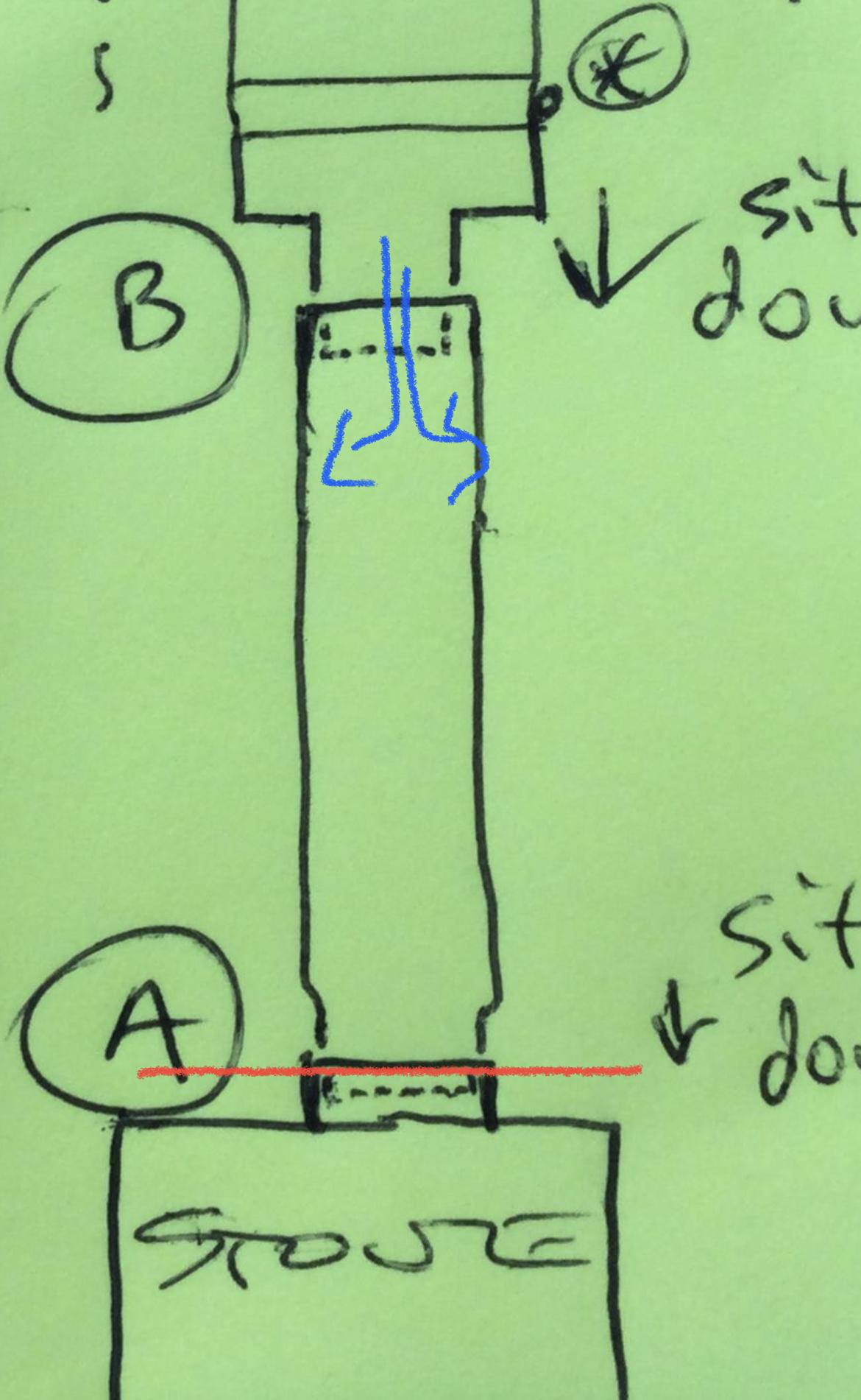

zoothorn Posted May 2, 2022 Author Share Posted May 2, 2022 @PeterW Just to reitterate. I bought a single flue diameter 4", 1m length, going into the stove ( fits, but loosely, a 4mm gap here). Then an adaptor to twin wall. Then a 1m twin wall. Hat. It seems the single length is too narrow at the (lower end) male end. And it seems either it's other female end (higher end) is too wide.. .. or the adaptor's ( into which its top end fits around) lower male end is too narrow. But I just don't know what to expect/ what is normal/ whether these fitting together are all fine, or totally not fine at all. Zoot Link to comment Share on other sites More sharing options...
zoothorn Posted May 2, 2022 Author Share Posted May 2, 2022 Its A) and B) points the issue. Specifically B) because I cannot see what's going on, as I can with A). [Conjecture: even slight movement of the chimney above join B) will compromise whatever is used to help this join here. Less movement at A) & if the cement does fail here with say a tiny bit of chimney movement, I can visually see > re-cement.] All 3 twin sections above B), clamp together just fine. Thanks zoot. Link to comment Share on other sites More sharing options...
PeterW Posted May 2, 2022 Share Posted May 2, 2022 2 hours ago, zoothorn said: bought a single flue diameter 4", 1m length, going into the stove ( fits, but loosely, a 4mm gap here). @zoothorn can you post a link / pic of the enamel pipe ..? I think it’s got male / female ends so using fire cement or HT sealant will be fine. But need to see first Link to comment Share on other sites More sharing options...
zoothorn Posted May 2, 2022 Author Share Posted May 2, 2022 3 hours ago, PeterW said: @zoothorn can you post a link / pic of the enamel pipe ..? I think it’s got male / female ends so using fire cement or HT sealant will be fine. But need to see first Hi Peter. Yes it has the shaped 'male' lower end, I sort of tried to draw this narrowing of it at A). But it's just either slightly too narrow (the dip in/ shaped end almost dips in a bit ott)... or of course, this is fine but my stove hole is judt slightly too big/ too "safely made". Im just in no position to know which it might be, nor whether either is in fact problematic at all. As I have no reference to look at. It could be that each is as should be, & the cement makes it a 'tight fit'. --- But point B)... there is no narrowing of the adaptor, no shaping 'dip' inwards, just the whole section of it that slides into the enamel pipe top, is similarly "loose" a fit. By a few mm's. It's this join that concerns me, as it seems the seal between the two seems to be made simply by the weight of the adaptor/ twinwall/ hat (this whole formed section all banded together well) just resting on ( albeit within) the enamel pipe. If any tiny rocking here... smoke will surely escape into the room. If I put 3mm rope around, it will disintegrate after a while, & I have no way of telling if it has done so. Because I cannot see it. Zoot Link to comment Share on other sites More sharing options...

PeterW Posted May 3, 2022 Share Posted May 3, 2022 @zoothorn from what you’re saying the male end needs to be shortened slightly to fit better into the top however I wouldn’t go too far ..! See the pic attached - red line should be depth of the stove collar on the top of the stove plus 5mm so you can get a decent seal of fire cement. Question .. can you reach inside the stove up into the flue or is there a baffle plate ..?? Next, I would fit the adapter into the top of the stove pipe on the floor, good liberal amount of fire cement around the flange and then reach inside the adapter (wear gloves..!!) and smooth / pack it upward into the gap with a small sponge. (blue arrows) Then let it set and it will be a pretty strong bond once fired. Link to comment Share on other sites More sharing options...
zoothorn Posted May 5, 2022 Author Share Posted May 5, 2022 On 03/05/2022 at 07:44, PeterW said: @zoothorn from what you’re saying the male end needs to be shortened slightly to fit better into the top however I wouldn’t go too far ..! See the pic attached - red line should be depth of the stove collar on the top of the stove plus 5mm so you can get a decent seal of fire cement. Question .. can you reach inside the stove up into the flue or is there a baffle plate ..?? Next, I would fit the adapter into the top of the stove pipe on the floor, good liberal amount of fire cement around the flange and then reach inside the adapter (wear gloves..!!) and smooth / pack it upward into the gap with a small sponge. (blue arrows) Then let it set and it will be a pretty strong bond once fired. Hi Peter, got distracted with tarting up me workshop! back onto these final prep bits/ this job. Thanks for your input. I'm not quite on board tho with 'fit adaptor into stove'. The only adaptor is 1m above the stove, adapting the black enamel single > into the twinwall silver 1m. What I'm wondering ( I think my describing hasn't been sufficient maybe ) is the seating on the 1m single wall, into the stove. This pipe obviously has an inward 'male' end, obviously designed to go into my stove collar. But where should this pipe length actually sit upon? Where should it's weight bear down upon? this is my point. It has two choices. 1). As it is IE just offered up, it sits ( awkwardly) upon a thick welded band around btm of the stove collar. This weld bonds the collar, to the stove. Its a thick, slightly uneven, very handmade weld band. With the pipe sitting upon this, the start of the shaped 'male end dip' of the pipe, is 1" above the stove collar top. Now, I could get all the 4 bits together, have the lot bearing down upon this weld band, get the lot super rigid ( somehow) without any possible movement.... then.... fill up this collar 4mm gap with cement. Somehow. 2) cut 1" off the shaped male end of the pipe. If I do this/ the idea behind this, is that now the weight of the whole 4 bits bear down upon the top of the stove collar. Dry it would of course make a fairly decent join. So somehow then I have to get the 4 bits joined, then, seat the lot into the collar. Then lift it all up, apply cement, seat the lot down. I do not know 2 things still though, X) which of the above methods is best, & Y) & this is still to be understood/ determined, how on earth to join the adaptor to the top of the 1m single length, if I cannot see what's going on ( as Ive tried to explain above). If I had gone twinwall all the way up from stove, I could've factored out the problem Y). I might have also had a better fit into the stove collar too. But it was saving £40 using a single length (& having a huge 6" wide silver flue in the smallish cabin.. would be odd, bulky & incongruous). Thanks, Zoot. Link to comment Share on other sites More sharing options...
zoothorn Posted May 5, 2022 Author Share Posted May 5, 2022 Ok I need to simplify. Step by step Q's. This job looks simple in principle.... but it is not, with the 4 sections I have. Q no.1. If I simply offer the single enamel length, into the stove collar, it hits a band of weld ( stove makers' collar join to stove top). It rocks L to R I'd say a full 8" at the top. So if I let go, the weight of it is resting on this weld join. Is this correct? zh. Link to comment Share on other sites More sharing options...
zoothorn Posted May 5, 2022 Author Share Posted May 5, 2022 Ok, so my upper mark is where the 'male end dip' starts. There's a good 1/2" gap, to the other mark. So the pipe must sit on something inside the stove (orthe two marks would be right next to each other). The thing that prevents the pipe slipping down further, is a thick ring of weld, on the stove, within the stove collar. Pics two & three show how much lateral " give " the pipe has if I rock it max one way, then the other. It doesn't sit nicely flat n flush if I centre it, because the weld band it sits on, is fairly 'rustic' uneven. Zh Link to comment Share on other sites More sharing options...
zoothorn Posted May 5, 2022 Author Share Posted May 5, 2022 So the load is bearing down on the weld, on the stove top. I don't know if this is correct, or, if the load should bear down on the rim of the stove collar TOP instead (the only way this could be achieved, is by cutting off 1/2"+ from the bottom of the pipe. THEN the two marks would be together, a good seal even as it is would be made ( so with adding cement.. surely an even better seal made).. and the load would be bearing down upon the collar rim. The load itself is irrelevant/ there is nothing particularly heavy involved, but where it resides upon, determines (* I would think ) possibly whether a good seal, or a bad seal is formed at this important juncture. * I am only speculating, to be sure, because it is critical a good & correctly made join, is formed: so I may be incorrect & the pics show what is expected/ what is correct/ to proceed as it is. I just do not know. Thsnks, Zoot. Link to comment Share on other sites More sharing options...

PeterW Posted May 5, 2022 Share Posted May 5, 2022 3 hours ago, zoothorn said: So the pipe must sit on something inside the stove (orthe two marks would be right next to each other). The thing that prevents the pipe slipping down further, is a thick ring of weld, on the stove, within the stove collar. Using a decent angle grinder disc, cut 20mm off the male end of the enamelled pipe. This then will sit nicely inside the ring plus a nice smear of fire cement will seal it all. Link to comment Share on other sites More sharing options...
PeterW Posted May 5, 2022 Share Posted May 5, 2022 3 hours ago, zoothorn said: Is this correct? Yes - see above. When you have this lot all done up there will be no rocking as there is mm movement in those rubber seals when they are fitted. Link to comment Share on other sites More sharing options...

zoothorn Posted May 6, 2022 Author Share Posted May 6, 2022 Or maybe this helps clarify my Q no.1. ((Which is correct?)) Thanks, zoot. Link to comment Share on other sites More sharing options...
ProDave Posted May 6, 2022 Share Posted May 6, 2022 It matters not one jot what the pipe sits on, you just need to seal it with fire cement. Cutting a bit off the bottom will mean it sits on the top of the fitting so will sit more level while the fire cement sets. I would hold the pipe up slightly so you can fill all around with fire cement filling the gap then let it drop down so the tapered bit sits on the top of the stove fitting then leave it for the fire cement to set. But before you set it, you want to sit the pipe there, check it's upright, project up and mark and cut the hole in the roof for the twin wall section. Link to comment Share on other sites More sharing options...
