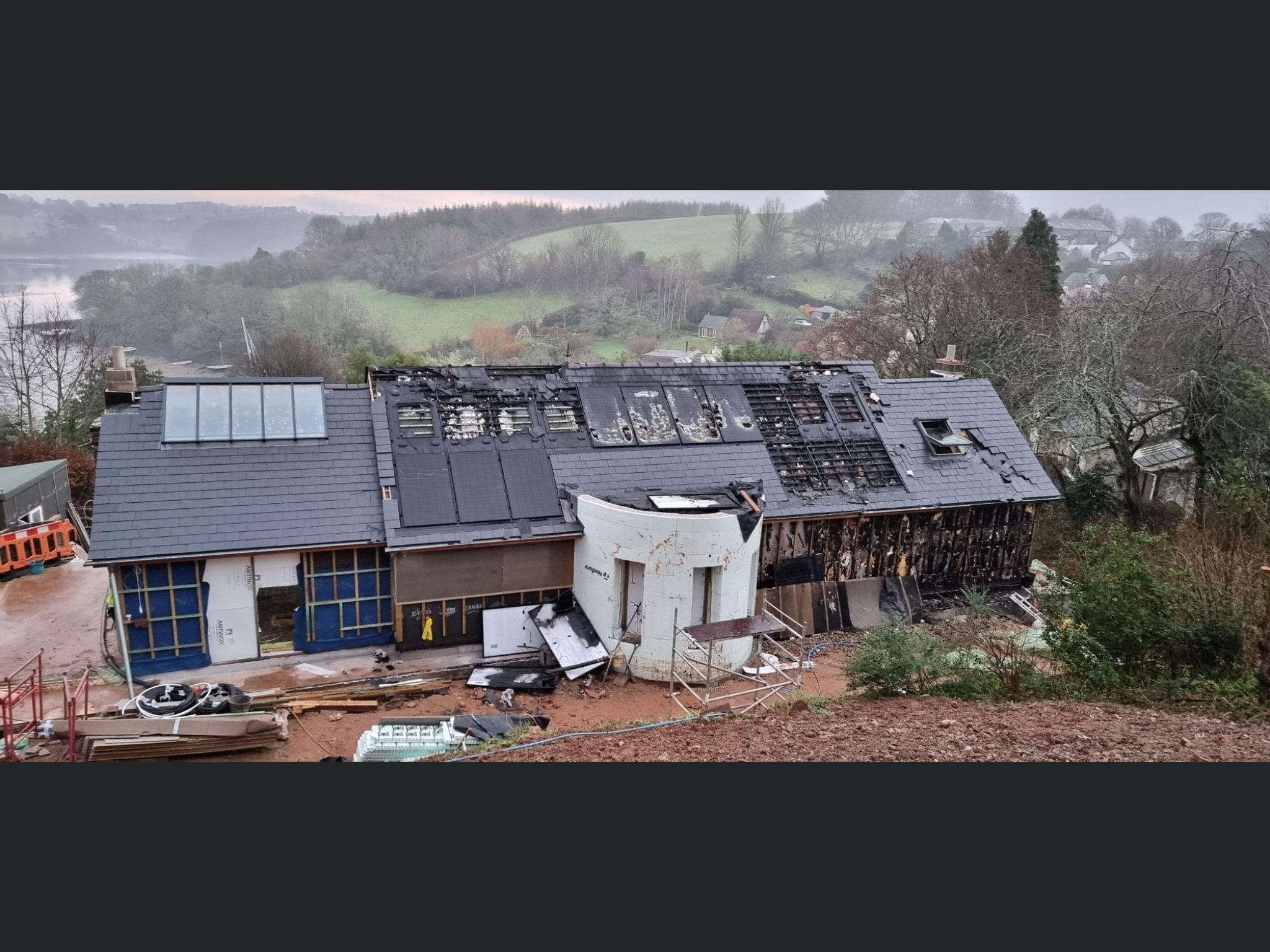

Russell griffiths Posted January 18, 2022 Share Posted January 18, 2022 All I will say is ONLY run them when you are on site, I make sure every night that I have unplugged everything before I Leave, I had a heater running from an extension lead the other day and when I unplugged it the plug was unpleasantly hot. 1 Link to comment Share on other sites More sharing options...
