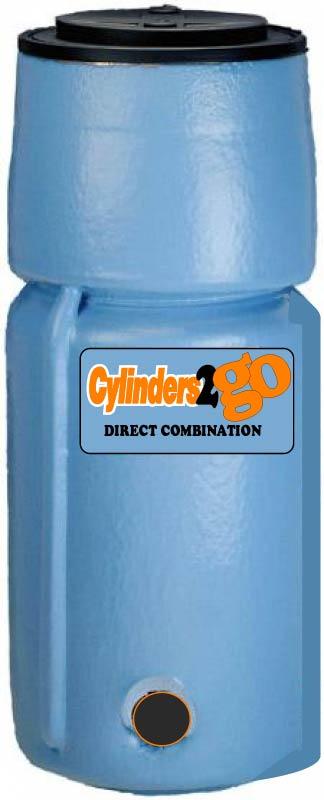

19 minutes ago, Jenki said:
o my plan was  250L Thermal store (to eliminate the G3 requirements) also the thermal store should prevent any issues with flow rates on the heat pump.
A thermal store is a very bad match to a heat pump.  For a thermal store to work the water it stores has to be quite a lot hotter than than the hot water delivery temperature or else it will only have a tiny capacity before your hot water starts to go cold.  And heating the water in the thermal store much hotter is not what heat pumps are good at.
Many of us find heating the hot water to 48 degrees in an UVC works well and when you run the hot tap you get pretty much a constant 48 degrees until it runs out and then goes cold quite suddenly.  The G3 won't add much cost if you can find a plumber you get on with where you do the bulk of the plumbing and just get him to connect the cold water with all the pressure control gubbins and test and certify it.  Several have done that.  I just asked a plumber I have met on several jobs and he was happy do do it for not much money.  building control will expect to see the G3 sign off.
  • Thanks 1

2 hours ago, Jenki said:
Do you mean just immersion heaters for DHW, or electric boilers?
I've Built several large extensions with Wet UFH and loved the result, so my plan was  250L Thermal store (to eliminate the G3 requirements) also the thermal store should prevent any issues with flow rates on the heat pump.
but this is way down the line so open to more research if you can point me somewhere.
Immersion for DHW. Maybe a Willis heater for UFH like @TerryE's system.
I haven't seen it done but maybe install a large UVC with a coil for ASHP. Then use that coil to take heat from the cylinder heated from immersion. It would give you the option to retrofit an ASHP if that became a more economical option.
We have no G3 in Ireland so I did my own UVC. ( I did a topic somewhere if you search) It's really not too tricky. This man explains all.
If you have a good plumber they'll check and sign off on your install I'm sure.
Smaller thermal stores like the 250l one you mention work best with high temp heat sources like fossil fuel boilers. However I do like the principle. Maybe a very large coil in tank thermal store (>500l) run at a lower temperature would work. I'm sure some of our plumbing gurus can advise. Infact I'm keen to know myself.
  • Thanks 1

HOLD PRESS!!
No need to reinvent the wheel. Thermal Stores and heat pumps are already a thing.
https://www.thenaturalenergycompany.co.uk/shop/index.php?route=product/product&product_id=300
Physiologically I like the idea of not keeping 300l of hot water at 3 bar all day every day in an UVC. Relying on over temp and over pressure valves for safety seems like it's an inherently less safe solution than an open vented Thermal store in the case of run away immersion etc. While the case for solar PV over thermal is well proven the thought of being able to pick up a couple of cheap panels and a pump and rig a drainback system is nice.
However I don't know of anyone who uses a thermal store with a heat pump.
@Jeremy Harris had issues but I think that was probably because his TS was too small (210l or 250l I think) for an ASHP (needed to be run at high temps for sufficient hot water)  and suffered high heat losses in a very low energy demand house leading to overheating.
