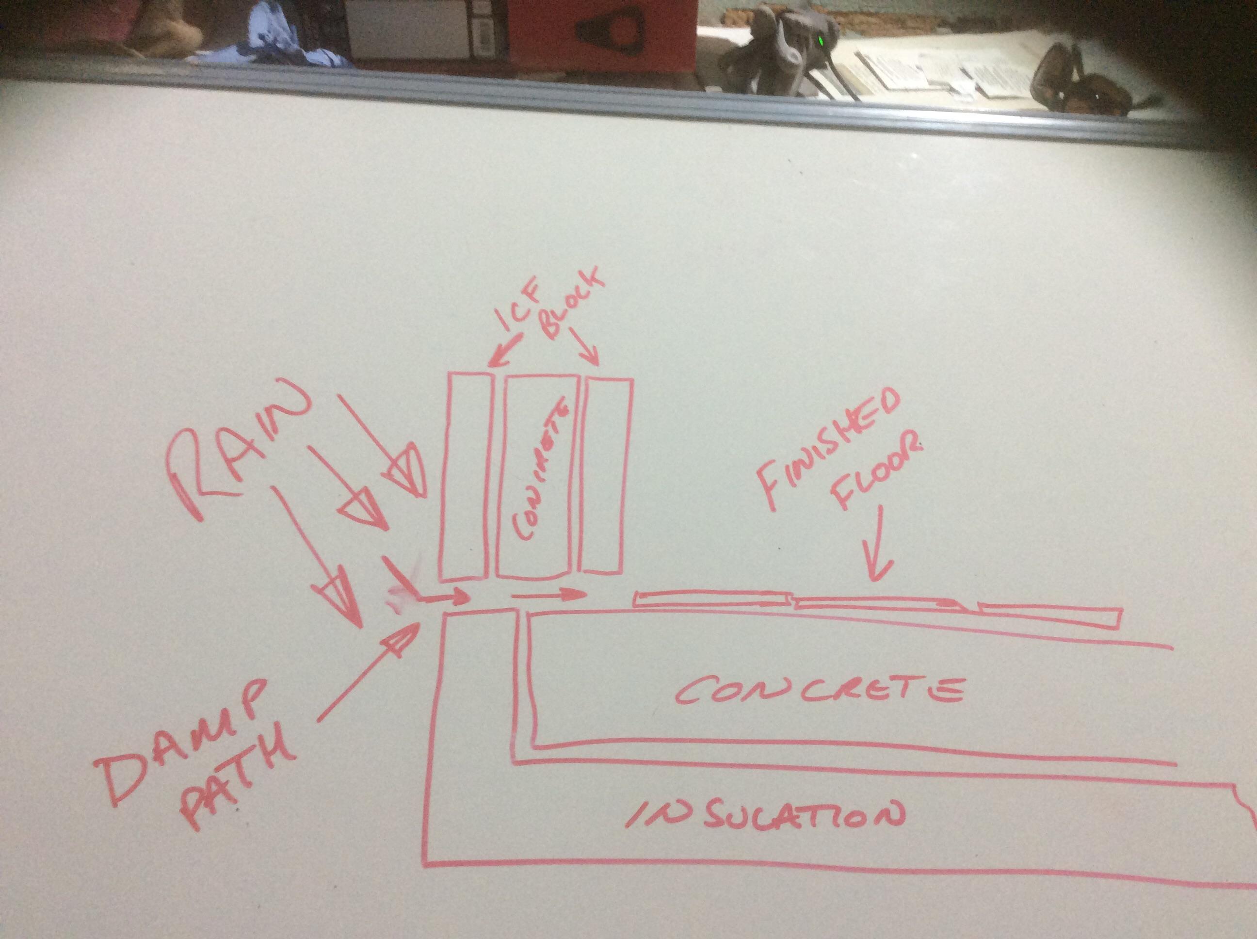

Russell griffiths Posted January 11, 2022 Posted January 11, 2022 (edited) I have a major issue with icf onto an insulated slab, having built a house on a raft foundation we included a step at the edge, but seeing first hand how these are being built at the moment I really do not like the method of the flat slab with the icf sitting directly on the slab. There is a direct route for moisture to pass into the building at floor level. see rough sketch. @IanMcP you need to be a bit careful using Nudura standard details, as it’s all a bit Canadian and needs adapting to suit your site. Edited January 11, 2022 by Russell griffiths 1
IanMcP Posted January 11, 2022 Author Posted January 11, 2022 @Russell griffiths thanks , I'm leaning heavily towards standard strip foundation (and load bearing internals), some frost insulation on the outer side (could be overkill but cheap considering) , ICF & waterproof concrete coming from the top to above ground level, then ICF away we go... insulated ground bearing slab with UFH butting up to the ICF above what would be damp level. Could be any ICF in that config. front runners are Nudura and Polarwall (Alan is great!) oh and that drawing looks angry !! ?
willbish Posted January 11, 2022 Posted January 11, 2022 41 minutes ago, Russell griffiths said: There is a direct route for moisture to pass into the building at floor level. Do Nudura specify a swellable water bar at the junction? I was told this was essential
FM2015 Posted January 11, 2022 Posted January 11, 2022 39 minutes ago, willbish said: Do Nudura specify a swellable water bar at the junction? I was told this was essential Not essential. Depends on warranty provider, architect, design etc. Tend to stay away from to the waterbars that swell. You need a dry day to install and then want keeping dry until covered with concrete. Sika do a physical stop. More practicable. Get your outside done right and nothing else should be tested. Waterproof concrete is a waste of money. Something outside and something maintainable inside gives lowest cost option and satisfies most conditions. 1
Adam2 Posted January 11, 2022 Posted January 11, 2022 4 hours ago, willbish said: Do Nudura specify a swellable water bar at the junction? I was told this was essential As above, warranty provider is key. Ours (Nudura) on a concrete slab with raised section under walls to help restrict water ingress and also helps keep water bar above any standing water. Just keep scaffold boards or something else in top of walls and maybe a few drainage holes if you think needed at wall base and don't forget to fill later ?. Also used waterproof concrete all from BASF. Seems to work so far ? I don't think Sika will warranty for ICF any more.

Tosh Posted January 13, 2022 Posted January 13, 2022 We recently done trenchfill, then a course of ICF to GFL. 1st course filled with waterproof concrete as our DPC. Others are correct in that Sika won't warranty their admix in ICF method. I spoke to them directly and that's what they said. However, they also said that's not to mean it won't work. The only reason they won't warranty it was because they can't check it hence eluding not to the ICF itself per se but the quality control of the installation which they can't check like normal formwork which is removed and can expose any honeycombing. So we paid particular attention to ensure the mix was delivered per the spec along with careful pokering. That still leaves the detail at the top of foundation/bottom of ICF as @Russell griffiths mentions to deal with - in our case we've used an external waterproofing membrane up to ground level on the ICF and lapped over the top of the trenchfill to take any groundwater away from that junction into the land drain. Overkill possibly but for £500 of materials I'll rest a little easier.
