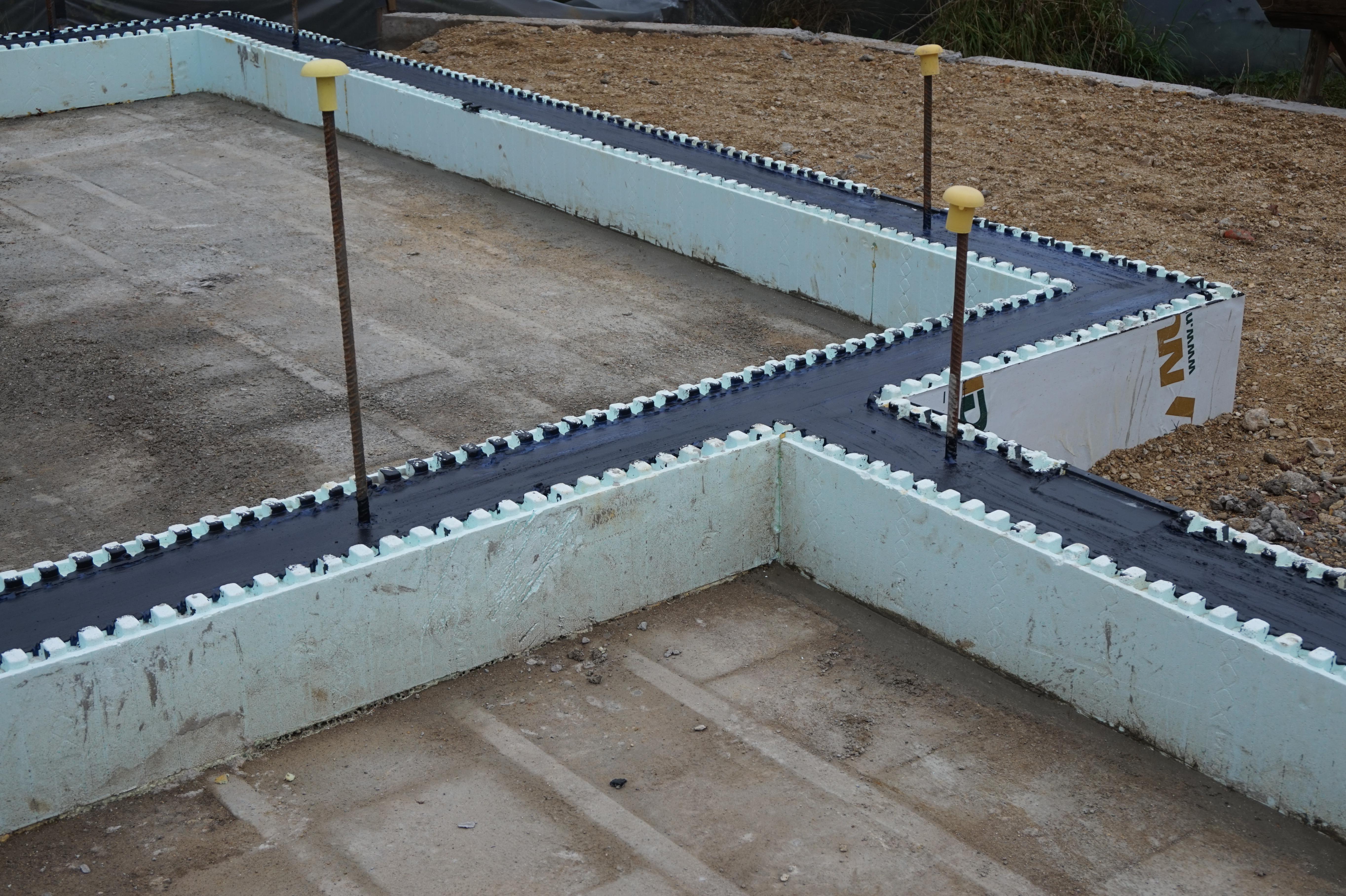

image.png.f32f00bc45737b8e6d585b40b7135fb7.pngwe thought about doing a pour up to the top of the 1st course of ICF then coat it with this stuff or similar, then build next lift up to 1st floor followed by 2nd pour.
just in case you're not aware (or others reading this later) you need to use a non-solvent based product if applying on the EPS, eg the Triton product TT something which is a paint on waterproofing barrier as used by a few on here with ICF builds. Though I don't know if the BBA cert for any of them would cover use in this specific scenario.

2 hours ago, Tosh said:
very true, Blackjack BBA cert covers use on insulation
I would be very careful with this and wouldn’t believe a word of it.
I used the triton TT liquid which is very good, then being a tight arse I used a solvent free black jack type product, it looked ok for 4 months but has now started to eat into the eps, I have to cut it all back and remove the blackjack stuff.
It really needs to be water based and not  bituminous  based.
Pain in the arse lesson.

Buy the triton, get two or three tubs as you can use it anywhere you want to make the block more airtight, window reveals and other stuff, you can also paint it on to get airtight tape to stick. Very little likes to stick to the eps.

so true...before we done our pour I tried taping up all the nibs on the top of the blocks to try and prevent concrete filling them up. I got some fibre reinforced tape which wasn't too bad, it did the job but was far from what I would say really sticking to the EPS.

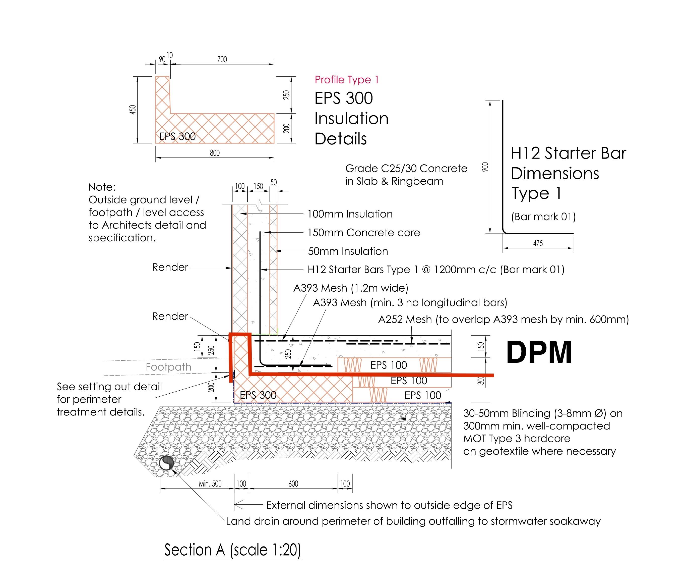

On 11/01/2022 at 17:27, Russell griffiths said:
I have a major issue with icf onto an insulated slab, having built a house on a raft foundation we included a step at the edge, but seeing first hand how these are being built at the moment I really do not like the method of the flat slab with the icf sitting directly on the slab.
There is a direct route for moisture to pass into the building at floor level.
see rough sketch.
@IanMcP you need to be a bit careful using Nudura standard details, as it’s all a bit Canadian and needs adapting to suit your site.
I assumed the shear weight of concrete in the wall helps slow the water ingress? On my build the ICF overhangs the insulated raft by 9mm, this is before the 10mm of render. The DPM laps over the top of the foundation insulation. Not had the rendering done yet, but assume there is a drip edge. They used PU foam when putting the blocks down, which I know is not water resistant. Perhaps I should use some TT Vapour Membrane paint along this edge. The good thing about EPS is that the water it absorbs, easily evaporates away, this is what makes it preferable to XPS. I don’t doubt that some water will ingress at this junction, but will it be substantial enough over the long term to cause issues?
If it's above ground, it really shouldn't get tested.  Prolonged hydrostatic pressure would be required.  The range of belt and braces options is huge.

What do you want it to do. Dpc you shouldn’t need anything, use a waterproof additive in your concrete and your good to go. I used it for something completely different, just to keep bc happy.
don’t use black Jack for anything, it’s bitumen based and will melt your blocks.
