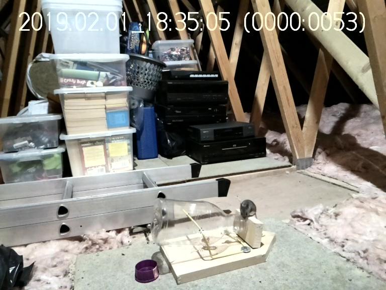

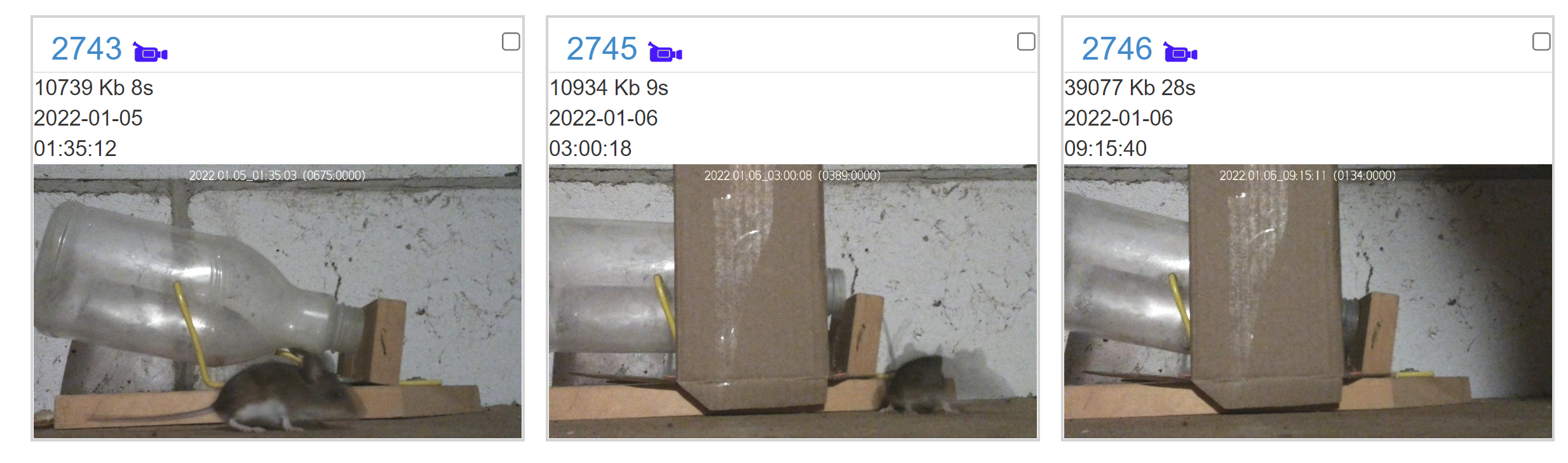

The night before last, the little bu99er climbed on top of my DIY seesaw bottle trap locking it down with him on the outside. Look how he frantically wants to get inside to munch the peanut in there! How ironic.
So yesterday I made an arch out of a cardboard box to stop him climbing on top. At 3AM he got the bottle half way down by gingerly leaning into the opening, but it wasn't until later that he lost all will power and got completely inside. BINGO!
466672954_Screenshot2022-01-0621_13_34.thumb.png.b44ee289eee6c5e8e93573bd83d751fd.png
Next stop, the back of Sainsbury's car park two miles away ?

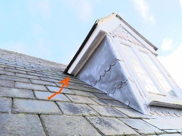

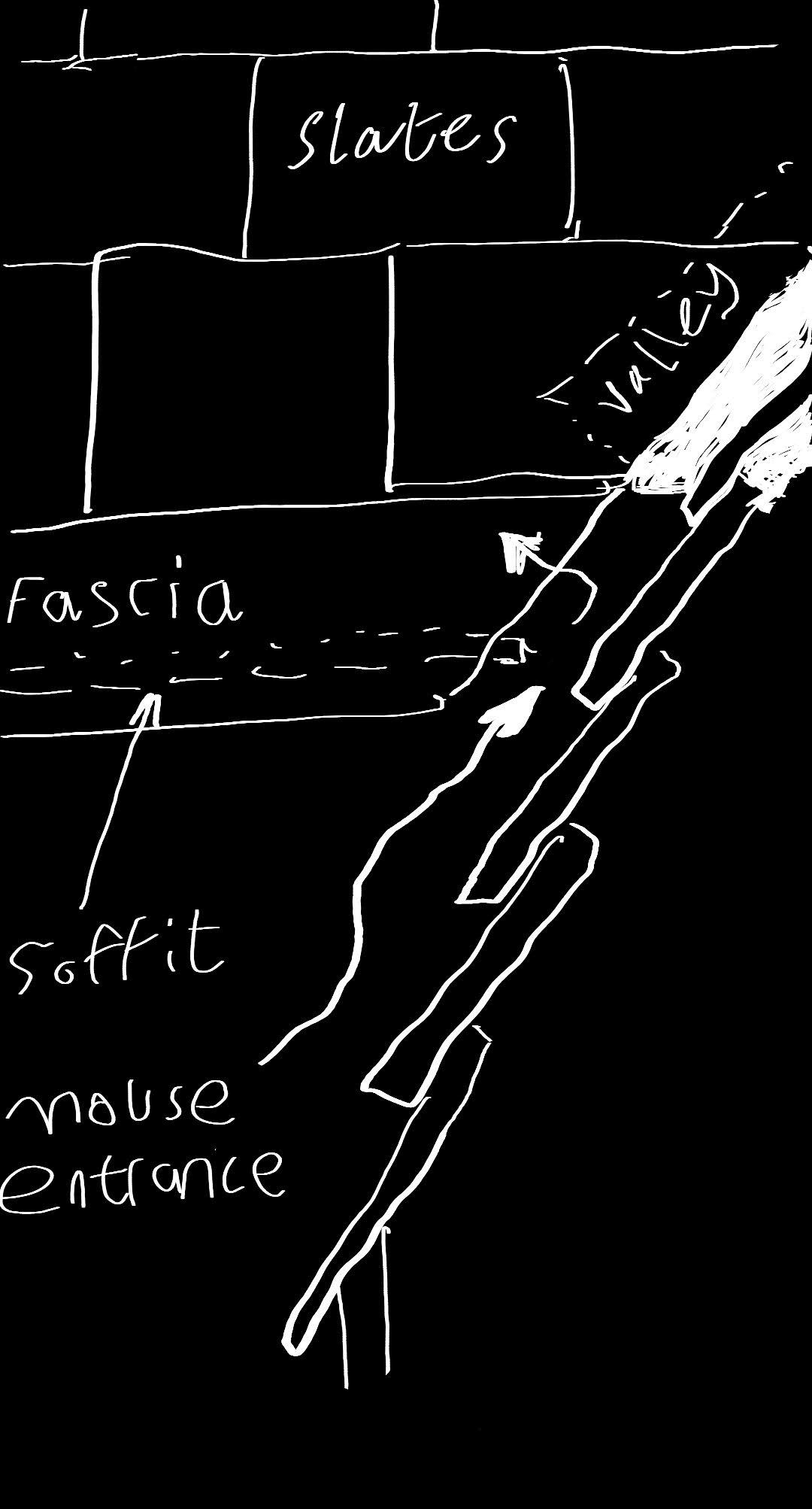

But enough of that. I want some ideas how to stop? getting in. I think I know where as there's a very obvious entry point into the soffit box. This seems inevitable because it's where the eaves meets a perpendicular roof at a valley something like this:
The cross section sketch shows the mouse entrance at the gap between the timber fascia and adjacent roof. The gap is necessary as water cascades down the GRP valley and down to the lower gutter. Looking at this junction from the inside of the loft I can see daylight here.
The obvious solution is to spray foam the gap from inside the soffit box but this will bridge the fascia to the valley gutter and rot it out. The eaves have plastic vent trays all the way along the bottom of the first row of slates but stop at the gap no doubt for the same reason. Seems like a stupid design.
Best of luck but I doubt you will stop them.  A cold roof has to be ventilated, and a mouse can get through a hole that a biro pen will fit through, i,e, through the holes in a standard air brick or soffit vent.  I used to deal with them with poison no messing and no return.
This is why I am such a fan of an airtight warm roof design, the buggers have not got in this house yet.
Yeah. I sure wish it was a warm roof. However, I think the vents have small enough gaps: smaller than fly size. I've checked all round the other soffits and all are well caulked. Just the two valleys seem to stand between me and peace and quiet.
If you're up for modifying the roof, I'd create a vertical abutment in plywood where the dormer eaves meet the roof, with lead flashing, here:

Having trapped the mouse on the 6th of January, we now have another one running around in the attic less than two weeks later. After we got rid of the previous one I spent the day going around the perimeter of the house looking for entrances. There was nothing. But at head height, the sloping roof of our lean-to utility room had about 1cm gap between the eaves vent and the stonework of the house. This could have gotten a mouse into the soffit box, up the outside of the insulation panels and into the second attic. A generous squirt of acrylic sealant sorted that gap.
But this new mouse definitely didn't get in that way. The acrylic plug is still intact. As is the squirty foam filling I did in the main attic at the valley junction between the two roofs. Just to explain, the two roofs create two attics because indoors, the two halves of the house are separated by a double-height hallway that goes all the way up to the ridge. The steel beams supporting the ridge and wall plates, however, form three tunnels linking the two attics. Handy for wiring but also highways for vermin.
The problem now is that there are a couple of obvious entrances either side of this dormer window:InkedIMG_20220118_103959592_LI.jpg.ad132c041031341c23ad3196abe6109e.jpg
This is the same kind of problem where the soffit stopped at the junction between roofs. I could get at that junction from inside the attic to block it but this dormer isn't as accesible. I can't see inside and around the corner to this gap. So I'm not sure how to close it from the inside or the outside. I don't want anything to bridge between the slate and wooden fascia.

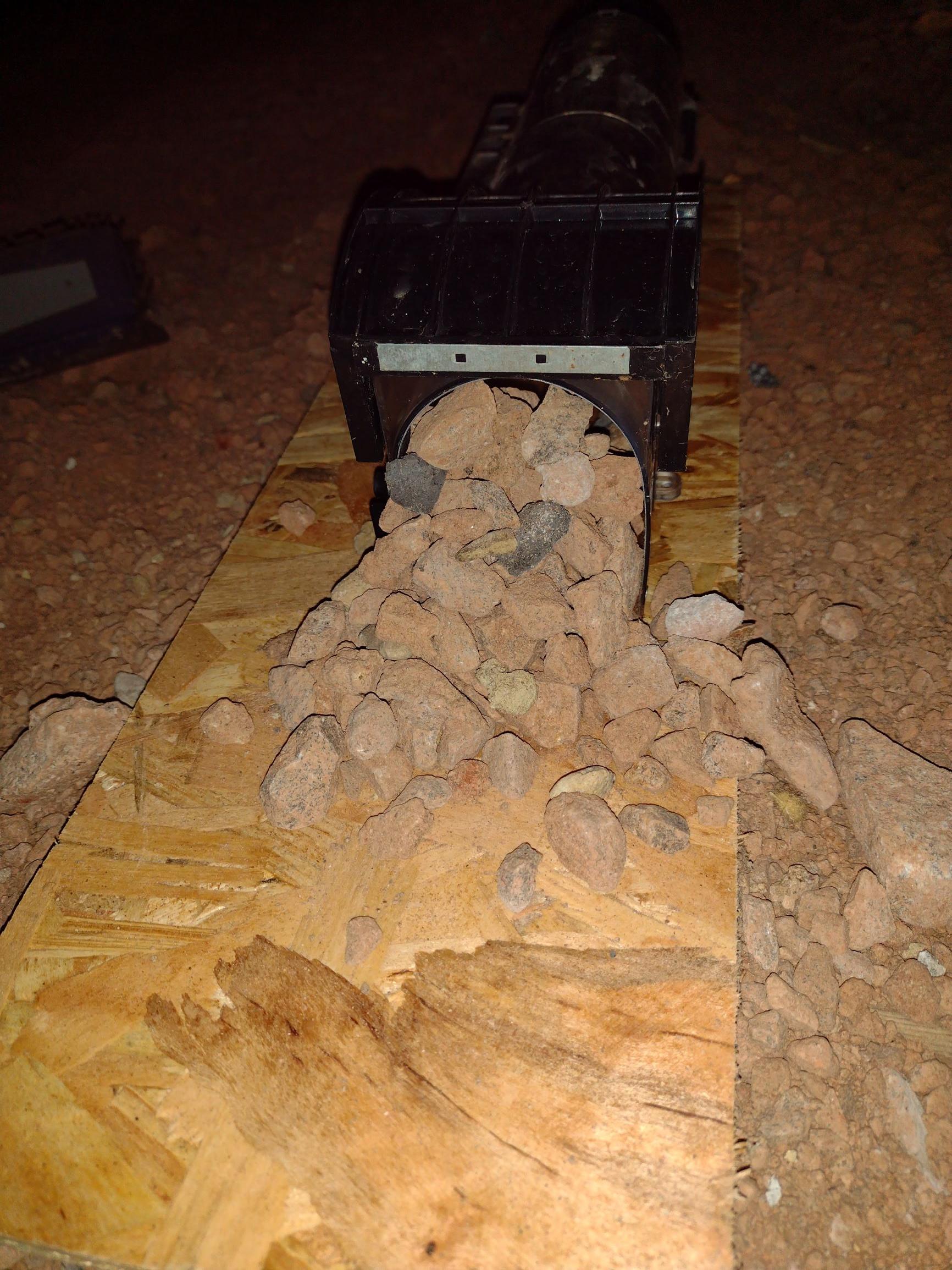

You mean it shifted all those stones into it? Why I wonder - was it trying to protect its mates?
43 minutes ago, SimonD said:
Speaking of mice, we've got some in the very unfinished portion of the house. I've gone round and blocked up all the holes I think they can get in through yet still they come. One of them is very clued up as it's noticed the dangers of the humane traps I've been using and did something about it - not just once but 3 times!:
WTAF?
I wonder whether it's viewing the trap as a potential nest, and dragging in some materials to close off the entrance a bit?
