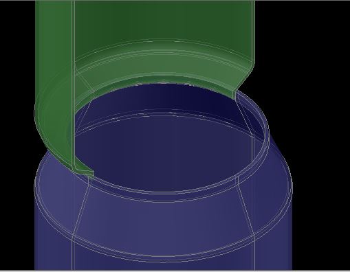

Onoff Posted April 26, 2017 Author Share Posted April 26, 2017 Started on the CADCAN! (As opposed to CADCAM....) Who knew? When you stack 150mm high 440ml Fosters cans you lose 2mm as they interlock: 1 Link to comment Share on other sites More sharing options...

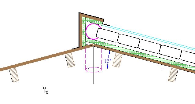

Onoff Posted April 27, 2017 Author Share Posted April 27, 2017 (edited) Something like this I guess for a shallow pitch with an "apex" take off pipe? Cans painted black under glass (blue), draw up from the bottom into the larger collecting tube at the top suitably insulated. Ply carcass (brown) with a lead cap (black). Lets be honest, if you were clever you'd build it into the shed roof design from the start and save on a bit of felt No reason why that bottom 18mm board couldn't be the OSB shed roof itself. You could then draw heat DOWN via a 110mm T: (Good luck getting magenta soil pipe though.......... ) Edited April 27, 2017 by Onoff Link to comment Share on other sites More sharing options...

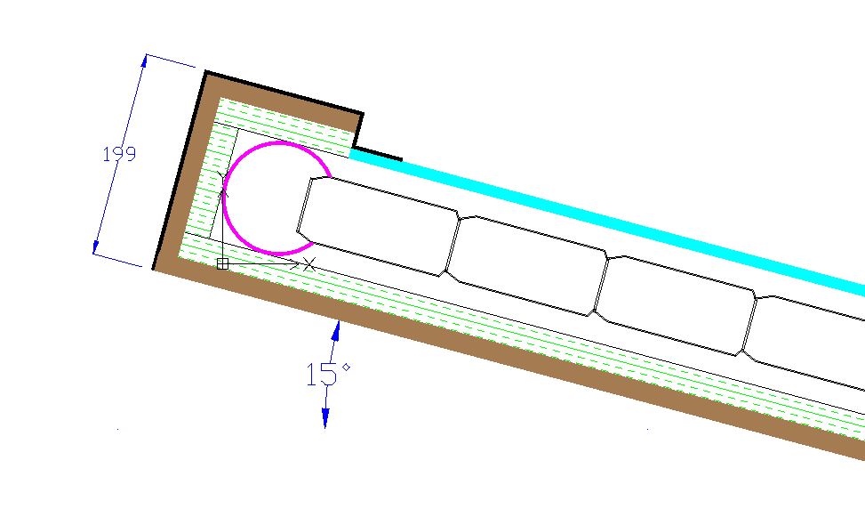

Onoff Posted April 27, 2017 Author Share Posted April 27, 2017 Another brain fart: Link to comment Share on other sites More sharing options...
SteamyTea Posted April 27, 2017 Share Posted April 27, 2017 Don't you want the glass to cover the top, stops rainwater pooling at the lower edge. Or you could just mastic on a second sheet of glass to totally cover it. Link to comment Share on other sites More sharing options...
Onoff Posted April 27, 2017 Author Share Posted April 27, 2017 (edited) 12 minutes ago, SteamyTea said: Don't you want the glass to cover the top, stops rainwater pooling at the lower edge. Or you could just mastic on a second sheet of glass to totally cover it. I've just shown a lead flashing (as in if money were no object ). Figured a run of sealant between that and the "glass". Not sure where it would pool? Only playing with it tbh. EDIT: I'll get bored soon! Edited April 27, 2017 by Onoff Link to comment Share on other sites More sharing options...
Nickfromwales Posted April 27, 2017 Share Posted April 27, 2017 Liking it, but the shed roof would need to produce wet thermal heat to warm my TS's ? Got me thinking of an 'active' roof now made at a steeper angle out of 30mm box section steel...... ? Back to work. Link to comment Share on other sites More sharing options...
Onoff Posted April 27, 2017 Author Share Posted April 27, 2017 40 minutes ago, Nickfromwales said: Liking it, but the shed roof would need to produce wet thermal heat to warm my TS's ? Got me thinking of an 'active' roof now made at a steeper angle out of 30mm box section steel...... ? Back to work. For some reason I thought you wanted to just space heat the shed. So.....could you take the hot air stream thru a coil in the tank instead of the usual water in the coil? Would the temperature lessen as you reduced the pipe size? As you can guess I'm firing on random today! Link to comment Share on other sites More sharing options...
