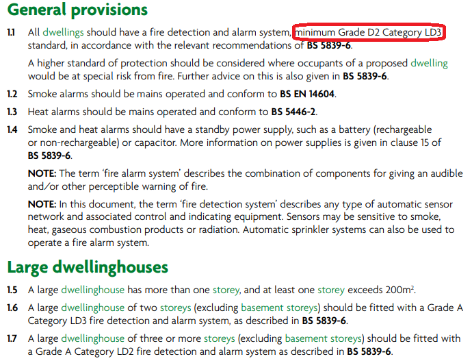

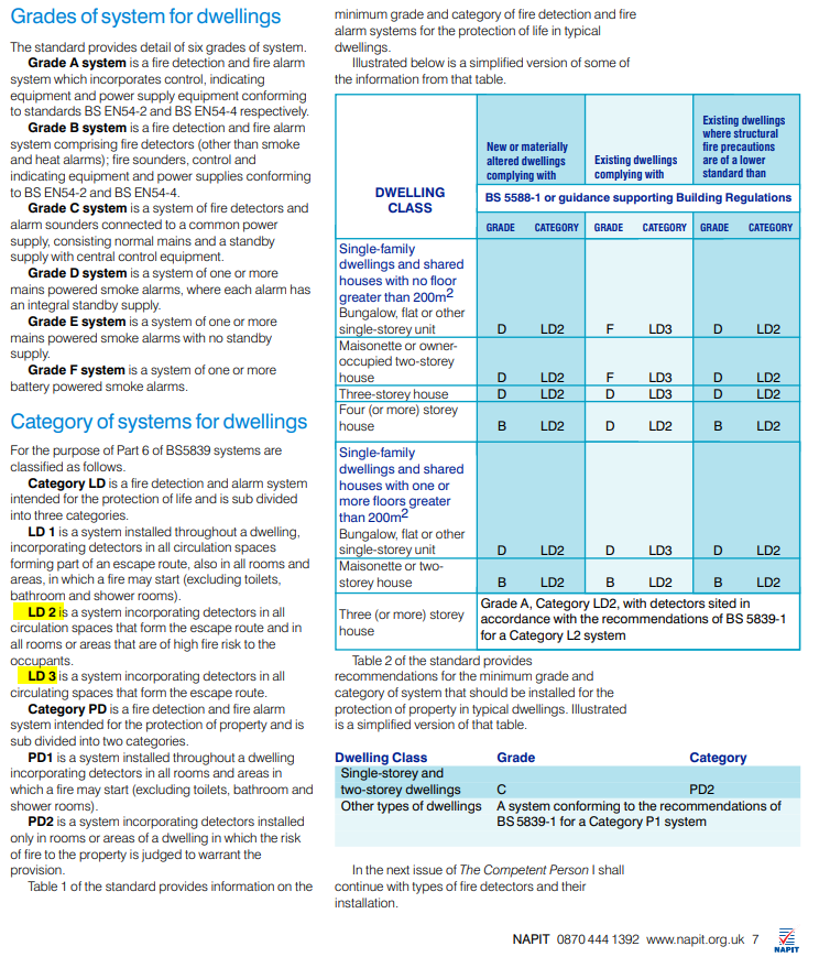

MortarThePoint Posted November 12, 2021 Author Share Posted November 12, 2021 A couple of sources below including from Part B. Looks like hallways and kitchen (though not always) are required. "If your kitchen is not separated from the stairways or circulation routes by a suitable door, then you must also install a compatible heat detector in the kitchen, interlinked with the other smoke detectors positioned as above in the circulation routes" https://www.tameside.gov.uk/buildingcontrol/guidancenotes/note16.pdf Link to comment Share on other sites More sharing options...

PeterW Posted December 7, 2021 Share Posted December 7, 2021 On 12/11/2021 at 11:40, MortarThePoint said: I know where I want to have smoke alarms, but I as wondering where the regulations require them. Reason being is I could fit more discrete battery ones in the rooms that aren't required by regulations. As I understand it, I need to have them "in all circulation spaces that form the escape route and in all rooms or areas that are of high fire risk to the occupants". Now that second bit is open to interpretation. Do building regulations require them in rooms with wood burning stoves. I know CO alarms are required but what about smoke alarms. I want smoke alarms in these rooms, but would prefer more discrete battery ones. So speak to your BCO now. To meet D2 you need to have hard wired connections between all smoke alarms. Fishing out a new link wire is not easy when your ceilings are up. Link to comment Share on other sites More sharing options...
Mr Punter Posted December 7, 2021 Share Posted December 7, 2021 1 hour ago, PeterW said: So speak to your BCO now. To meet D2 you need to have hard wired connections between all smoke alarms. Fishing out a new link wire is not easy when your ceilings are up. You can get RF ones in the Aico range which I think are considered acceptable. More money though compared to hard wiring but can get you out of trouble. Link to comment Share on other sites More sharing options...
