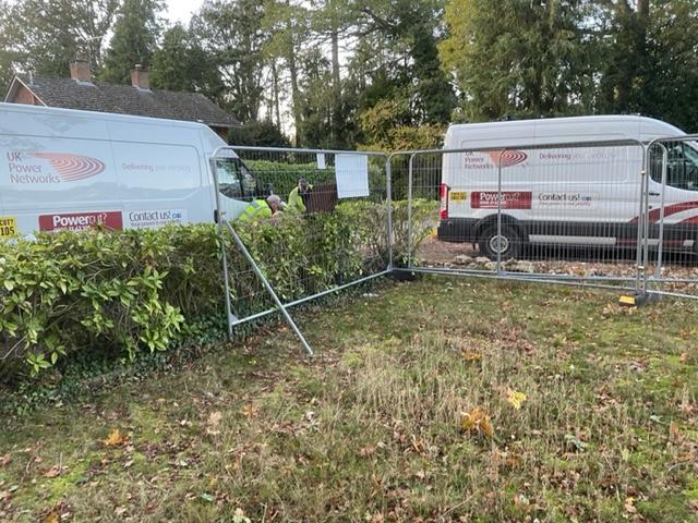

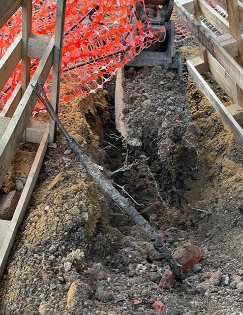

Hilldes Posted November 1, 2021 Author Share Posted November 1, 2021 @ProDave @Moonshine My son was driving the digger. We were just digging a small hole down the outside of a brick built manhole - to see what kind of soil pipe we need to connect into. Basically the power cable came in a line above the soil pipe we were excavating then took a 90 degree turn just short of the manhole and then made its way past the manhole into the road. Will post a picture tomorrow showing the repair and the route the cable takes. There was no flash or bang as the digger pulled the cable out of a coupler. No one injured. No mention as yet what this might cost. The question is how to avoid this. I could hire a CAT scanner but not sure how effective they are. When UKPN came to do the survey before we disconnected the bungalow we ultimately demolished they really struggled to locate the cable entry point into the house- even with a signal generator. I spent a day digging a hole by hand but the cable was not there. They came back and with a very week signal from another CAT scanner we dug and located successfully. Who do you go to to get the route of all utilities across your property? And how accurate is this? Link to comment Share on other sites More sharing options...

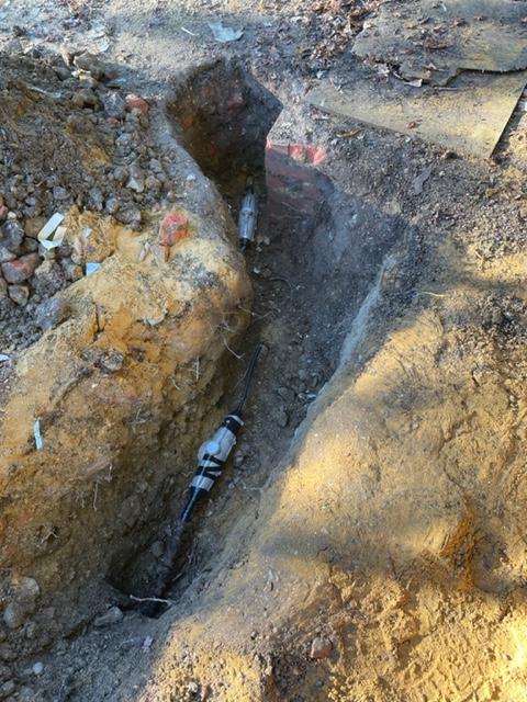

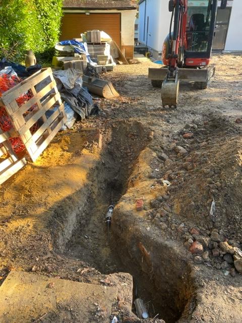

Hilldes Posted November 2, 2021 Author Share Posted November 2, 2021 Pic of the repair, in the driveway facing the road, you can see the brick wall of the manhole on the driveway. The soil pipe entering the manhole should be another metre below the power cable. Now we know to connect in to the soil pipe we need to dig beneath the power cable. The second pic is looking back from the manhole at the road end of the driveway to the garage, the electric and gas enter the garage to the right of the door. We may be digging this trench by hand just to confirm without doubt the route of power cable and gas pipe. P.S. have hired a CAT scanner - as a minimum so I can say we used one if we did hit anything else. What I've learned from using it so far is: It confirms what you think you know already - i.e that the cable runs in a straight line between manhole and the garage It does not really confirm what you don't know already - i.e. the cable route for the short hop from the manhole to the road. I think maybe the cars on the drive had energised cables that were affecting to reading so will try again later. Link to comment Share on other sites More sharing options...

Hilldes Posted November 2, 2021 Author Share Posted November 2, 2021 1 hour ago, Dave Jones said: do you think they updated the maps for next time ? Would be nice wouldn't it?. Right now we are painstakingly pulling off only the drive hardcore with the digger then digging the rest of the depth by hand to follow the route of the live gas and electric supplies. We have loads of flint in the ground - it's about as fast as an architectural dig. But still, once we have the live services fully identified, it should be quite straightforward to trench with the digger for the soil, surface water, water and BT. Link to comment Share on other sites More sharing options...
