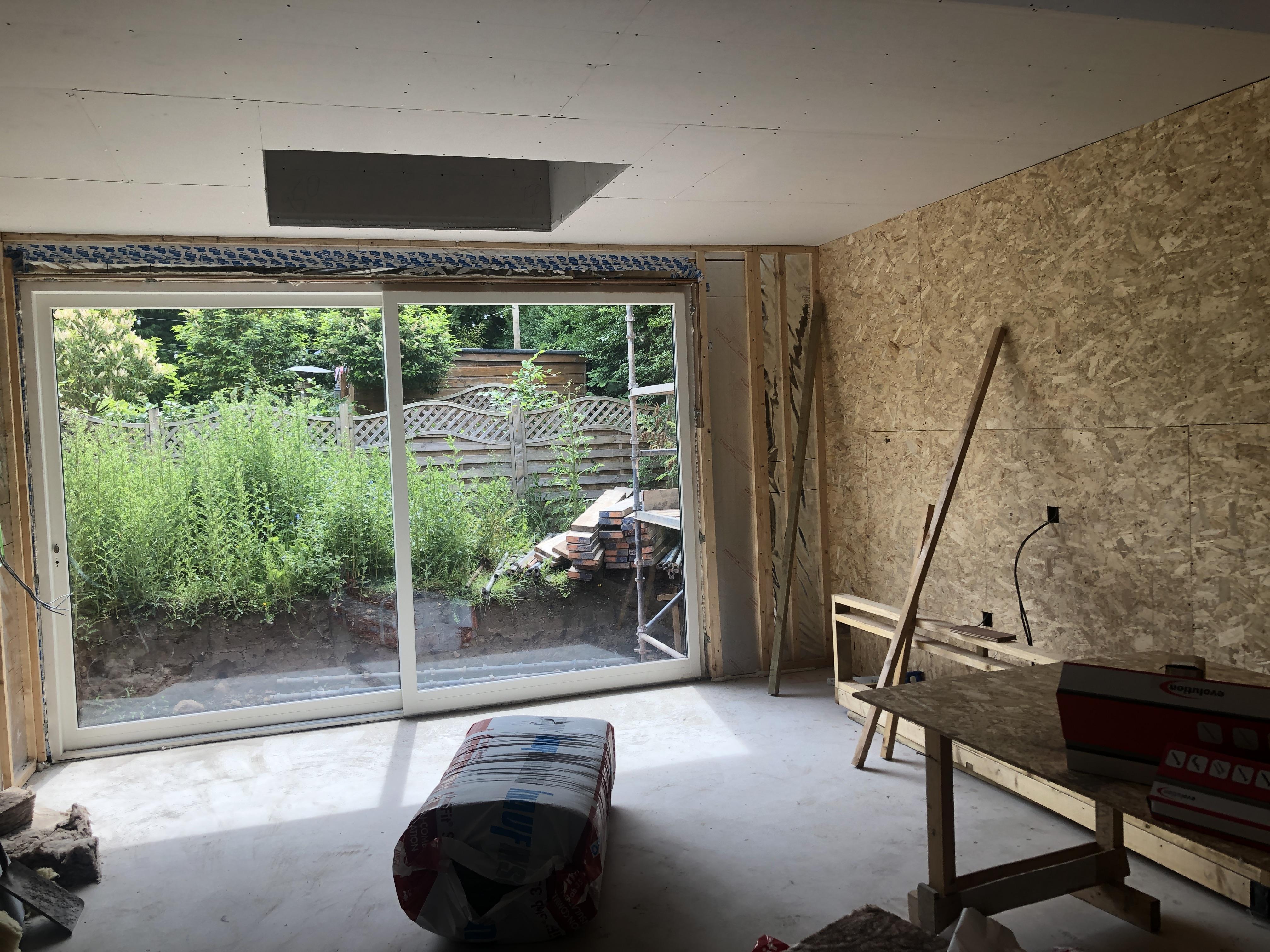

AliG Posted June 17, 2022 Share Posted June 17, 2022 The issue is the lack of space. The window has to come through this area (outside the window fitted here) Link to comment Share on other sites More sharing options...

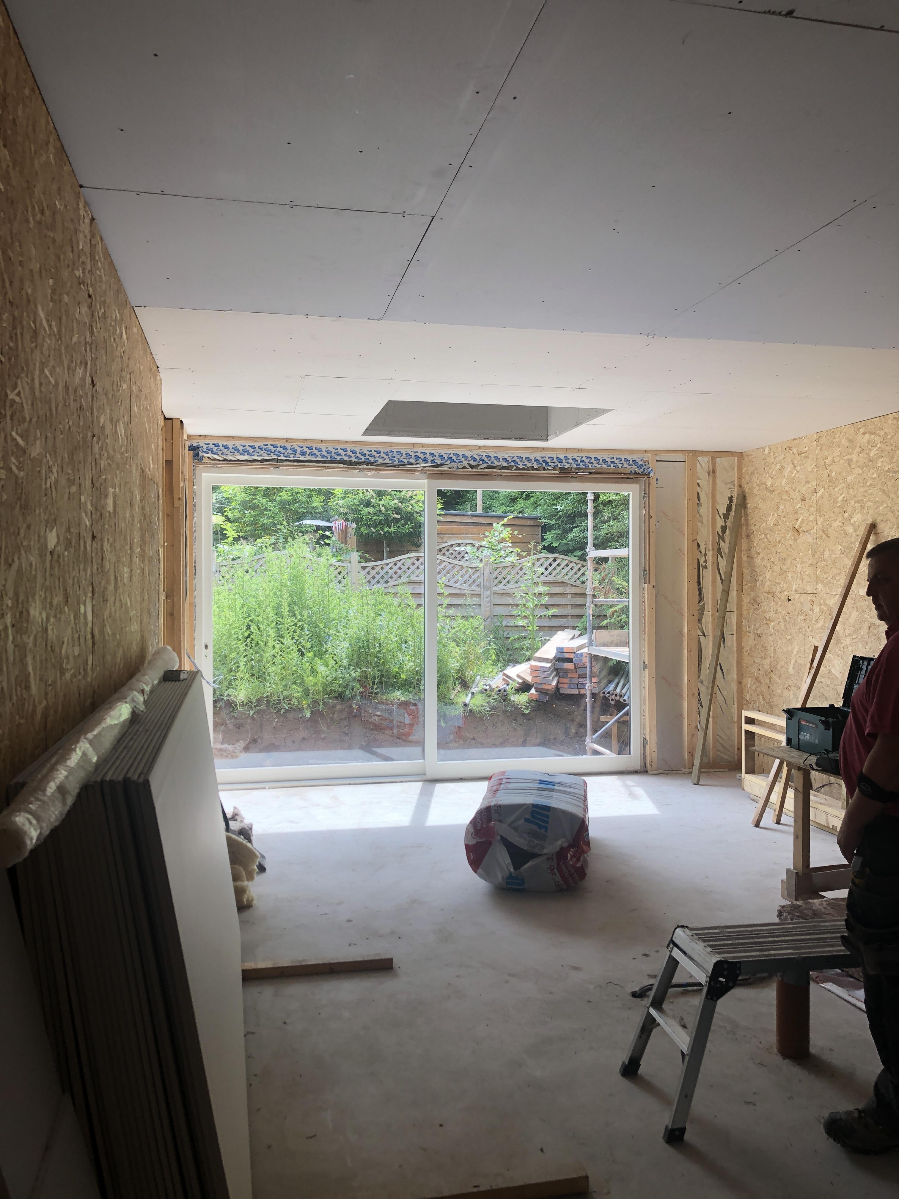

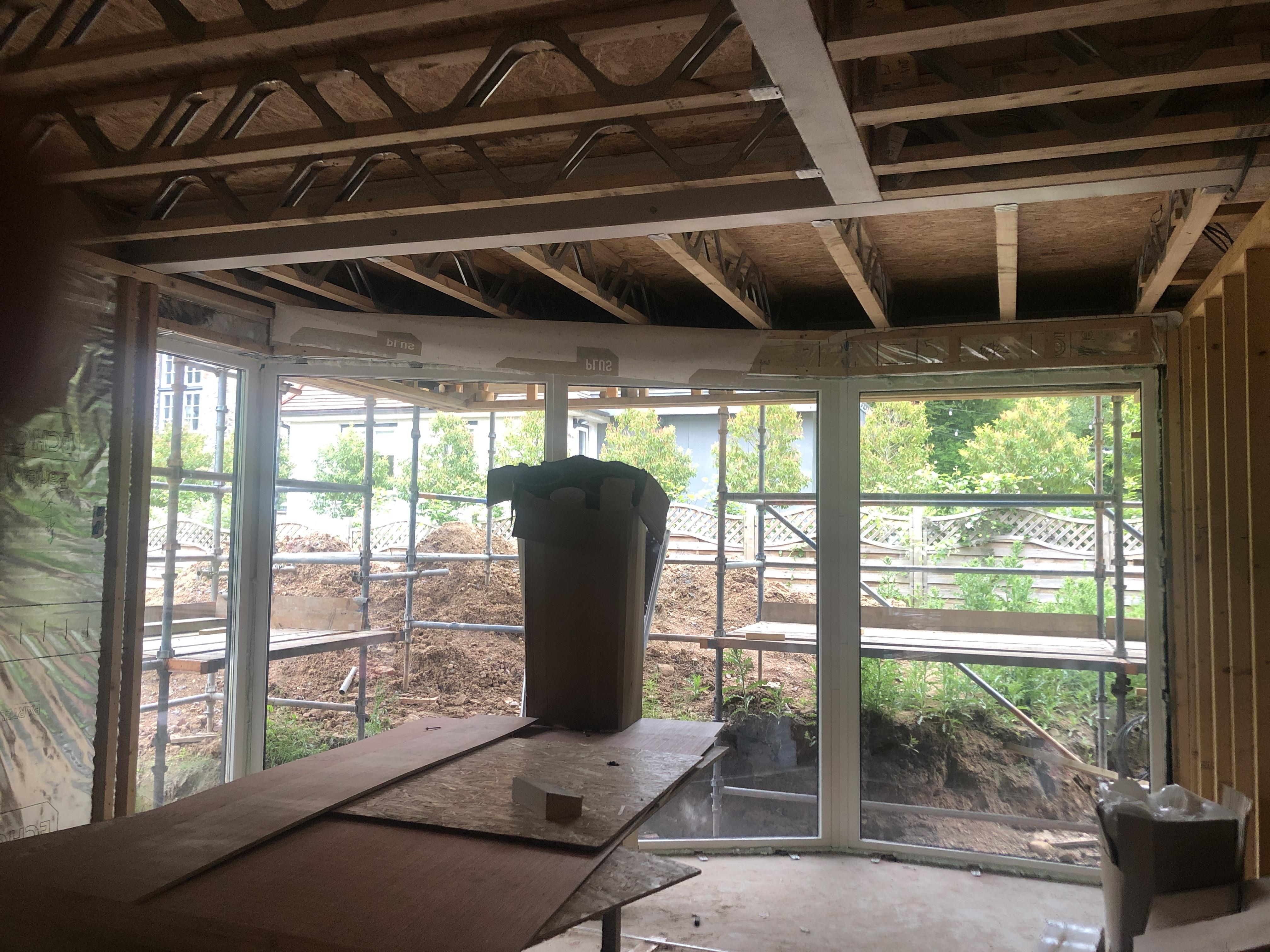

AliG Posted June 24, 2022 Share Posted June 24, 2022 I think these pictures say it all Builder said it just took a couple of hours and he needs a drink. Link to comment Share on other sites More sharing options...
Russell griffiths Posted June 24, 2022 Share Posted June 24, 2022 I personal thought everyone was overthinking this. 4 lads just picked mine up on suckers and walked them in, extremely heavy but nothing that they don’t do every day. 1 Link to comment Share on other sites More sharing options...
AliG Posted June 24, 2022 Share Posted June 24, 2022 I don’t think 4 guys can lift a 467kg window. Plus it is about 500mm above ground level at the moment. They did the other windows manually. 1 Link to comment Share on other sites More sharing options...
craig Posted June 24, 2022 Share Posted June 24, 2022 5 hours ago, Russell griffiths said: 4 lads just picked mine up on suckers and walked them in, If around 200/250KG they will but easier to put it on a dolly and roll it into position or use a telehandler externally. That’s “if” access inside is straight forward and or outside. Not only that, the amount of installers that have knackered backs as a result is immense. Safety first, even if they’re lifting things manually. 1 Link to comment Share on other sites More sharing options...
