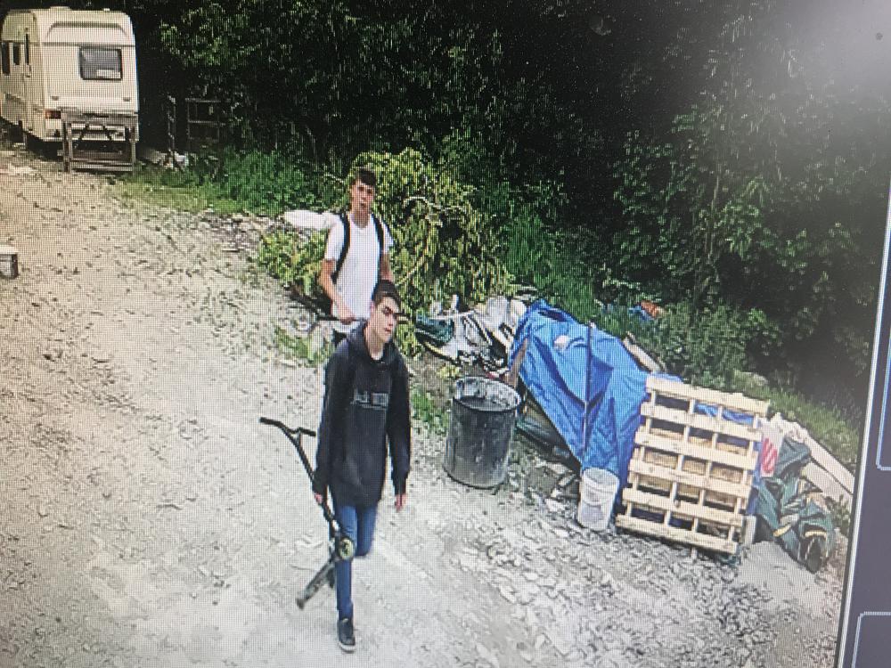

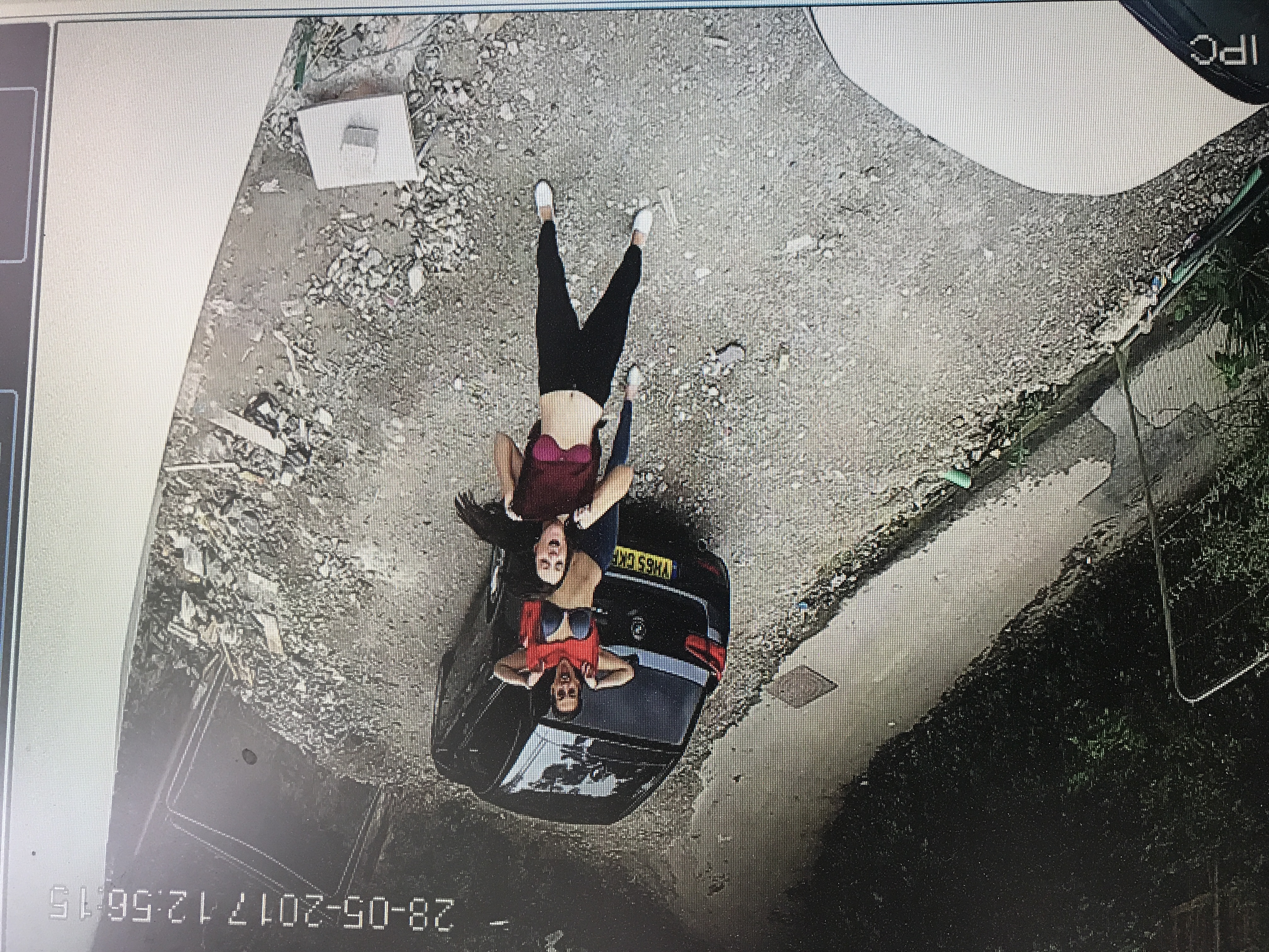

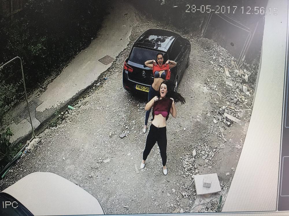

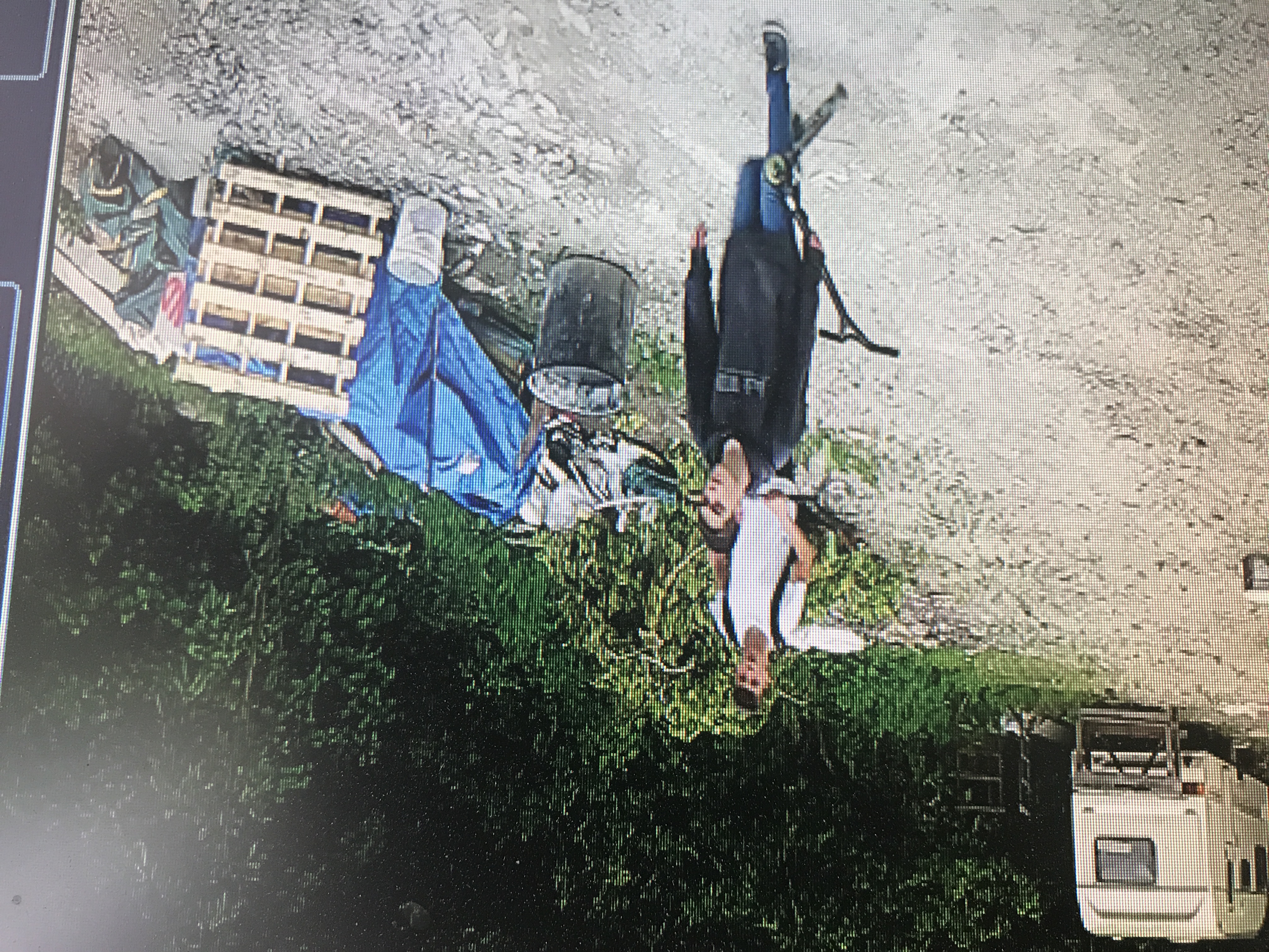

I bought this set -
[HD 1080P] ANNKE 4CH 1080P POE NVR Max Up to 5.0MP Security Camera Systems One 1TB HDD Included, with 4 x 1080P 2.1Megapixels HD Day/Night Vision IP67 https://www.amazon.co.uk/dp/B01H2RD9QU/ref=cm_sw_r_cp_apip_BTB3bXqxkWep2
Quite impressed so far but haven't really got in to the deeper settings to see what it can really do. After just 24 hours I had caught all sorts - the neighbour having a good snoop and pinching a empty dumpy bag, 2 little scallywags having a wander around, and 2 of my wife's friends flashing the cameras as they didn't think they were live hahaha
