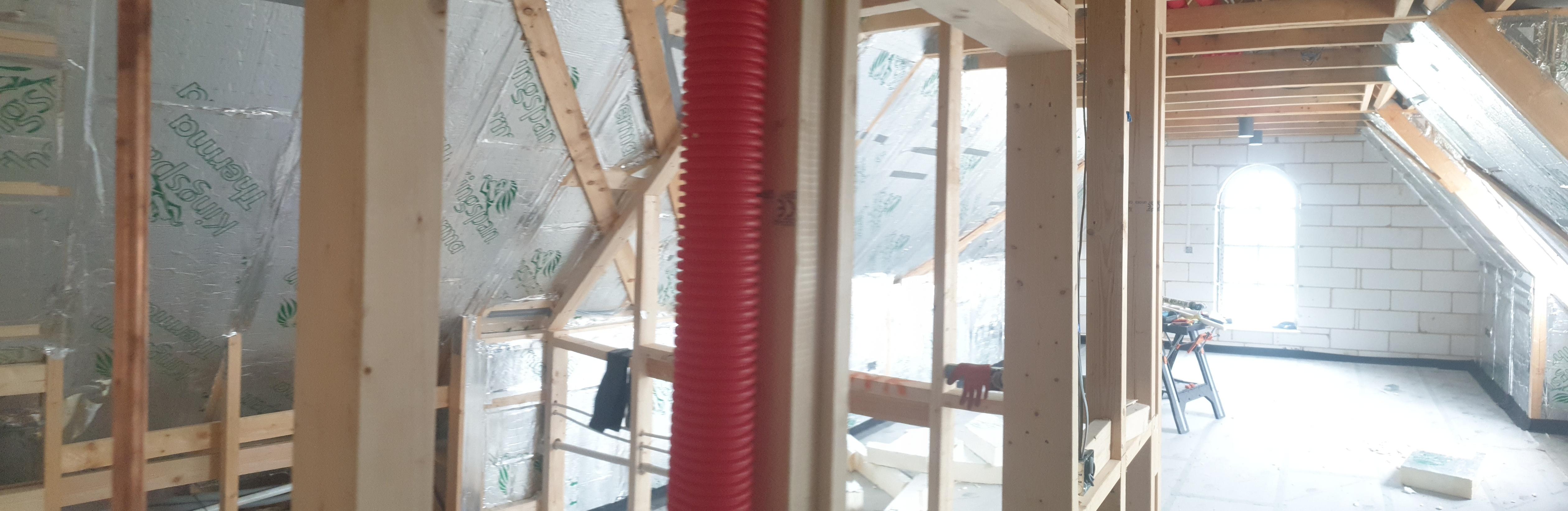

Evs Posted August 1, 2021 Share Posted August 1, 2021 (edited) Hi guys, I’m after some advice on what insulation to use in my roof. Its quite a ridiculous situation to be in but my local council have no building control offices in, all 4 of them are on the sick, 5 out of the 6 planning officers are also on the sick. I can’t get a building officer to come to site and they have turned all the phones off and we have to send emails which they will reply to when they can.. which as you can imagine is basically never and I can’t get hold of my architect as he’s away for a few weeks. I’ve got 8” trusses fixed at 400 centres and I have to allow a 50mm air gap and also lay a vapour barrier in the vaulted part of the roof. The U value has to be <0.15. It was recommended to use 100 or 120mm celotex insulation then use 37.5mm insulated plaster boards over that to achieve the u-value. I’d rather not have to use insulated plaster boards unless I have to as I’m trying to keep the cost down, as everyone else can probably relate the cost of materials is through the roof and we’re going over budget, so trying to find the cheapest alternatives where possible. Here’s the vaulted ceiling. Edited August 1, 2021 by Evs Link to comment Share on other sites More sharing options...

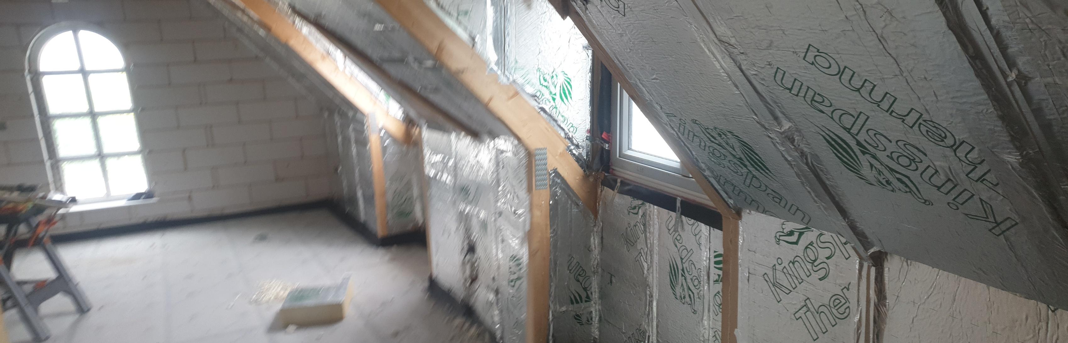

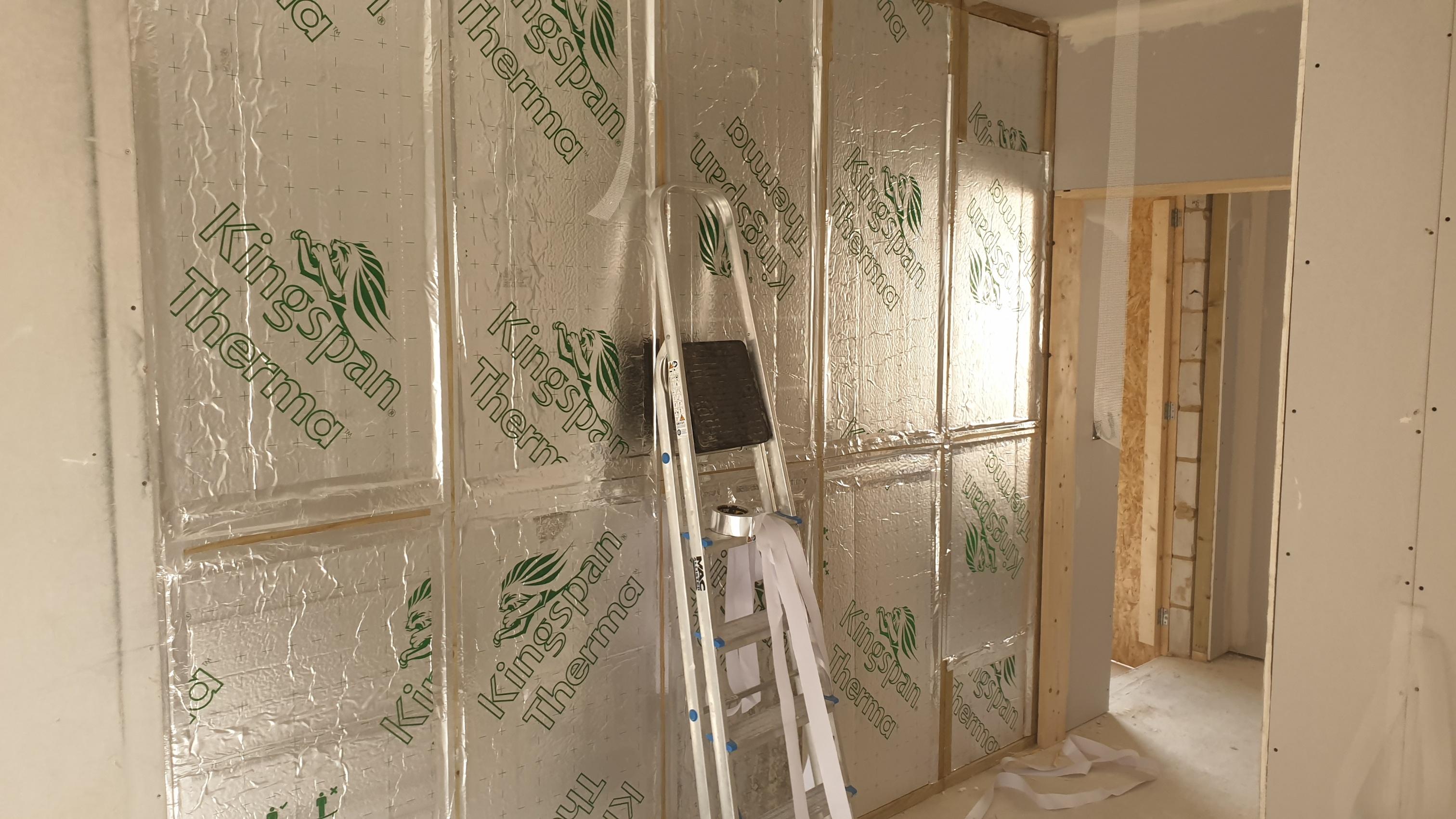

Faz Posted August 1, 2021 Share Posted August 1, 2021 I got away with 25mm insulated pb over 120mm kingspan on mine. You might want to have a look at gapotape - came across it just when I had nearly finished doing the room - will make the process a lot easier and quicker as the trusses will certainly have bowed slightly so none of the rips are true. Gapogroup ltd - Gapotape, Insulation (gaposhop.com) 2 Link to comment Share on other sites More sharing options...

Roundtuit Posted August 1, 2021 Share Posted August 1, 2021 Unless your tight for headroom, you can put celotex between joists and then 25 or 40mm celotex inside, over the joists, fixed with battens, then plasterboard is fixed to the batons. I had 150mm between joists, 40mm over the joists, 25mm batons and 15mm plasterboard to get to about 0.13 W/m2k I think. 2 Link to comment Share on other sites More sharing options...

Mr Punter Posted August 1, 2021 Share Posted August 1, 2021 If you use 120mm Celotex between the rafters you will need another 50mm under to get your 0.15 U-value. You can either hold these in place with a batten, which will double as a service void, or you can hold them in place temporarily with screws and big washers fix your plasterboard with long screws. Make sure you mark the rafter positions very carefully. Link to comment Share on other sites More sharing options...
AliG Posted August 1, 2021 Share Posted August 1, 2021 Cheapest combination is probably some kind of rockwool between the rafters and PIR below. If you used really cheap rockwool with 0.044 conductivity at 150mm between the rafters, this costs just £2 a square metre. Something like Knauf Earhwool 44. Then 100mm PIR under the rafters at £13ish a square meter then your insulation cost is around £15 a square metre. U-value looks to be between 0.13 and 0.14. It is around £10 more a square metre in materials to use PIR backed plasterboard, but there is less labour involved. However, you would struggle to get 0.15 with rockwool and PIR backed plasterboard. You would need better insulating rockwool which is much more expensive. To use PIR between the rafters and PIR backed plasterboard under the rafter would come in at about £30 a square metre - 120mm PIR plus 72.5mm plasterboard - I kicked off a couple of pounds for the saving on plasterboard. More insulation below the rafters tends to be more efficient as there is no bridging from the rafters, but you will lose some head height. 1 Link to comment Share on other sites More sharing options...
