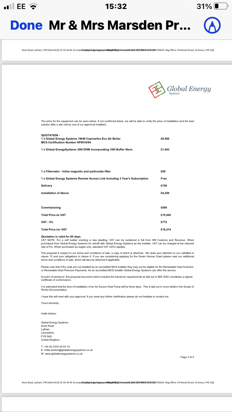

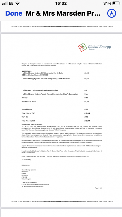

nod Posted July 23, 2021 Posted July 23, 2021 I needed to get some idea of sizing for our sap I didn’t really want a quote Though seems quite high They are a local company supplying what they say are UK made ASHPs Has anyone heard of this type of pump If so are they inferior to Mitsubishi or German made

Chanmenie Posted July 23, 2021 Posted July 23, 2021 Have a look at RED heat pumps they look pretty good Great looking design as designed from scratch and not just a revamped air on unit I think they might be expensive though 1
IanR Posted July 23, 2021 Posted July 23, 2021 (edited) Looks expensive to me. I paid £11K excl. in 2017 for a 12kW Nibe + Cooling module, with a 500l Nibe UVC, 200l buffer, Modbus module and controller, installed. Nibe seemed more expensive than most, but offered the cooling module, which few others did at the time. Edited July 23, 2021 by IanR 1
nod Posted July 23, 2021 Author Posted July 23, 2021 17 minutes ago, IanR said: Looks expensive to me. I paid £11K excl. in 2017 for a 12kW Nibe + Cooling module, with a 500l Nibe UVC, 200l buffer, Modbus module and controller, installed. Nibe seemed more expensive than most, but offered the cooling module, which few others did at the time. I’ve just asked that question regarding cooling He said no it would effect The efficiency with there unit and disqualify the RHI Does your cooling work in these temperatures ? Did it effect RHI?
IanR Posted July 23, 2021 Posted July 23, 2021 (edited) The cooling has no effect on the efficiency of the ASHP. Cooling wasn't initially allowed with RHI, but is now. It changed in 2017 I believe. Ref. https://www.ofgem.gov.uk/environmental-and-social-schemes/domestic-renewable-heat-incentive-domestic-rhi/applicants/eligible-heating-systems Yes, cooling is effective, but since mine is via the slab, is slow to react, ie. it will take 2-3 hours to lower the slab temp before the cooling effect is felt. I also have cooling available via MVHR, from the same buffer that supplies the UFH, but as I don't cool the buffer below 12°C, it's not that effective via MVHR. No effect on RHI - COP on ASHP and low flow temp is unchanged, so max RHI allowed on the Nibe I have (F2040-12) Edited July 23, 2021 by IanR
Moonshine Posted July 23, 2021 Posted July 23, 2021 (edited) That is a big ASHP and price tag, is it a big house? I have just had a quote back for 9kw R32 Monobloc (£2.1k) and 250 litre pre plumbed cylinder and 50 litre buffer for £4.5k supplied, and £1.5k for the under floor heating parts, at trade prices (No RHI scheme required or MCS20) Beats the £12k quote i got from another supplier just for supply. Now i need to find someone to install it! (any ideas how to track someone down?) Edited July 23, 2021 by Moonshine 1

LA3222 Posted July 23, 2021 Posted July 23, 2021 16k and 18kW, jeez that is a hell of a price tag and a huge heat pump. If you want to size your pump the easiest way is to use the heat loss calculator. You know this. You've been knocking around on this forum since day dot so all the discussions r.e. heat loss, ASHP sizing, cooling mode via the slab etc have all been covered at great length whilst you've been here. You're not new to self build either, so you know that RHI is crap if your house is built to a high spec. Surely you are building to a high spec so why bother with RHI? 1
