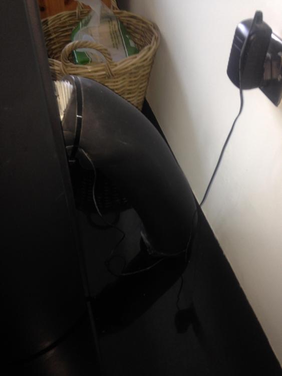

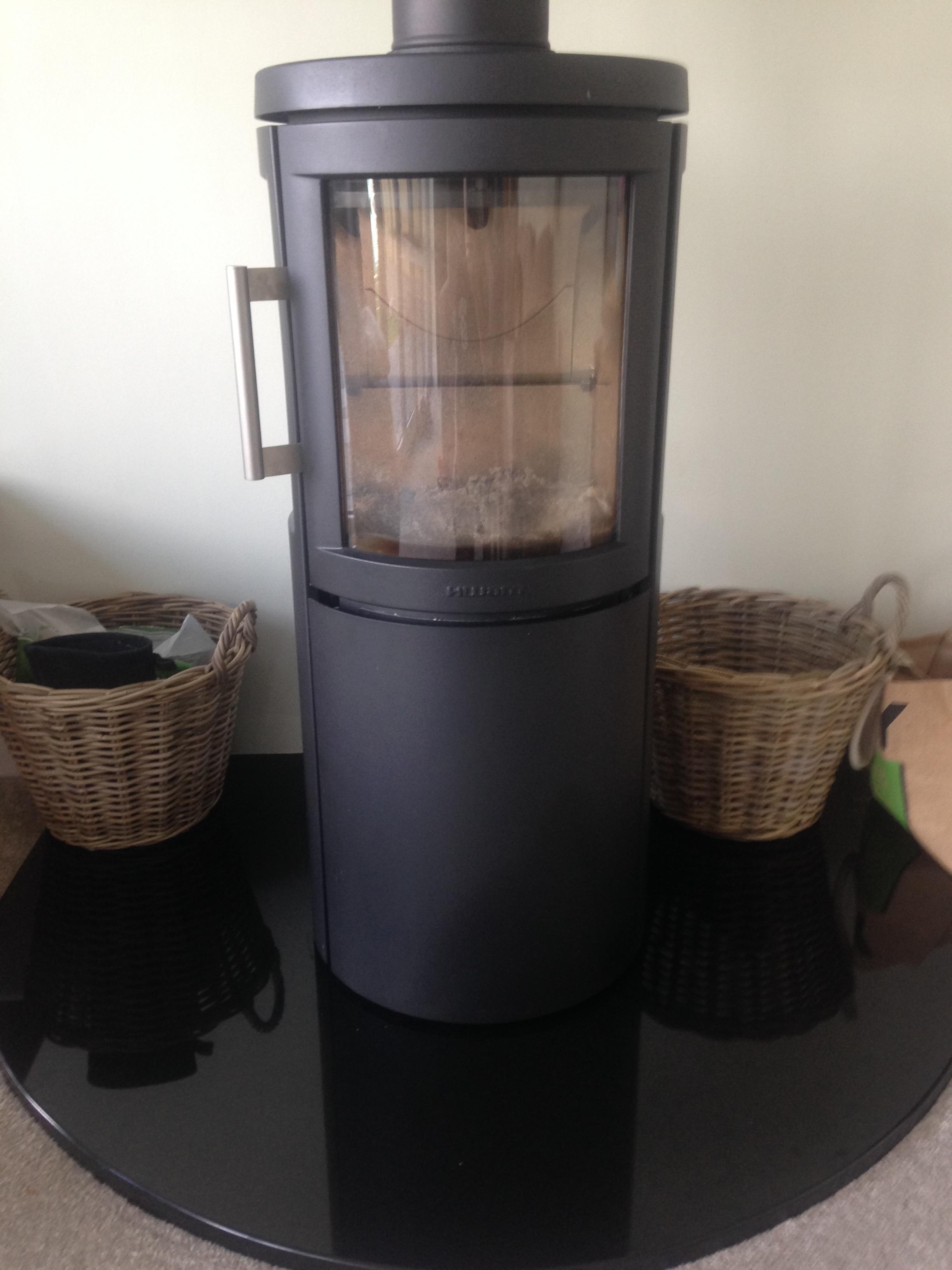

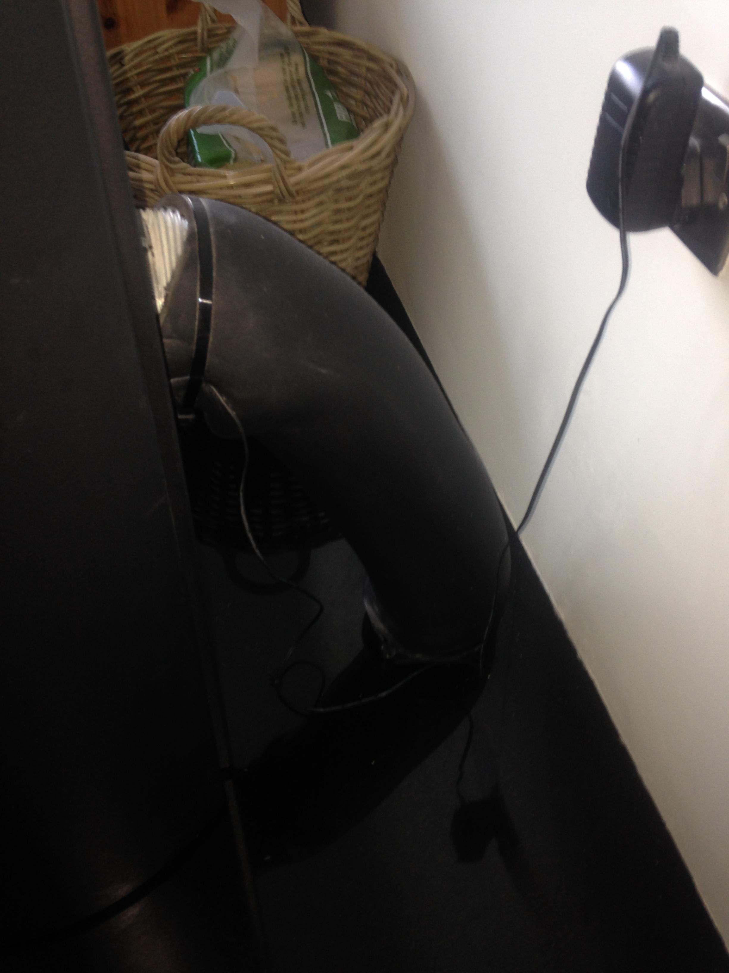

Mikey_1980 Posted March 16, 2017 Posted March 16, 2017 We have a duct running under our slab for our Hwam stove, we had the hearth made to measure with a hole in it for the air feed, we made all the decisions on the stove/hearth etc before the slab went down so its worth planning it as early as you can. I will post a picture later.

TerryE Posted March 18, 2017 Posted March 18, 2017 On 16/03/2017 at 19:20, Jimbouk said: Yes, I appreciate they are not environmentally sound and we run the risk of over heating, but we want one.... Expand That might be true for the range of stoves up to and including the one in @Mikey_1980's pic above (and fair disclosure we have a similar one albeit 15 year old technology in our current farmhouse). The problem is that physics is against you if you want to see a nice looking ember heart. For wood to break down all its nasty combustion products, then you need to get the exhaust gas stream up to around 1,000°C. At this point pretty much everything ends up as CO2 and H2O in gaseous form. You can do this by using closed technologies such as a rocket stove. In contrast look at the exposed radiant area in this picture and do the maths -- for a heart of say 0.1× 0.1 m2 radiating at 1,000°C. The radiant heat output is tremendous -- far hotter than an average BReg 2103 house can cope with, let alone a passive house. So you have to use a lot of wood and then let it burn at a far lower temperature -- so as a consequence to you get all of those nasty combustion products up the chimney. I've been thinking about this, and if I really had to heat the house with wood, then I'd use a rocket stove technology, with a short burn (say 1-2 hrs) with the exhaust gasses going through a cob or concrete thermal store. If you can get the exhaust gases cooling down well below 100°C, then you've got a condensing boiler and the efficiency of burning even damp wood goes up to nearer 100%. OK, you will need to fan assist, but that extra 60W of electricity will get the burn efficiency up from ~30% to ~90% so why not? And then thread one of the UFH loops through the same thermal store so that you can control the transfer of the stored heat into the the main UFH. Mind you, this wouldn't help to cool the house during the high summer ;-?
Trw144 Posted March 18, 2017 Posted March 18, 2017 (edited) On 18/03/2017 at 00:43, TerryE said: That might be true for the range of stoves up to and including the one in @Mikey_1980's pic above (and fair disclosure we have a similar one albeit 15 year old technology in our current farmhouse). Expand That one in @mikey_1980 s picture actually has a lambda sensor and flue temperature sensor built in. One of the biggest issues with woodburning stove efficiencies/emissions is the user - not knowing when it should be refilled and what air should be added and when. Mikeys stove takes control of all of this and will bleep at him when it is the correct time for reloading. This was all introduced as a result of environmental concerns and a lot of pressure/bad press on woodburning stoves in Denmark. Edited March 18, 2017 by Trw144
TerryE Posted March 18, 2017 Posted March 18, 2017 @Trw144, maybe I shouldn't post after drinking with my sons! However it uses sensors, the stove still has roughly a third of its firebox as a radiant panel. As I said, do the radiant heat calculations. It will be very hard to modulate the head output of a stove like this down without significantly dropping the heart temperature, and getting a lot of crud and particulates into the exhaust stream. You still lose at the latent heat of evaporation, so the efficiency will be terribly unless the wood has been air dried for 2 - 3 years. I agreed that this stove mightbe best in its class, but it is the use of this class that I am questioning: too dirty, too inefficient and too much heat output.
